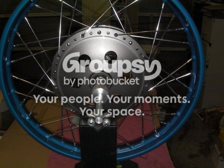

I wouldn't mind a good 360 myself, but I really have never seen a bike I didn't want. Been working on the shop today trying to get Slipstream's operation moved has been a pain in the ass but the added space is going to be worth it. I have a few pics of the wheels coming together and they turned out pretty good . I had to do a little work on the rims and then blast the chrome to give the primer a good surface to bond with and painted them with some blue I had left over from another job. Even with hardener in the paint it sucks trying to get the tires on painted rims , I know, I should go with powder coat but I am on a budget with this bike and building and painting the stuff myself don't cost anything but time. I cleaned up the casting flash and trued up the fins on the center of the hubs, drilled through and spot faced for SS button heads to pin the brake liners , not like I am going to be stopping that hard with this bike but it is what the factory Honda race bikes had done back in the day and it give the hub a nice touch. Drilled some air vents on the front hub and will either cover with some cool air scoops like I saw on an AJS factory race bike at Barber's museum or some SS screen.

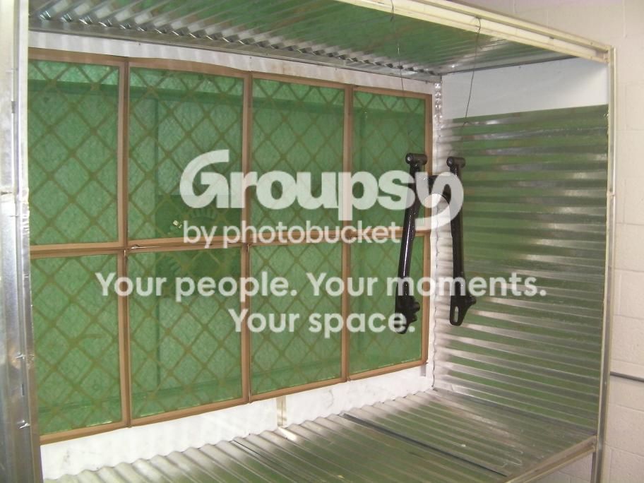

It been several days since we got to work on the bike but maybe we will be able to spend the weekend on it, I have the frame blasted and hope to try out the new paint booth and see how it works, we are supposed to get 4 inches of rain tonight and in the past that would mean no painting for a day or so. If you like to ride yr. round Arkansas is not the place to be, single digits and ice last week, 75 and tornado's this weekend. Seat pictured on frame is not the one we will use but I do like that style on the 350 and it has a recess for the light in back, may look at one of these in carbon fibre and see.
