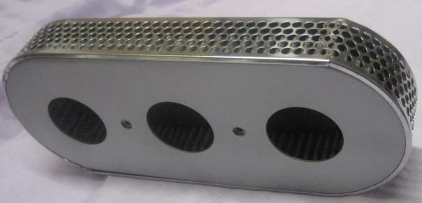

I've been thinking along the same lines but with a t150 filter
With the middle hole blocked

Future state I would like to try that collector air filter. That T150 idea is sweet
Re: "Patina" The 1973 CB175 Cafe Racer
If I actually do it I'll let you know if it works
