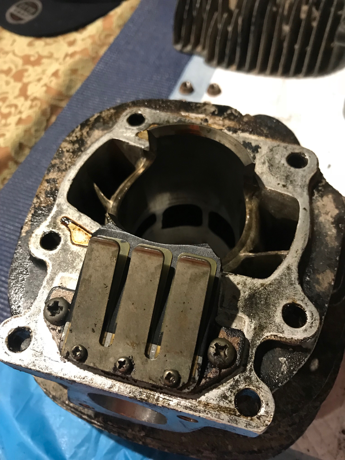

When I was working at Suzuki dealers we used to re-profile the reed stops to a (I think, can't remember) 8" or 10" diameter and about 50% more 'lift'.(just about touching case radius) o need to polish contact area with at least 600 grit afterwards. Make sure angle of port and reed block all match up. PE175 was first bike I ever managed a 'tail whip' on, my Yamaha 400 was way too heavy to learn on (plus I broke rear suspension trying ;D ) I don't like thinking about it too much though, makes me feel real old (almost 40 yrs ago :( )

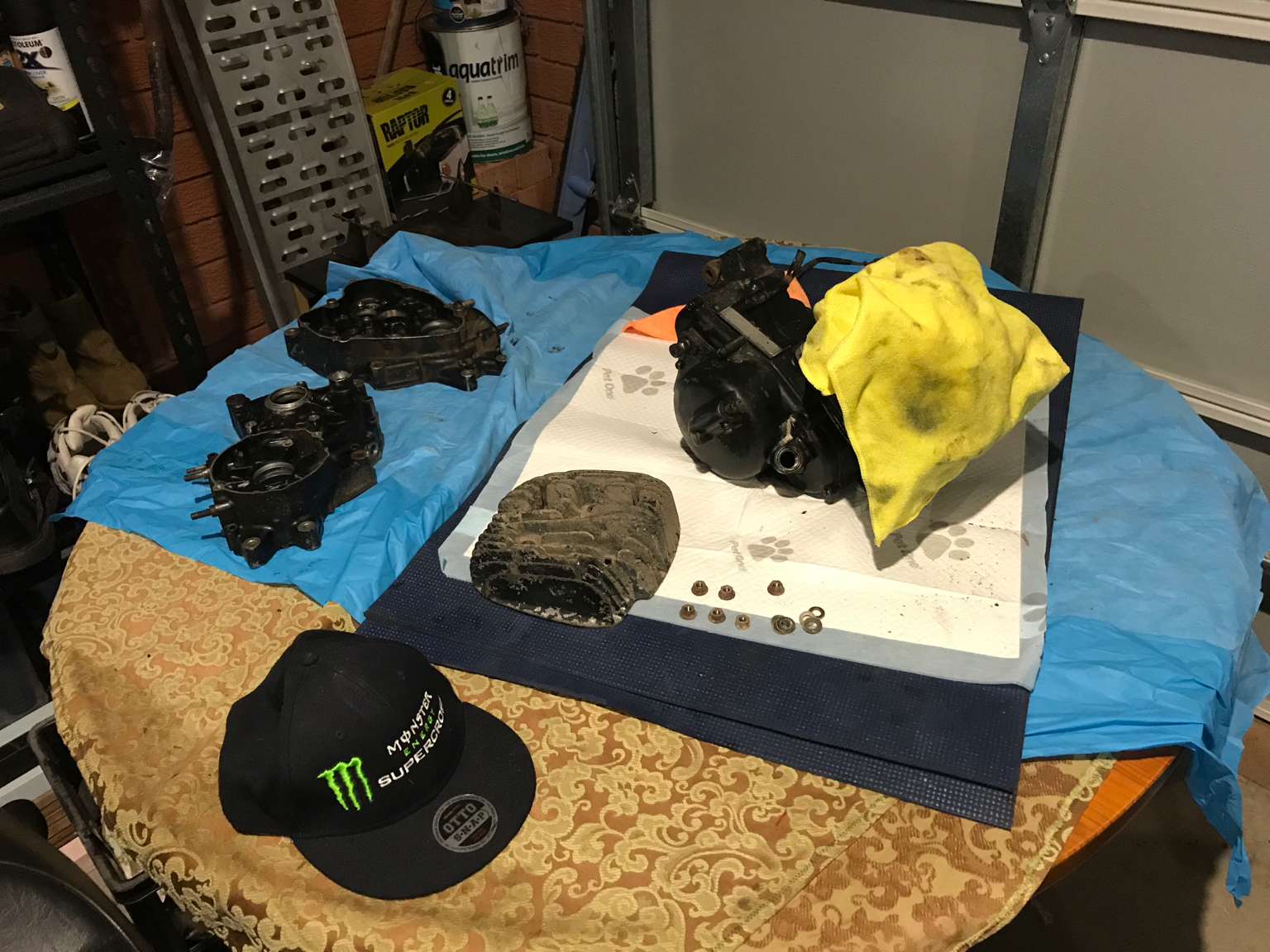

Engine is been rebuilt and is at the painters. Forgot to take pics sorry. Found the only 79 63.5 oversize piston in the world apparently and we are back in business. Also bought my baby a new heart.

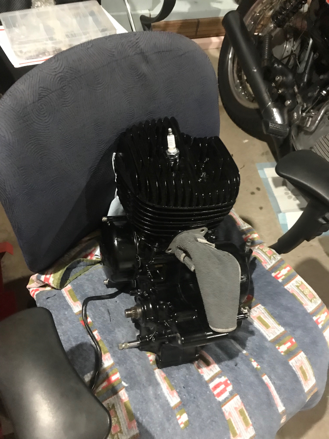

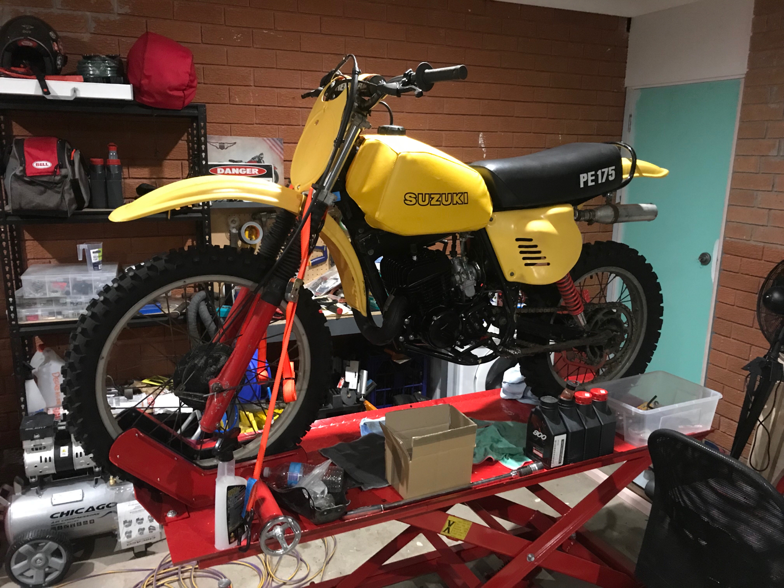

So a bit done. Engine back together painted and in. Bike re assembled and running. Now off to get tuned.

So after taking her out for a test run she revved out in first gear and hit ban. But then second third it feels like it is under load and not reving out. Any help?
I think I mentioned a while ago, re-curve reed stops to get more lift and open up slots in block if needed. RM125 reed block is probably fitted, probably easier to get hold of. Reed stops are probably in the 8-10 mm lift range? Almost certain RM 250 fits but it's just too long ago for me to remember. I may not have worked on one since about 1981~82? When you get reed stops off check for match with cylinder base and re-profile for a smooth transition (didn't you already do that?)
Ok that makes a bit more sense. I think I’ll look at a stock replacement then. No I got the 175 reeds saw they where different so left the original ones on.
