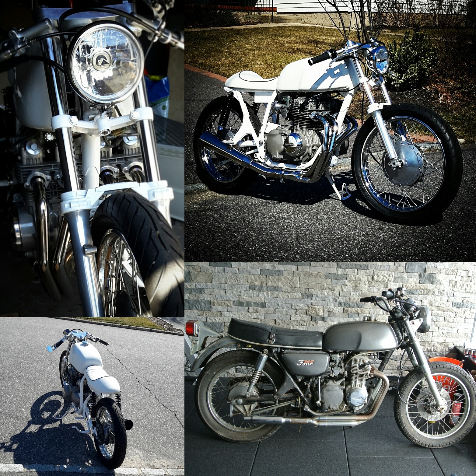

Thought I would throw one more into the mix. A '75 CB400F. 13K original miles. Minor lay downs on both sides. Scratched, road rashed, and dented, but in nice shape overall.
Complete tune and service, carbs rebuilt. New brakes, tires, suspension, chain, mini turn signals, modified '75 Ducati 750SS tail section with leather seat, '82 Honda Hawk front fender. Complete tear down and repaint of frame and body parts. Runs and rides as good as new.
2000 CB 250 Cafe ;D

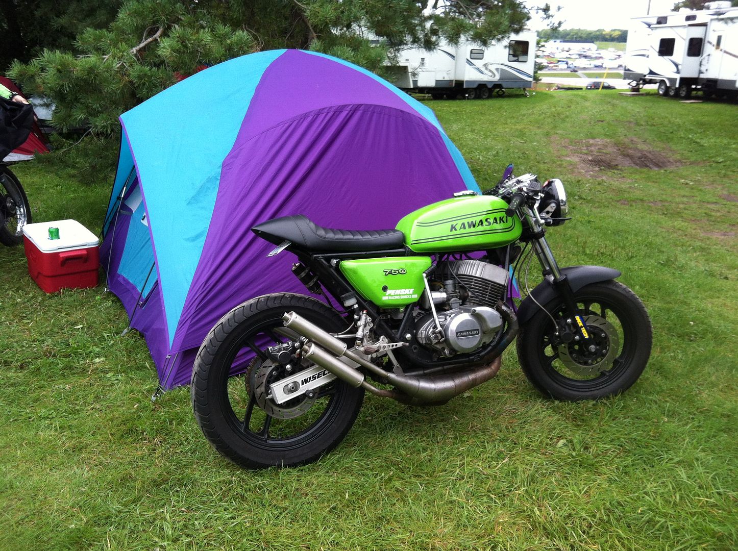

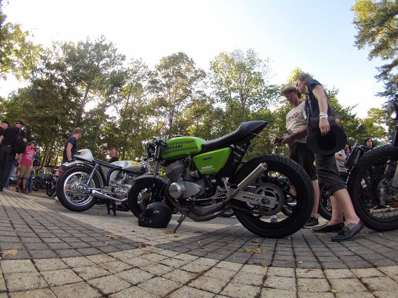

Drewski said:
I've been arond this site for quite awhile but I never got around to posting on this thread, so...
My H2 Before:
After:
Back to the drawing board:
Some long over-due updates.
Got we the Mongrel done. Well, done for a little while anyway! :D
Barber:
At play:
On the road:
On the track:
Now, we're dedicating the Mongrel to become a trackbike. Some ideas:
And now, you're up-to-date. :D

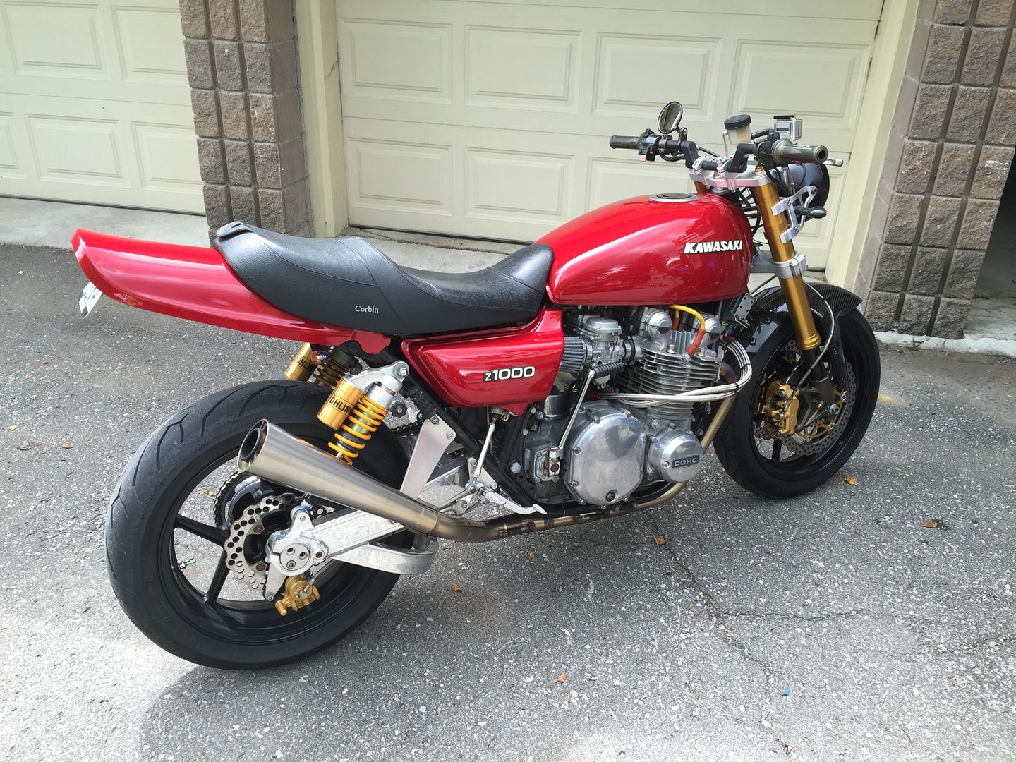

Drewski said:
I've been around this site for quite awhile but I never got around to posting on this thread, so...
My KZ1000 before:
After 22 years:
The KZ is done for the forseeable future! ::)
Oh ya... done... anybody else said that before? :D
Here's a couple more small updates:
Nothin' huge. Just the new pipe, paint, carbon fibre fender and BS34 carbs that still need some sorting out. :D
the new pipe is the icing on the cake. everything about this bike is topshelf, nice work! do you have a photo of just your headlight/ instrument cluster? those headlight ears are crazy.
Drewski... You already know I love that KZ, I plan to start on mine and if you are willing to share the swing arm specs, I would be very grateful.

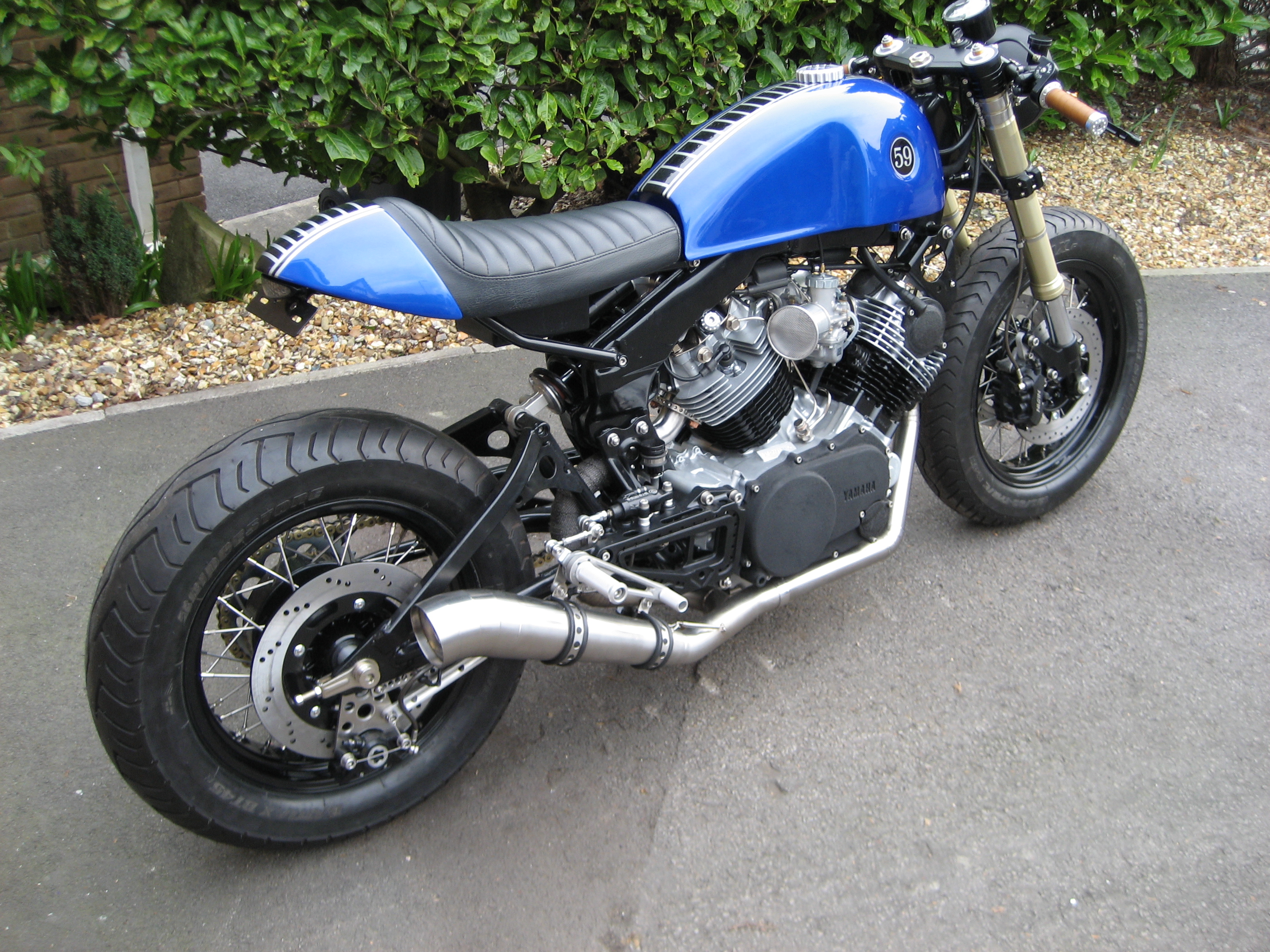

My before and after...........
Before: 1984 Yamaha TR1, basket case rescued from its last trip to the scrapyard.
After: Reborn as the "Spirit of 59".....
