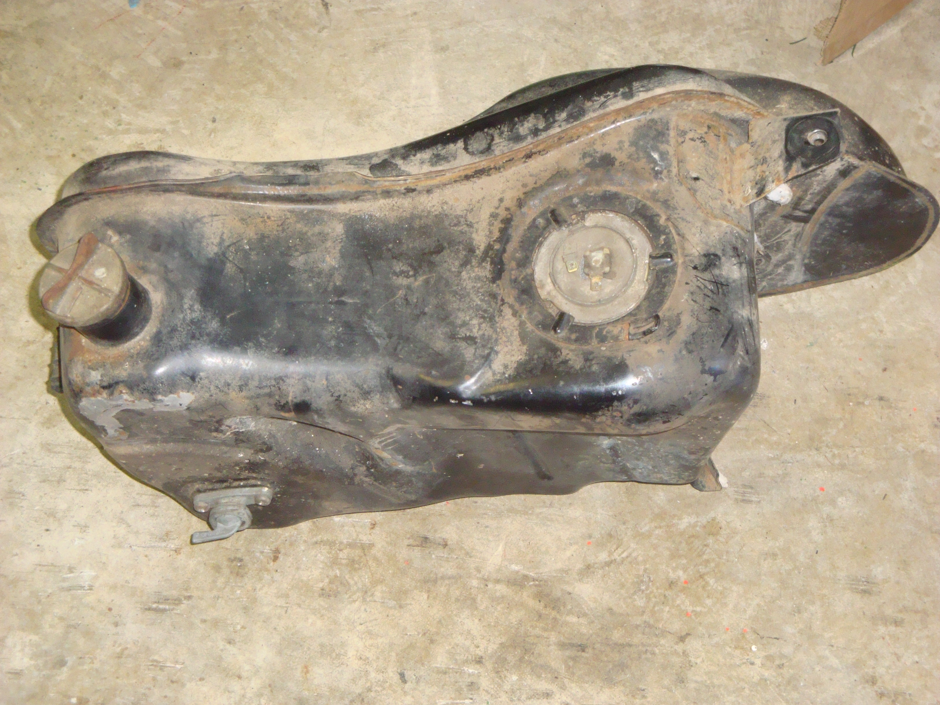

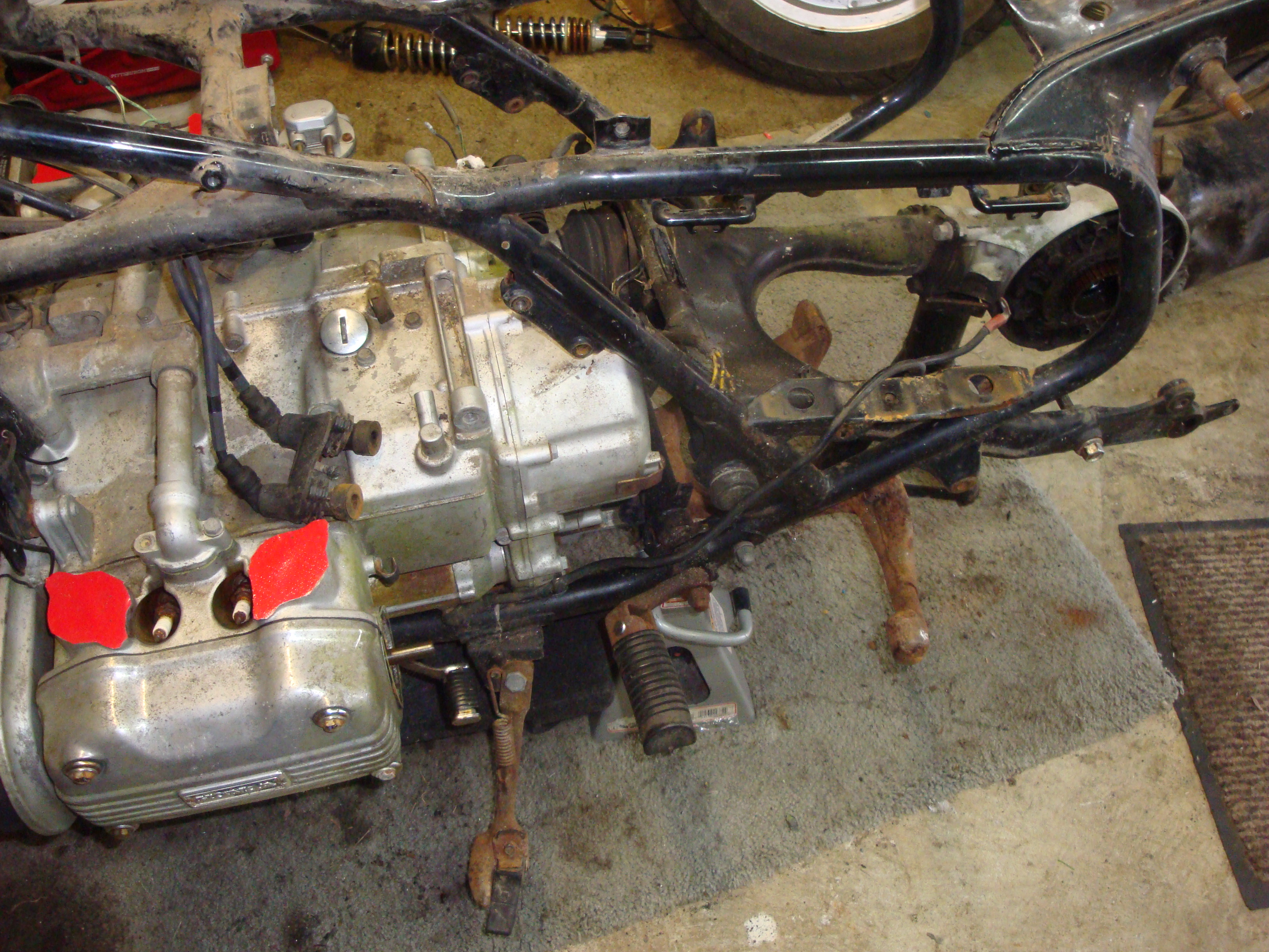

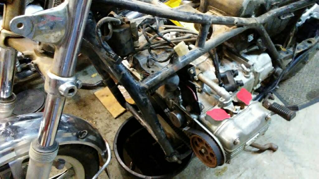

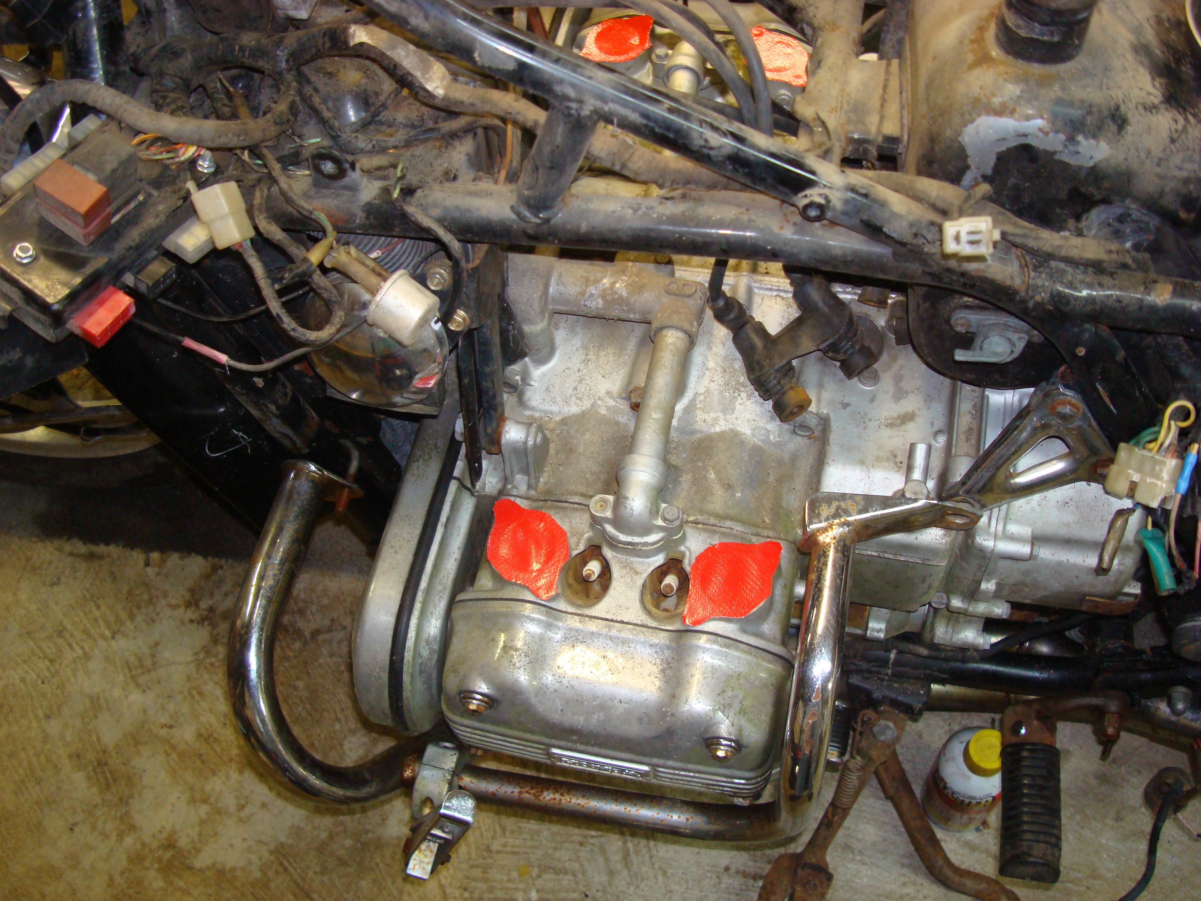

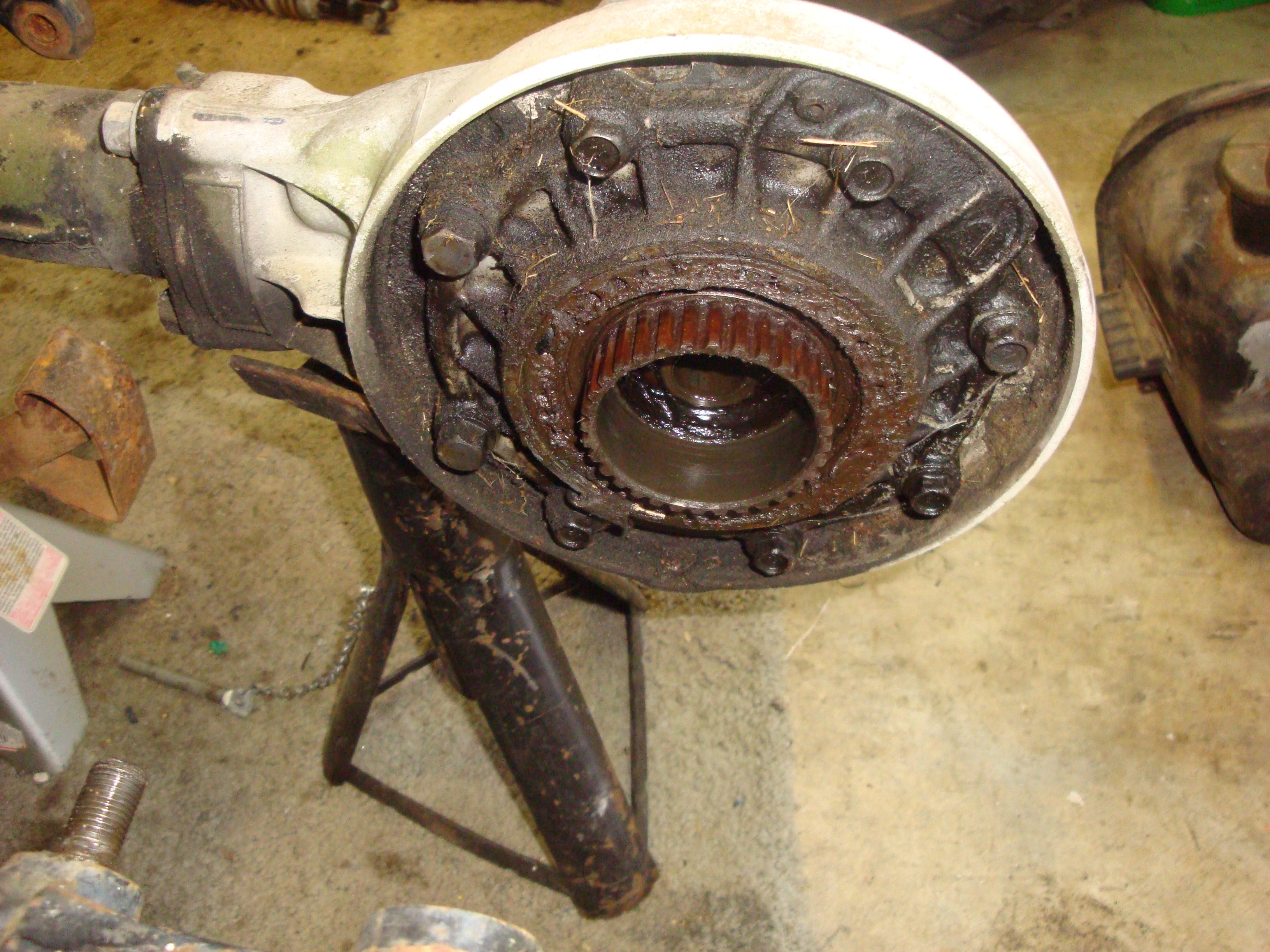

Started stripping her down today. Looks like the center stand mount will need rewelded when I get it stripped down. It goes over so far that the foot lever part hits the floor and causes the bike to lean to the right. Discovered an electronic ignition module in it. Turns out it is a Prestolite module. Will probably be pulling this down to the frame and repainting that as there is surface rust where things like crash bars were added. Bottom of the frame looks good, though. Front brakes off. Controls stripped. Intake manifolds unbolted. Noticed a broken off water manifold bolt, but that's pretty common. Penetrant soaking the crash bar U bolts overnight. A quick look in the tank shows minimal rust on first glance. Removed the speedometer cluster and key switch as the guy had lost the key (along with the key to his CB900 Custom) and this one has obviously been operated on. Ordered a replacement switch already. I'll re-key the shelter lock to match. Electrical interface box disconnected, unmounted, and a couple nuts located to hold it together.
Tomorrow I'll take the title down to the courthouse and get it transferred. Then on to stripping more down. I'd like to keep it on wheels until I can get it outside and pump the remaining gas out of the tank, then roll a dolly under the engine, take both wheels and the front end off before pulling the tank out. After removing the rack, I'll leave the engine strapped to the dolly and unbolt the frame from it and pull it off of the engine - probably pulling the swing arm/rear drive off to make it easier.
