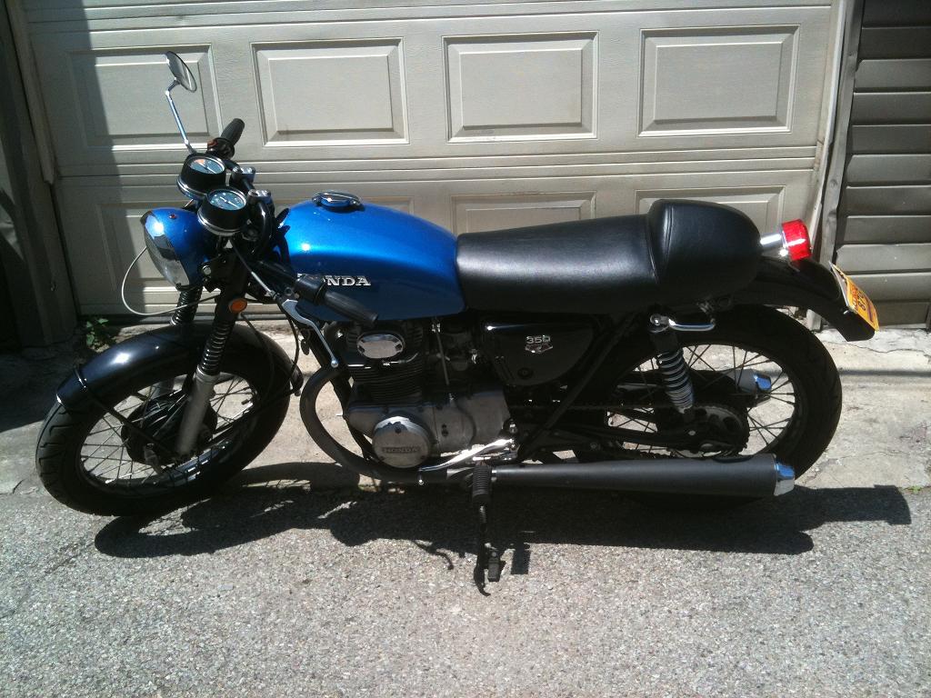

New update, she's done. Little odds and ends will come later, but I'm riding her and loving every moment!

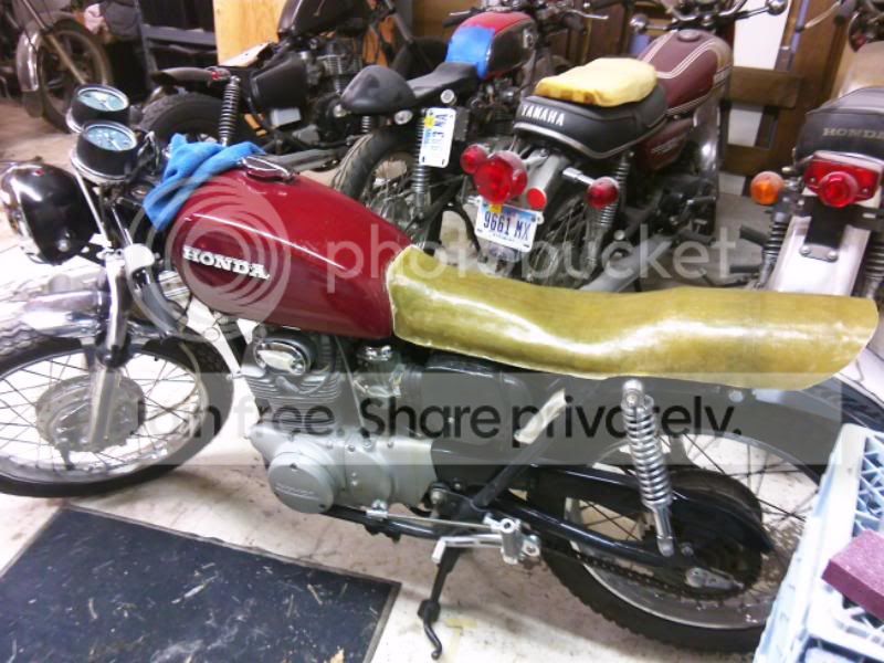

Started work on the basic shape for the seat. I wanted to go for a tracker sort of look for the rear seat, and have the ability to ride two-up without going flat on the seat.
I have rearsets installed, so I wanted to have a little height for the passenger section. (pegs for the passenger will be an adventure when I get to that point)
Re: Project Variant: PjkF's first cl350 build
New update 1/7/12

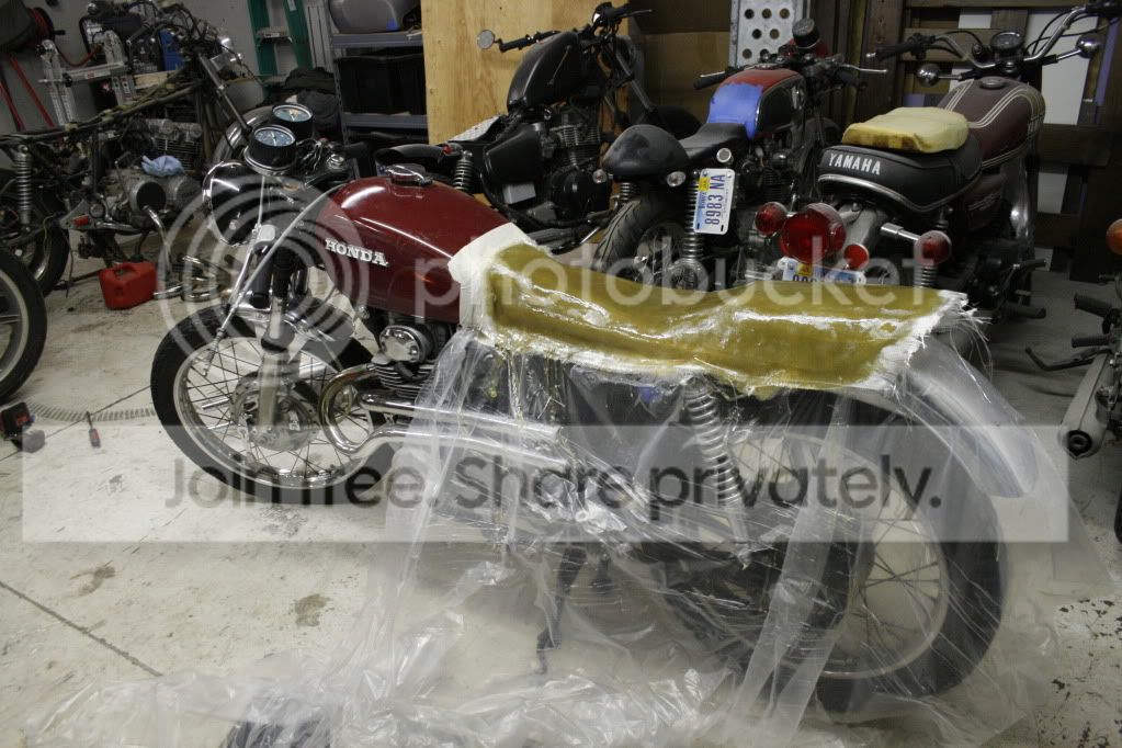

The seat has been fiberglassed, what a fun project. Messier than all get out.
This is setup for running two-up. I just need to figure out padding.

I gleaned a bit of information from these two sites. They were a good help in setting a base and taking it step by step. I used a more uniform (also a bit more flexible) weave fiberglass for a base and a topper and used the chop (stringy) fiberglass for the layers in between.
Really make sure that you mix the resin correctly, too much hardener and you will not have enough time to lay all your layers down before it starts to set! I learned that the hard way.

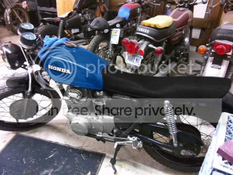

And here's a quick little photoshop of what I am thinking as far as the color scheme I am going for:
Ooh. I like that blue. Definitely a winner on that one. No pin-striping or anything? Black rims looks good as well. How'd you do that mock up in Photoshop? Before I read the caption I thought you had actually painted the bike!

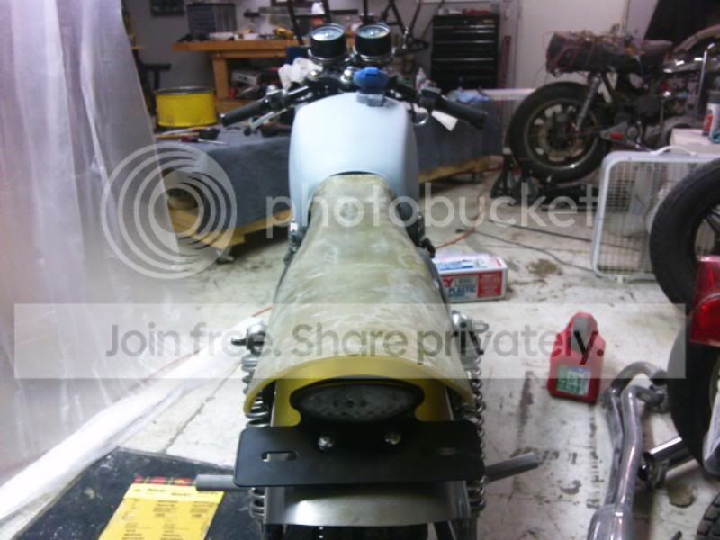

I bought an LED tail light from a Chinese dealer on Ebay and I was impressed with the quality.
I test fitted it and it uses the same mounting holes in the fender as the OEM tail light.
It also tucked right under the seat really well.

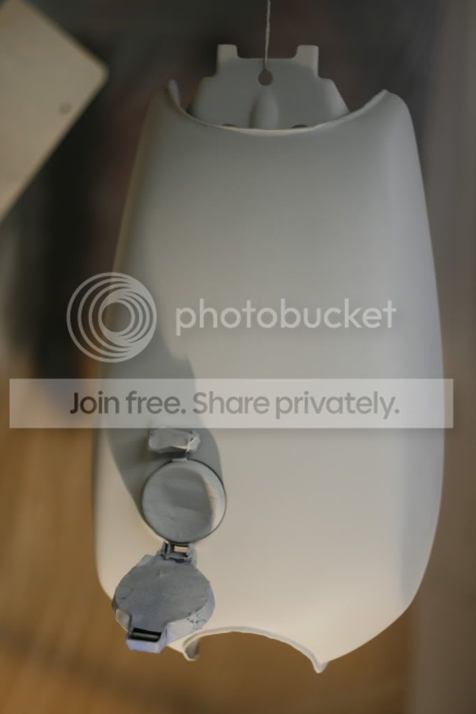

I primed the tank after filling in the sides where the logo had been.
Finished up on the fenders. (Rubber undercoat actually comes out looking pretty sweet.)
Threw some paint on the tank.
And mocked up how it would look on the bike
