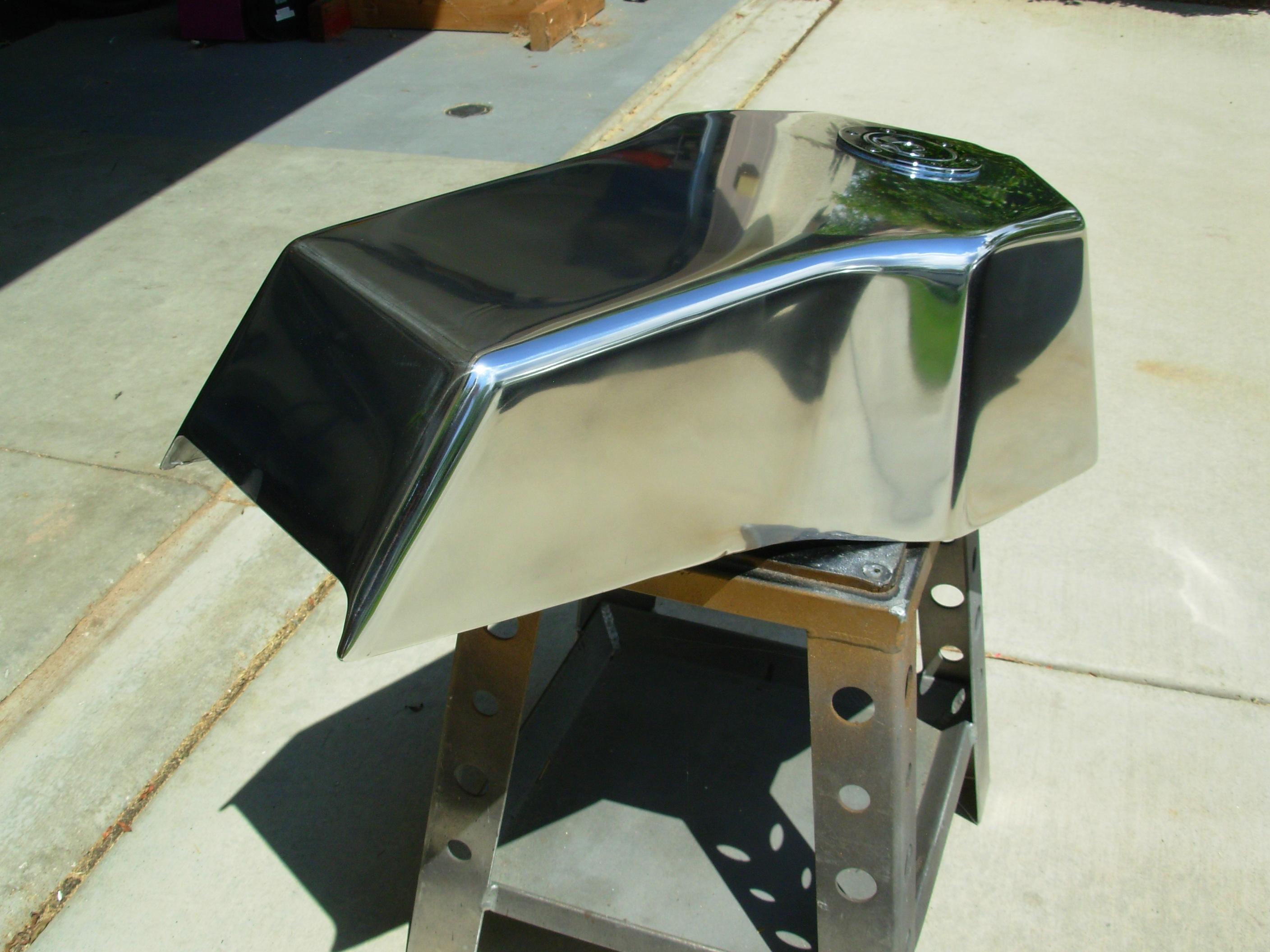

Got the polishing figured out!

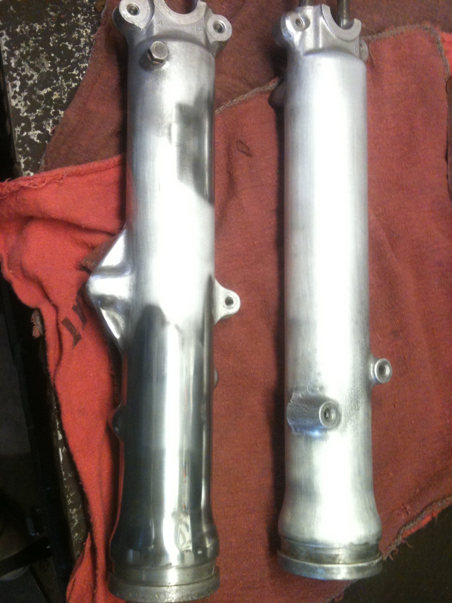

This is my first attempt at polishing forks. I wasn't going for the mirror finish so I'm pleased with the result.
If I did it again, I would sand with higher grit before using the wheels.
