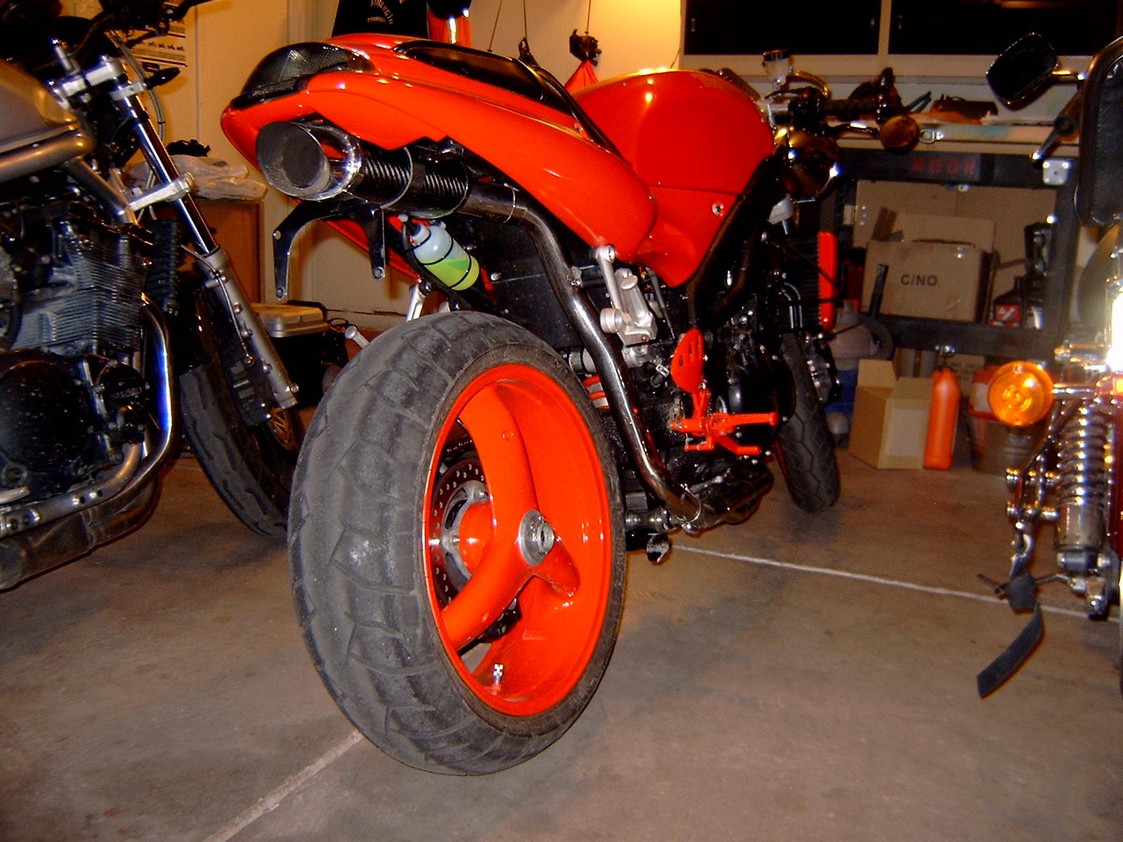

New front end (06 GSXR forks/calipers, 07 GSXR 750 lower triple, 05 GSXR 1000 RSD top triple, 08 GSXR 1000 rim/rotors)
Brit & No Oil Slick!! ;D ;D ;D
Yet-That Is!!!
Still got to paint the other tank-got some black graphics for it!!
Howls like a Triple from Hell with the Southbay Underseat on it-getting WAY too many tickets :o
More photos when i can get the paint done-CHEERS ALL!!!

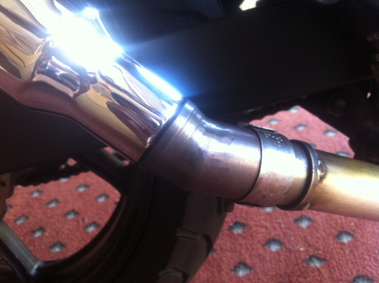

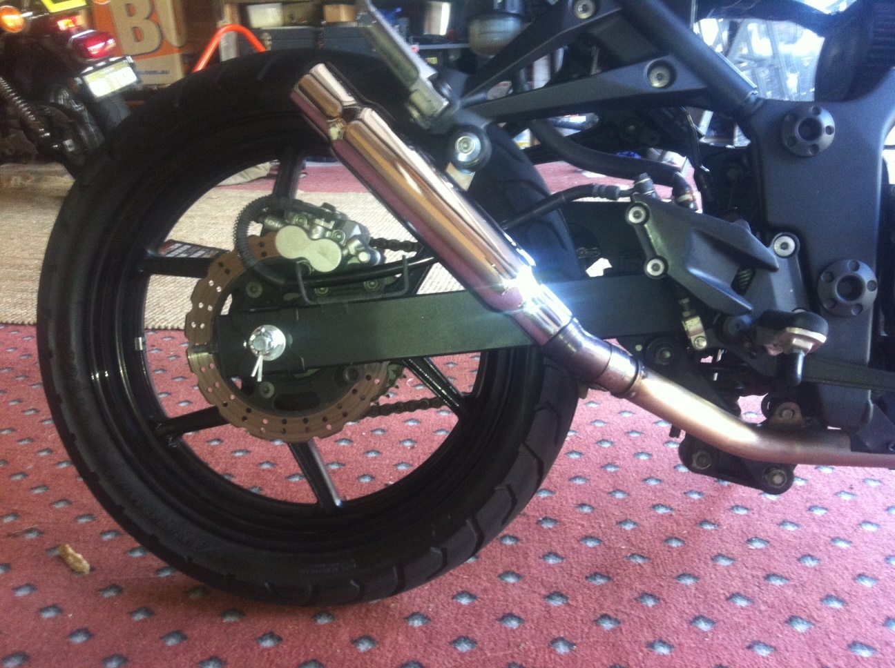

So here's a photo of my ninja 250 fighter. It's a work in progress but I'm pretty happy with how it's coming along. Still have to finish up the seat cowl and upholster the seat.
What do you guys think?

Cheers man, still need to take off the fairing mounting tabs on the tank as well.
Yep stock headers. The new gen ninjas have a 2 into 1 headers. The reason the exhaust loos good though is my old man works for an engineering/hydraulic company. He got the guys there to make up an elbow to attach the muffler as it has a different diameter to the headers. I think the angle was like 25degrees from memory. It looks much better this way.
