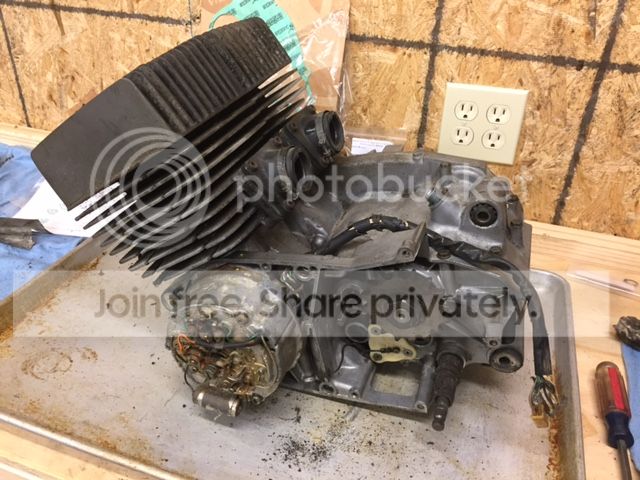

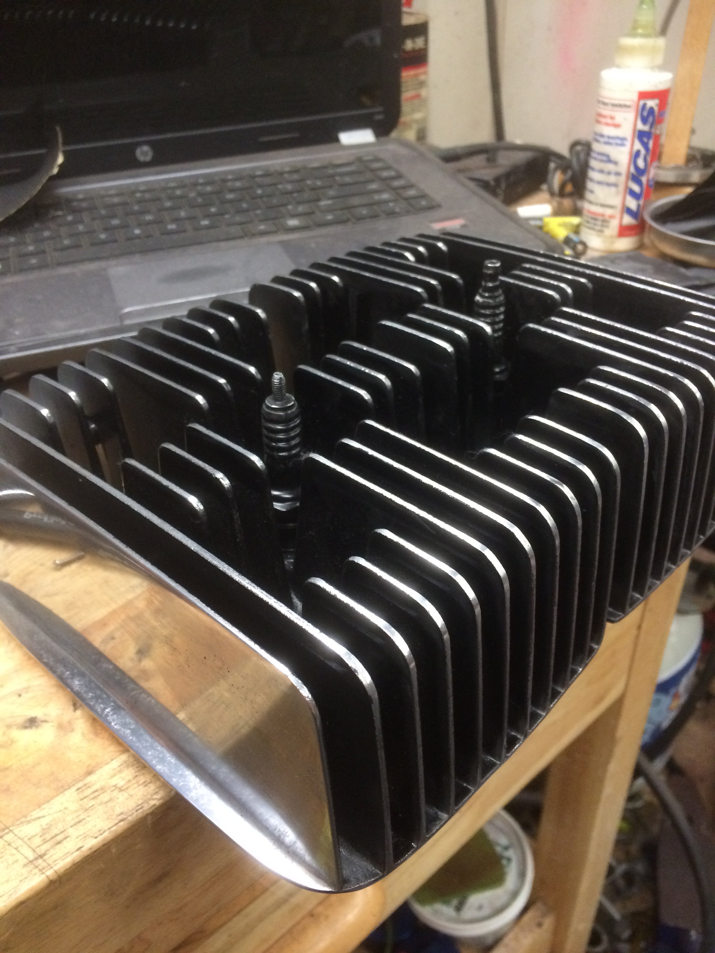

Just rebuilt the topend
Had the heads vapor blasted and milled. Pushed the cc to 400 with a little aggressive port timing. Think I may be a jet or 2 lean in the main tho. I'll play with that once the weather breaks. Need to rebuild the oil pump still, get new rear shocks, and a new seat.
