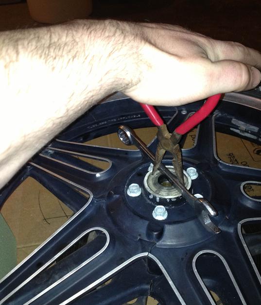

retainer was a piece of cake! bearings look like they've been replaced before, no punch marks in the retainer. seals were fused and nasty,
need to get a bearing puller or an anchor, tried moving the spacer to the side but can only get a mm or 2 clearance.
gonna grab that tonight.
broke my c-clamp trying to release the bead on the tire as well. thought about driving the car over the rubber but the wife halted that idea.

Don't buy anything else. I did this job myself and I'm a total idiot!
That little guiding tube in there is floating in the same area as the bearing occupies and will move when you force your way in. Each of the bearings can be knocked out with a hammer and a long drift/punch. I tapped the new ones in using a 1x1 wood block, using its corners mostly.
