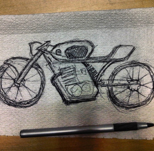

Please don't start building CB650's.
I've got a cb400f but I'll be looking for another CB for a cafe build after this project. This is what I was shooting for for that.

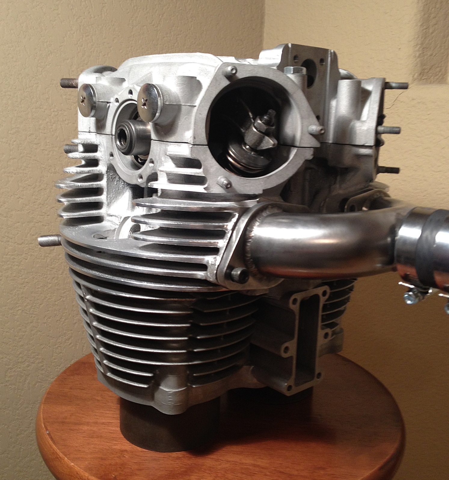

Started on the top end. Starting with a 700cc hoos big bore. The fins on the heads were shaped to match the Jugs. Got this idea from Daniel from Pandemonium Choppers. Top motor mounts also chopped to give me that extra clearance for the tank. Also have the CounterBalance 2 into 1 intake mounted. Awesome craftsmanship. I went with the center mounted carb as I got plenty of clearance with my frame.

Love the shaped fins - just lots of careful grinding and filing? Any pics of the process?
I want to run a single carb on my xs but I have no idea where to go with carb size
Yeah basically, grinder and drill with burrs and rotary files. The jug was used as a guide. Unfortunately I didn't take any pics of the process but 'm actually not finished cleaning it up so I'll take some more pictures.
