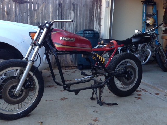

Some pics of where it is now, I got the seat pan made and need to cover it in leather, it is shaping up to have great lines!

I'm not feeling that shorty seat, but the monoshock and cleaned up frame have a lot of potential. Maybe it's the tank that looks a little awkward where it sits beside the down tubes.
I'd keep looking for the right shape of tank and then raise the lower leg of the rear subframe for a more modern look. I don't think it would work with a pure MotoGP copy but that sort of rear end might make it look more balanced and complete at the rear end.
If you photoshop say an M1 Rossi rear end on, how does that start to work? It would be a different concept but with modern wheels and forks might look really sharp if you can make the different style elements work together.
That would make it a MotoWing or GoldRacer or some such thing :-)
Unless you have hollowed out that Kawa tank to use it only as a shell, you are going to need to find a new home for a lot of stuff that was hidden under the stock faux tank. from the looks of the monoshock, you aren't going to use the factory tank any more.... maybe Weber side drafts are in your future?

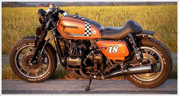

I quite like the gneral idea of the photoshoped seat. My personal favorite cafe Wing is the one on the photo, which I attach for reference. Details here: http://www.pipeburn.com/home/2012/1/20/78-honda-goldwing-cafe-racer-vyper.html
I'd agree though that the tank looks a little... wrong where it sits now. It seems it should be tilted forward a little. It could be modified from underneath or a more... user-friendly one could be sourced. The one off the CB750 or, even better, the CBX1050 comes to mind as those frames have a similar design in the tank area. I doubt any tank will be particularly easy to fit though.

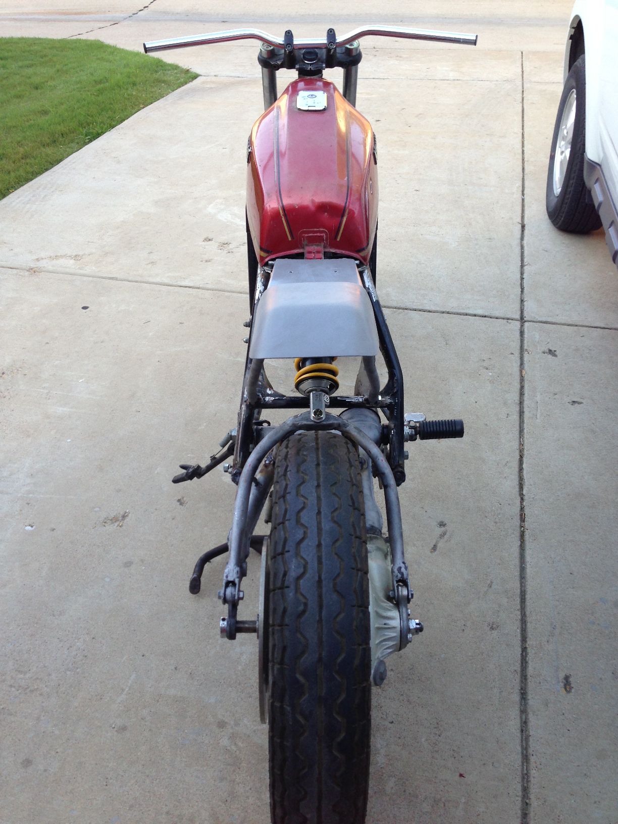

Some pics of the actual seat pan in place now. Just need to get it covered at the upholsterer. I like the look of it so far.
Troybilt- Thanks for the kind words and yes I am using a real tank instead of the false one. It will be easy to plumb.

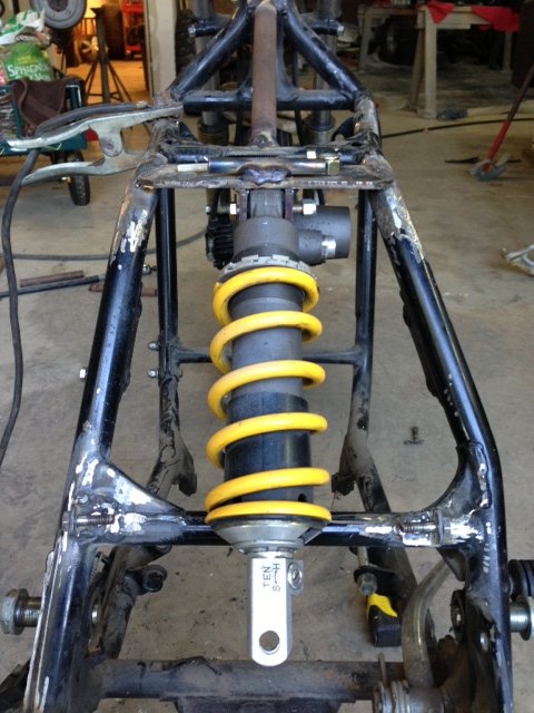

Got the swingarm all fab'd up for the monoshock. That is all done now and just needs final grinding before powder coating.
Got the tube in that will support the tank as well. Ground off all tabs and welded on supports where needed. Also finshed the rear subframe and sand blasted that along with the swingarm so thats ready for powder as well. Hoping tho make some good headway on the project now that all the metal fab work is done.
