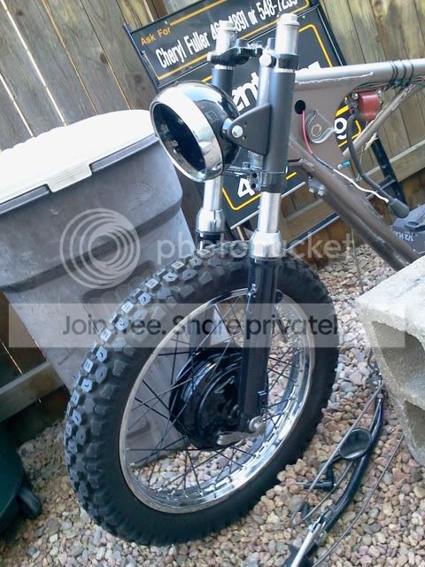

Used the good ol' appliance epoxy to paint the spokes and hubs, and cleaned up the hoops.
Also did the lower fork legs and triple clamps with the same paint.
Picked up a real headlamp bucket from the salvage yard, and ripped the whole bike back to bare frame.
Cleaned up the motor and used VHT wrinkle finish on the case and high temp flat black on the cylinder and head.
Then started hand-filing the cooling fins.
At this moment, I am doing the body work on the tank and prepping it for paint as well. Looks that it has been a number of colors already! (and bondo'ed previously as well)
Pretty much going for a Flat/ Gloss black combo across the whole bike and will do a camel color seat and grips. Gonna still be pretty simple. Gotta look through my box of parts and see if I have the Autolube system still there. Pre-mix is a massive pain in the ass.
Threw the front end together to get a feel for it, so the frame is definitely going to be black.....but should it be flat or gloss??? Opinions?

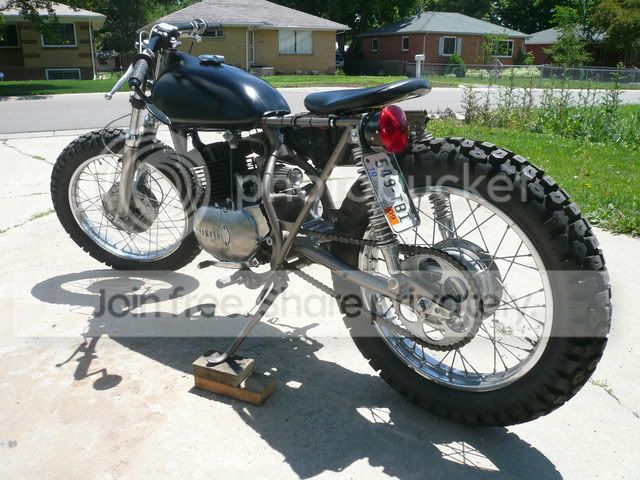

Recent photo....some asshole still needs to make a seat, but runs solid after a total rebuild, of which I suppose I should post photos.

almost there! just a few things to to finish up. here's some photos from the seat build and a some showing where she sits now, with the new belly pan, mud guard and seat.

Need to make a small steel piece to cover the underside of the seat at the tail, run the wiring to the rear lamp (epoxy the wires to the underside of the metalwork so it doesn't get ripped off by the spinning tire, its a close fit, I left 1/2" of clearance) and do the final painting, same color, just parts that need reworked after fabbing.
I used marine grade vinyl and 1" fiber batting, and took them to my mother for sewing.
