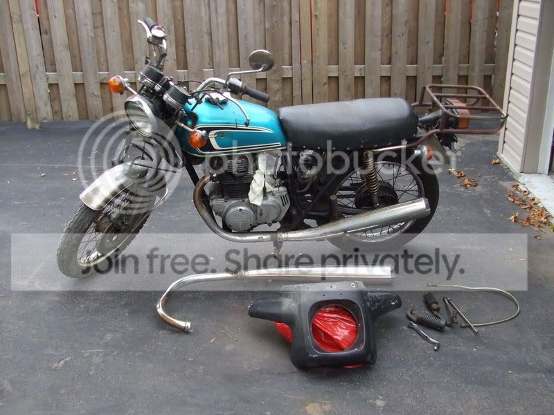

So, I splurged with my billions and bought LoveHertz's spare CB360 (as a favor :P )
Anyway, here is a picture of when it got home.
Only really missing a set of carbs... plus some minor bits.
So, we all go to milton, and I happen to get some bits... and the result it this:
Introducing Project Mini-Bob

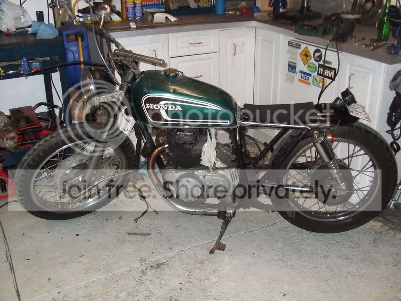

Well, between the secret project and this, i've been busy.

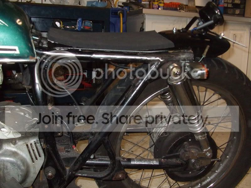

First I built a seat outta 1/8" steel with a fender off a CB750. I added an aftermarket Model T Taillight and some turn signals (cause I like having signals for dumb ass drivers) I've also got all the wires tucked away nicely with all the required electrics... just need a battery.
It's hard to see in the second photo, but there is a switch for the lights... Low-Off-High... again, for dumb ass drivers on the road. One thing I'm not happy with is the seat pad that I have there... Thinking about a thin pieces of foam and simple leather cover.
Here are the completed bars with all controls. I added 2 micro switches into the housing that I included, one for horn, one for turns.
Yes... it's missing a clutch... and that's how that will stay. Busy trying to fab a foot clutch, but it's proving to be a bit tough. I expect that i'll end up build 2-3 different versions of the foot control to get it right.
oh, and an overall pic.
kinda crappy, but what you going to do.
