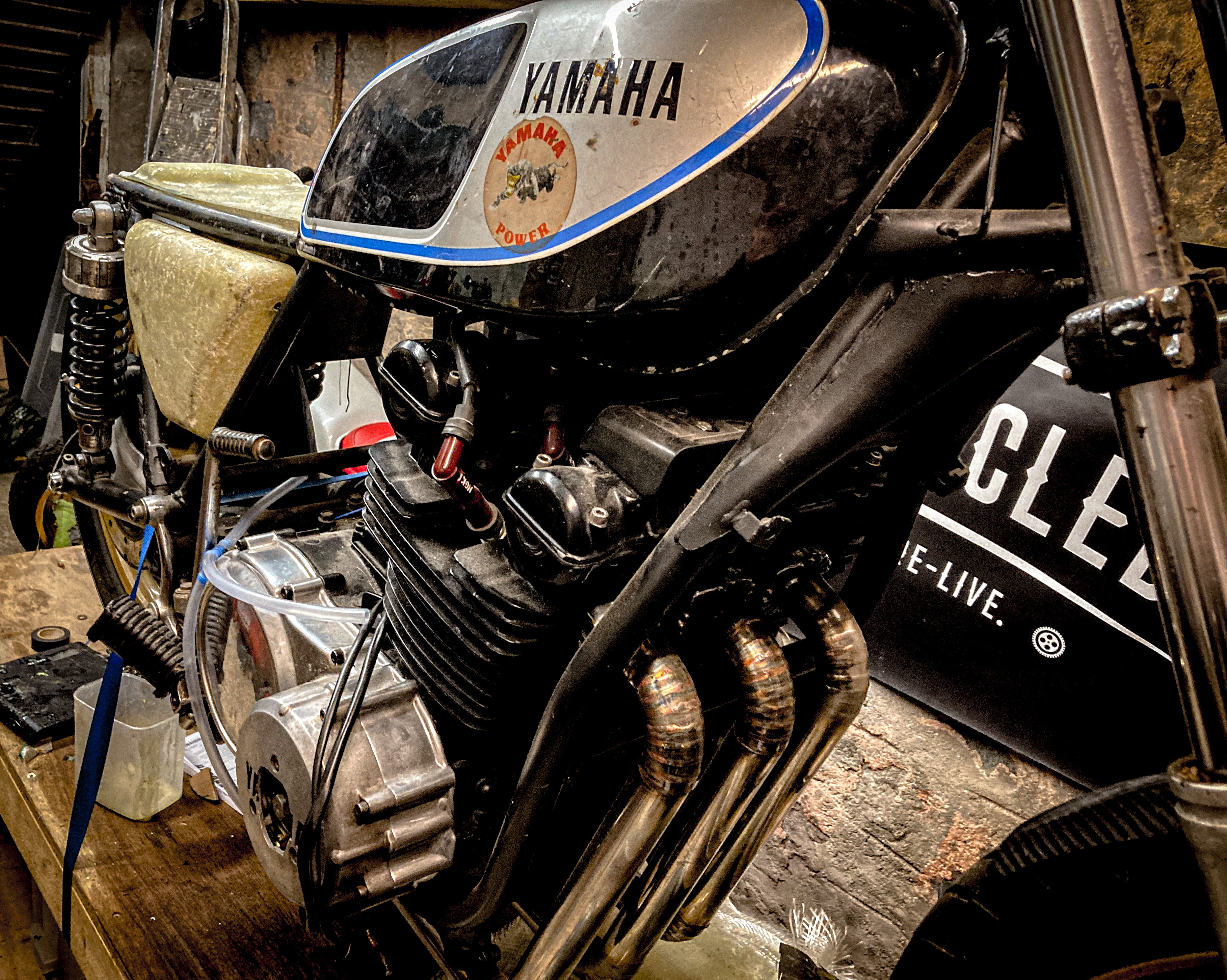

I left a wee message in the introductions the other day. I thought I would create a build thread for my current project, a 1981 Yamaha XS850. Here's how it currently sits:

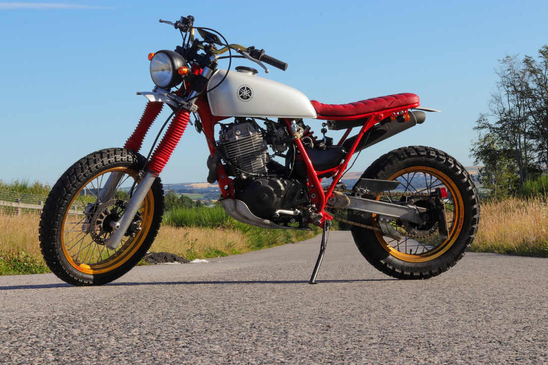

This bike is my second build, my first was a 1989 Yamaha tt600 I turned the retro cool up a little bit on:
This bike taught me an absolute shitload but I knew I could do more. on the way back from exhibiting at the bike shed show 2019 in London, I had already most of the XS850 build planned in my head.

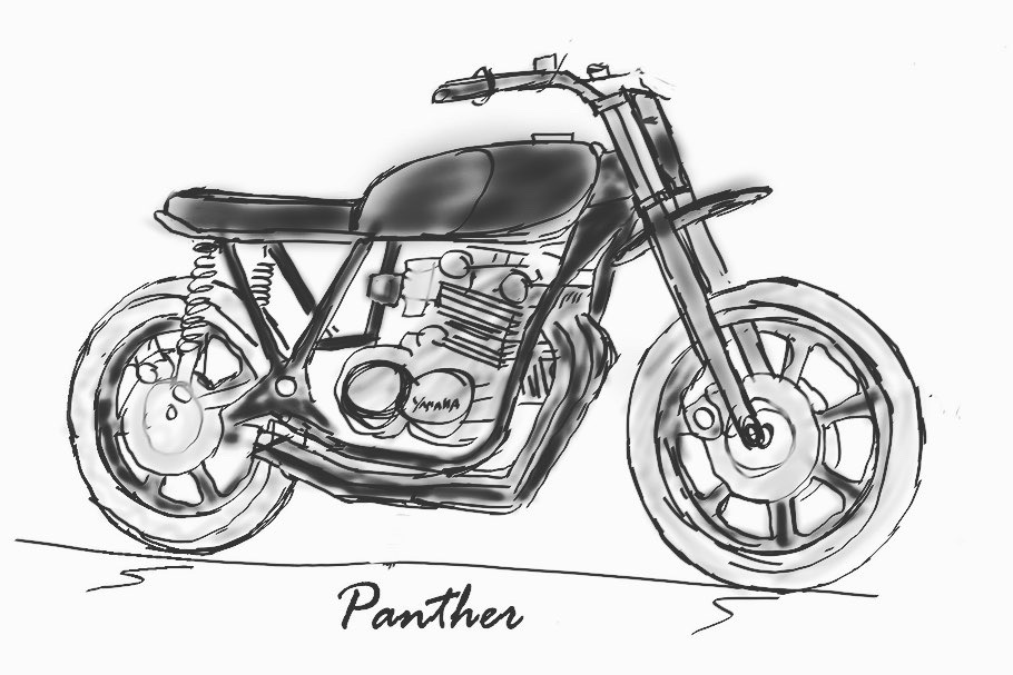

I quickly made a crudely drawn sketch of "Panther". I had a crazy idea to take inspiration from the black panther animal, all black and mean with subtle colours...Not quite a cafe racer (ouch my wirsts) but not quite a tracker, somewhere in between:

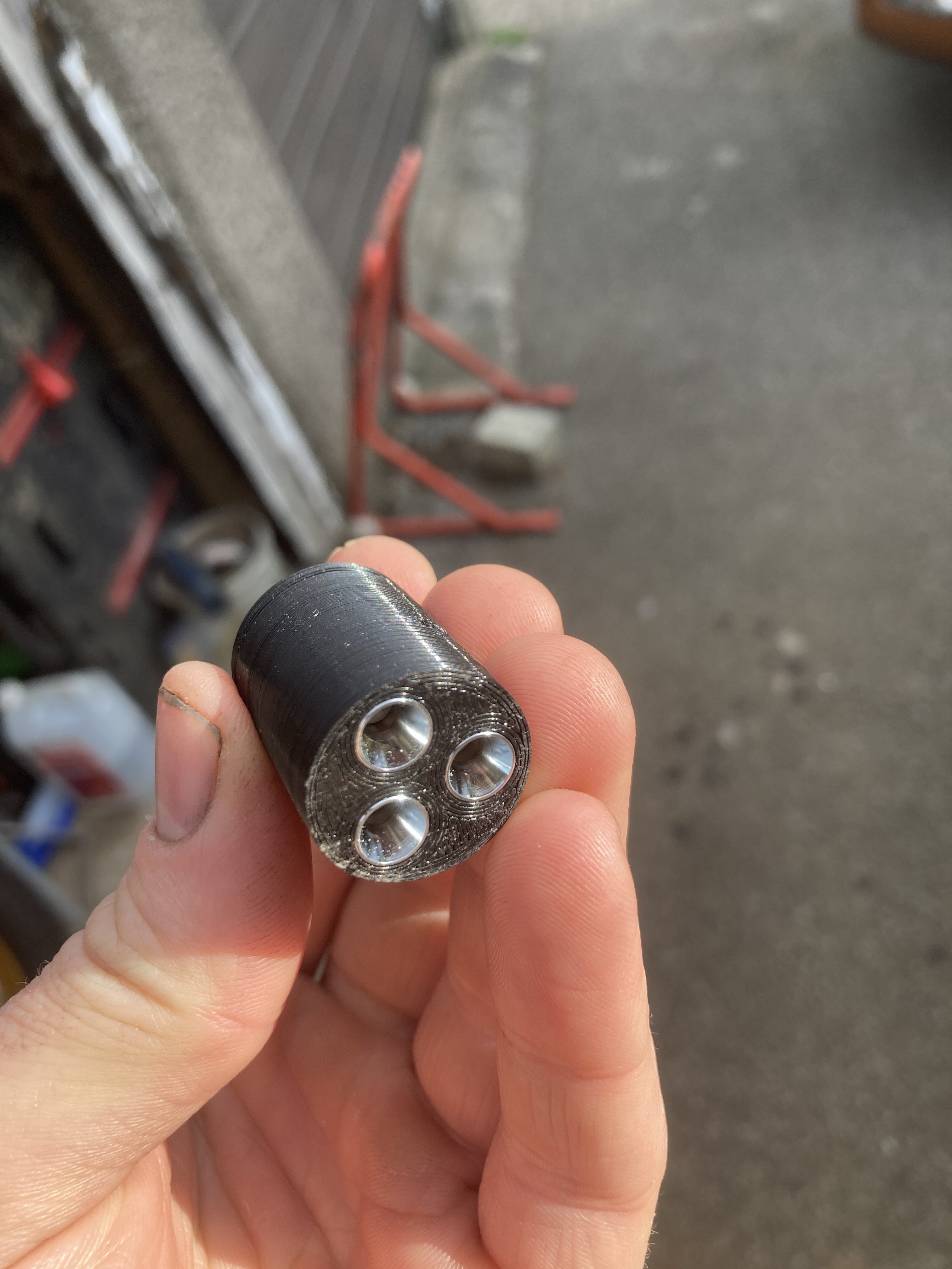

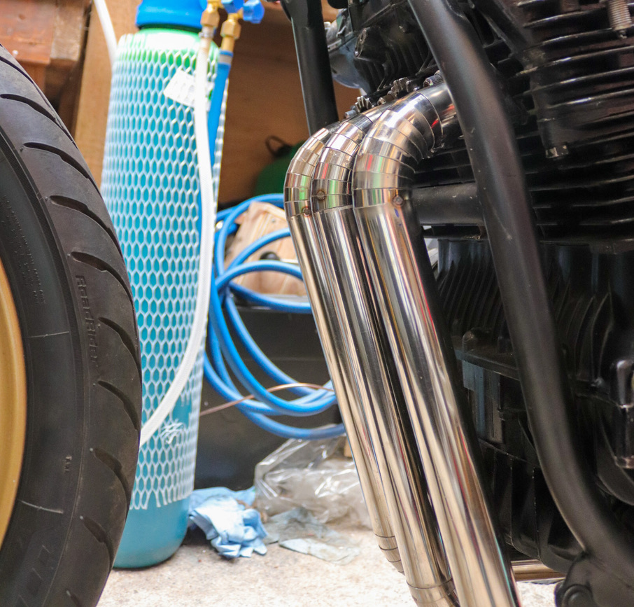

First big ticket item was the exhaust. Something I have always wanted to make. I purchased a TIG welder last year and was using it for many little projects around the house. I set my self a pretty ambitious goal of building a pie cut custom exhaust. I wanted to really open up the triple sound so designed a 3 into 3 system of slightly varying lengths to exit underneath the bike:
I recently got round to getting this fully welded together. First time welding stainless....first time welding pipe...I managed to get the settings dialled in and it was starting to look OK by the end.

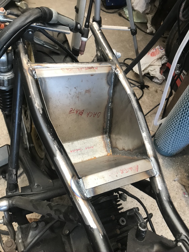

Next on the list was to create a battery box that suited my needs, so i spent a bit of time trying to think what i wanted to store in it. This was initially made on CAD (As it was quite a complex shape) then i cut and bent out of sheet metal. This was my first time welding thin metal so it was a bit tough going....reckon after all the exhaust welding it would be a bit easier now!

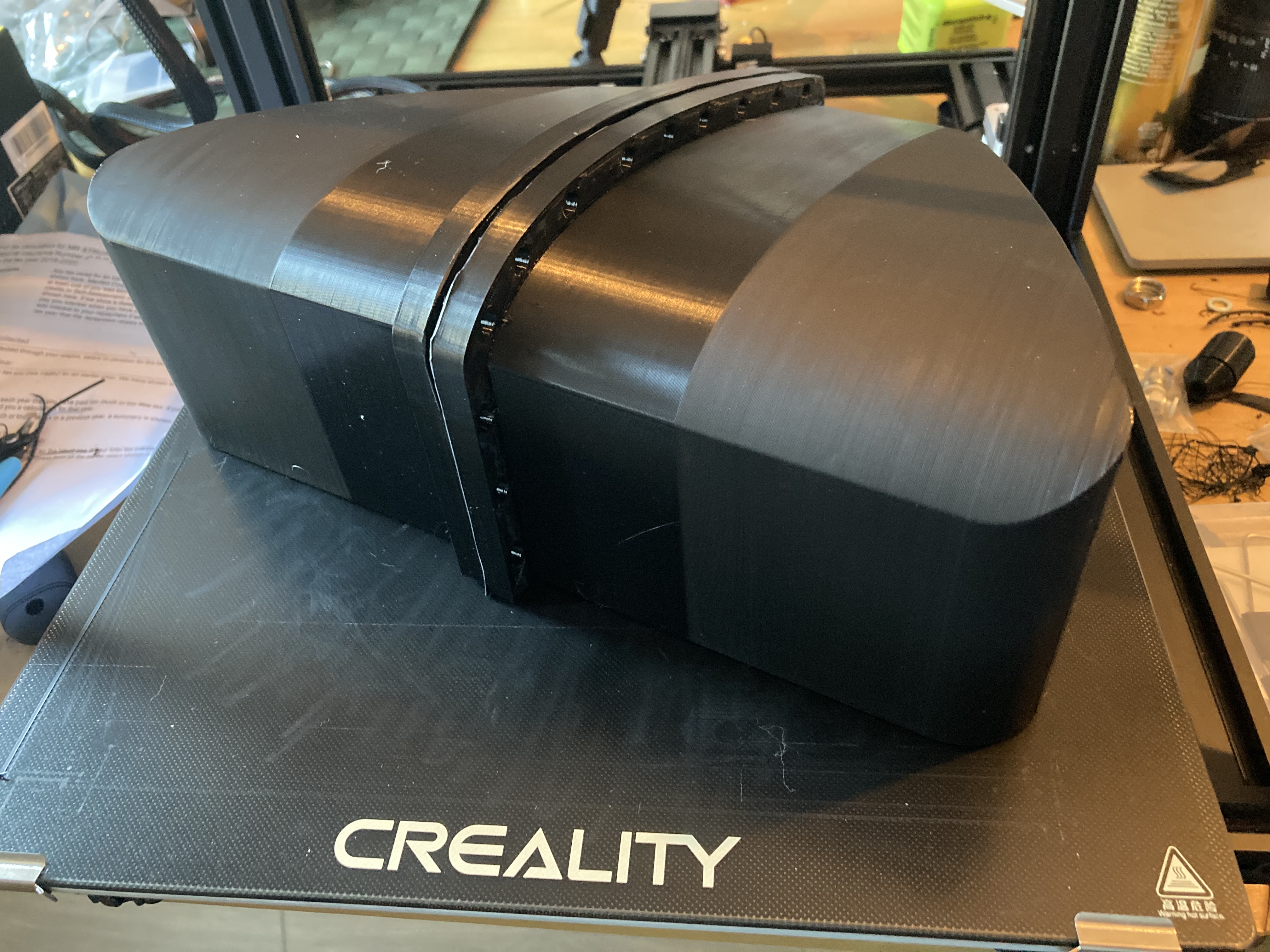

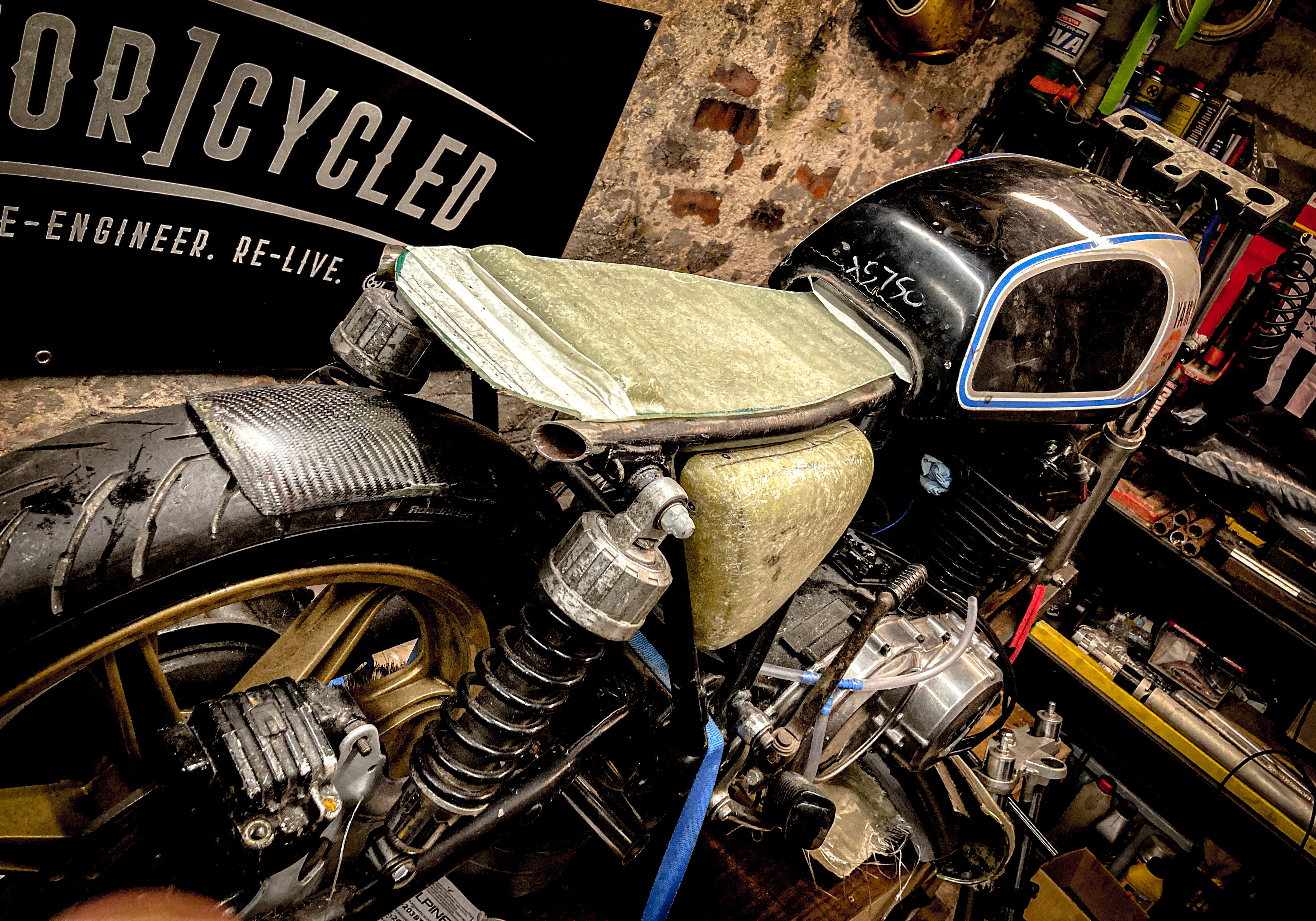

recently bought a 3D printer so that’s opening up a world of opportunity to make things come to life.

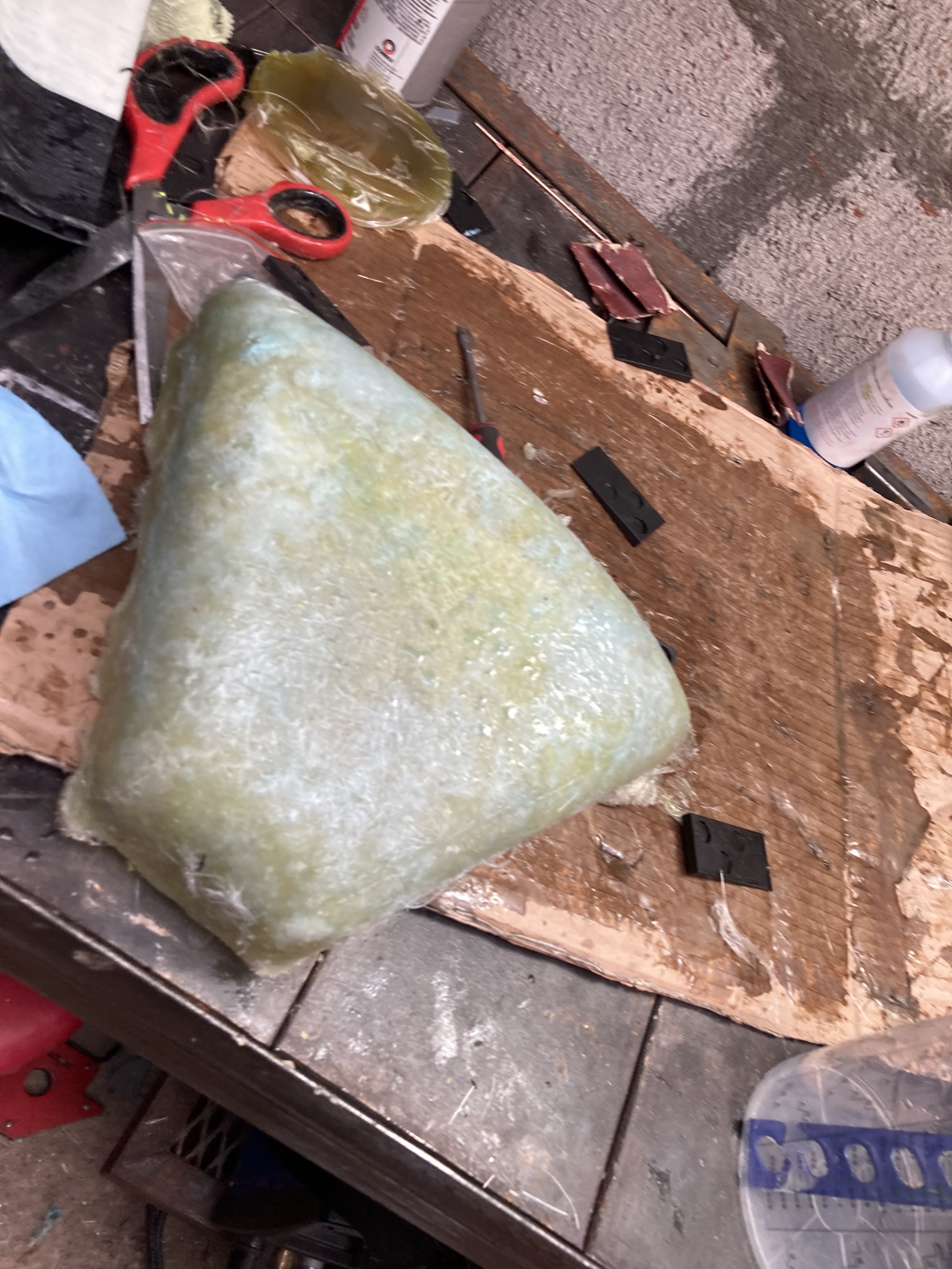

recently printed a mould so I can make fibreglass side panels for my build. Also been working on my indicators which has been a fun little project. Once I figure out how to mount the side panels that will be a good win.

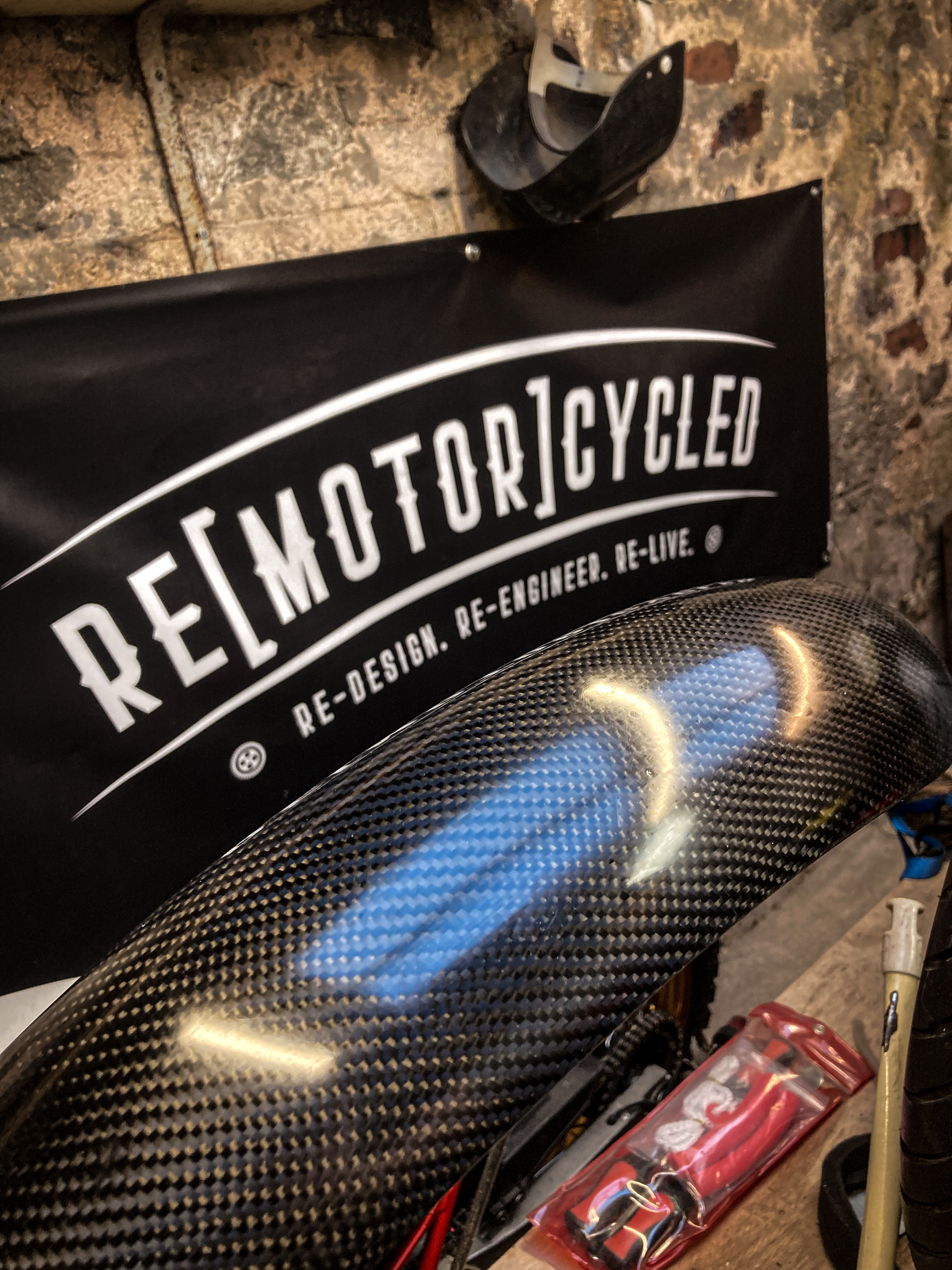

Been a bit of a hiatus on the old updates with a new job etc but still chipping away in the garage. Managed to make a carbon fibre mudguard which I am pretty happy with!
Will post a link for the YouTube on how I managed this.
