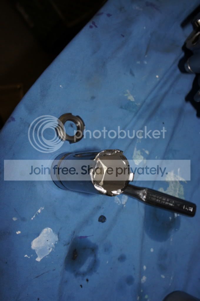

I found that craftsman made a locknut wrench:
I personally don't like spending tons of money on a single purpose wrench. I had a few extra sockets lying around so there was no big loss with this.
I measured with calipers to see what size the notches were then roughly cut away with a dremel until it fit. It is crude, but it works.

Great work on the wrench. I ended up borrowing one for a buddy. Got it back together with the exception of the o-ring on the filter. It was missing when I took it apart so I ordered one online...always something.

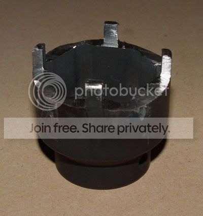

Mine's even cruder, but I did a similar thing for the steering stem nut:
I chose the 'hot rod flat-black' option ;)
