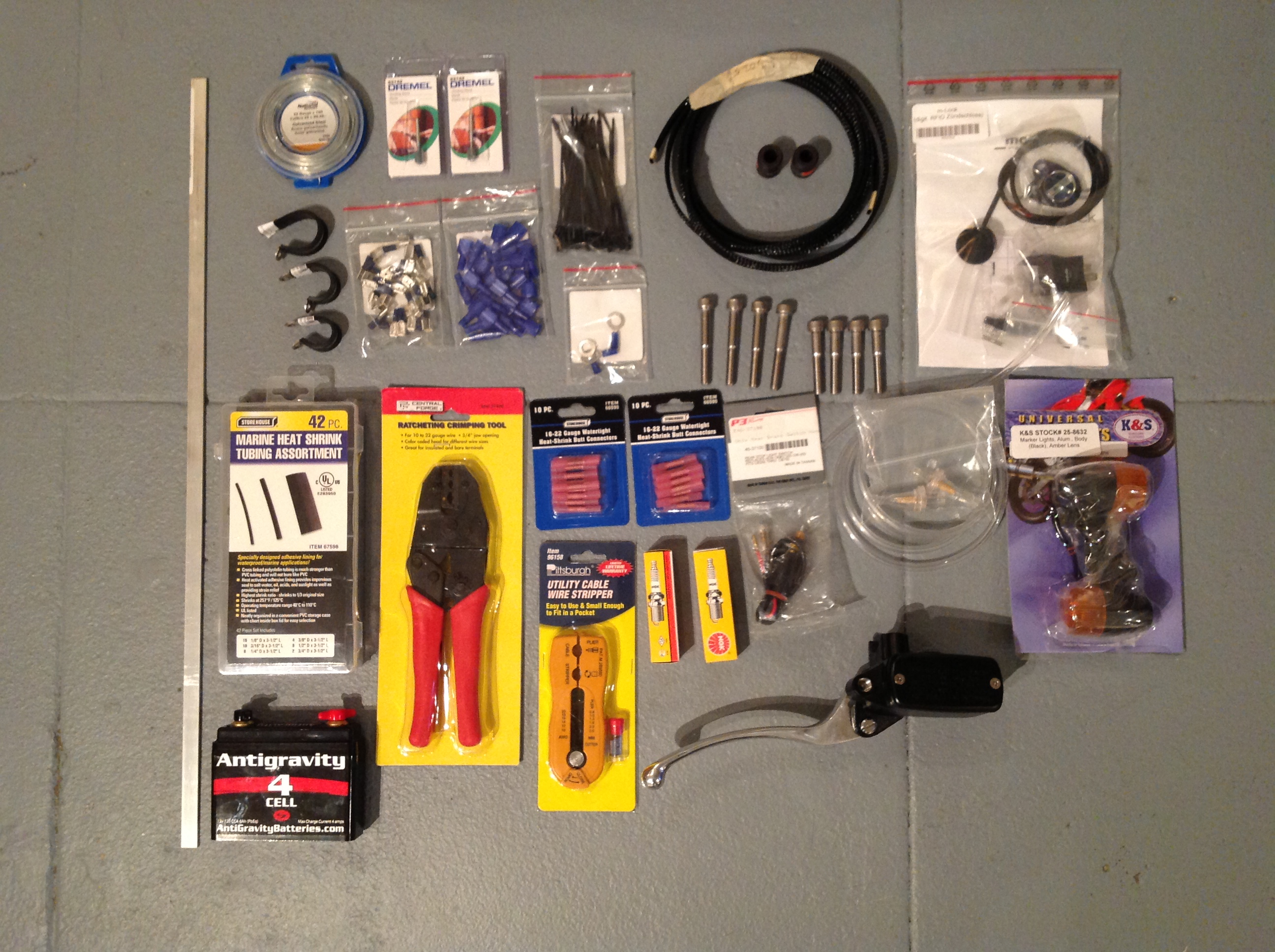

Blinkers, brake switch, master cylinder, universal left hand switch, headlight bulb, motogadget M-Lock, seals, spark plug wire, condenser, fuel lines, spark plugs, fuel filters are here and got everything else to finish the bike on the way.
Time to put in some wrench time, its good to be home :)
Stuff :D

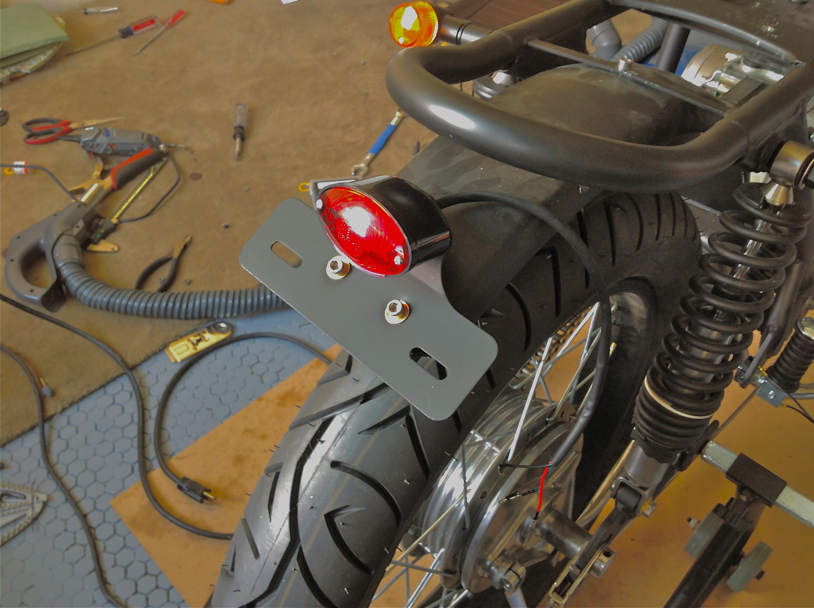

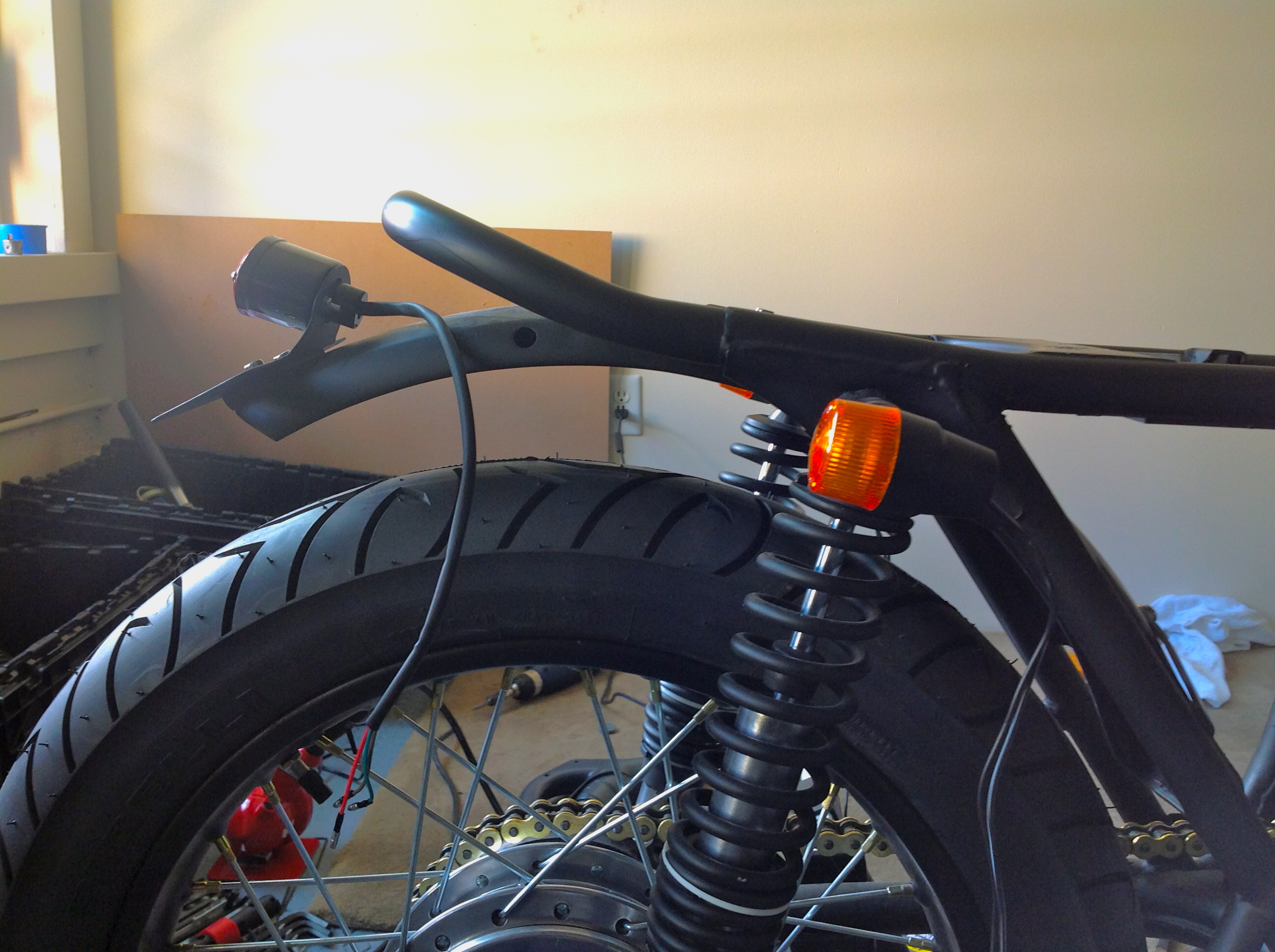

Tail light and blinkers mounted, although the brake light isnt very bright at all, might have to swap it out (took the idea from CRD)

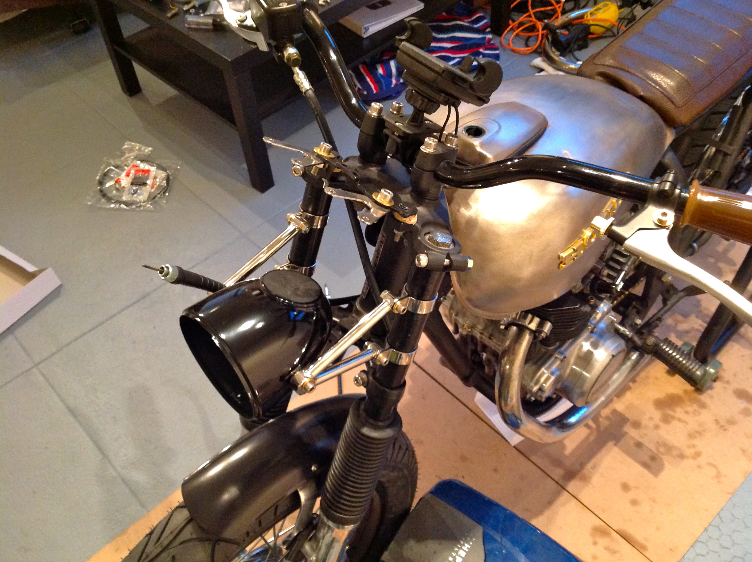

Just got my custom brake cable in the mail from Slingshot cycles, really nice guy to deal with but the brake line is too short :/ I tried routing it several different ways with no luck.

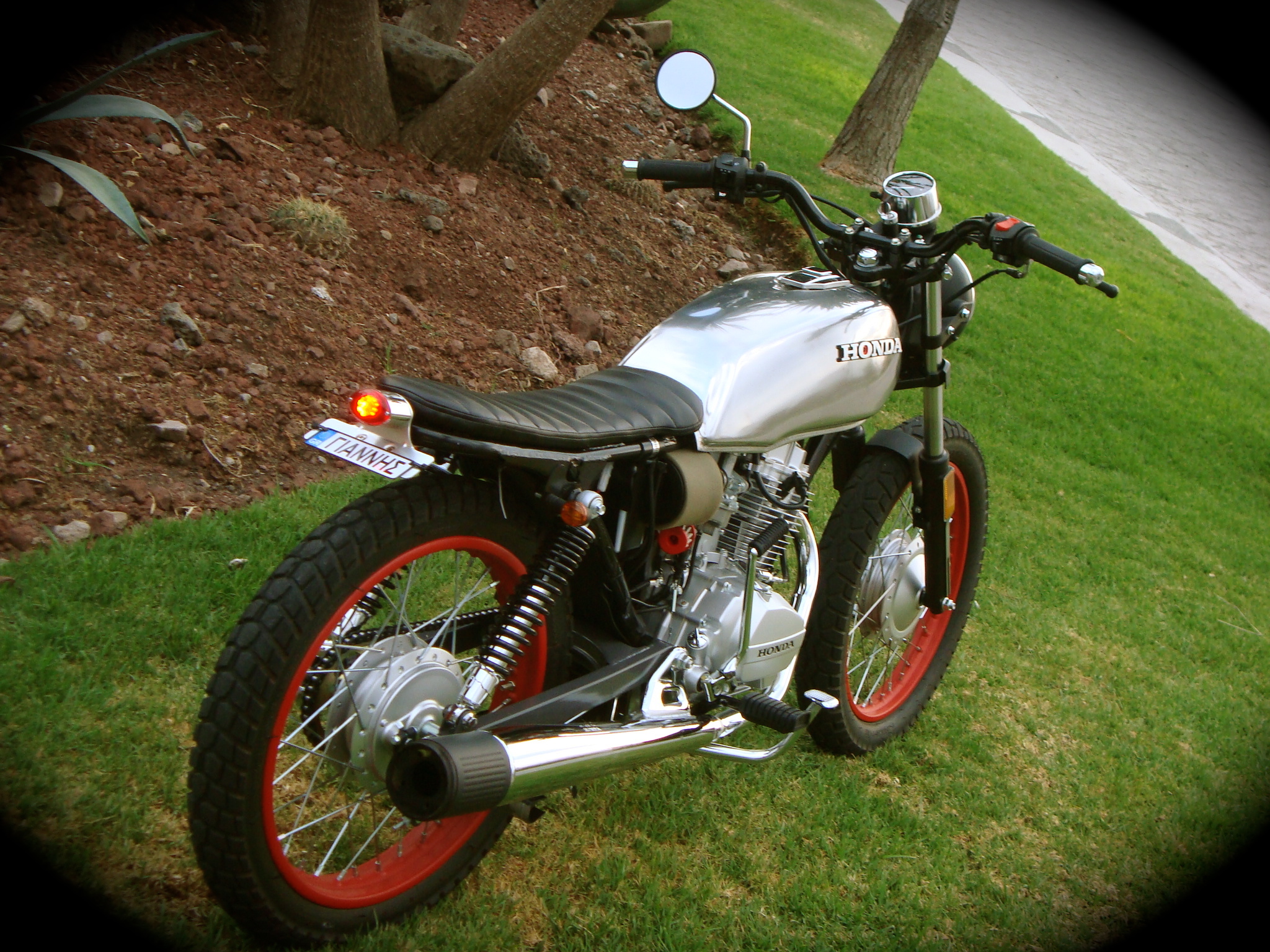

Hey Finnigan! I am using the same taillight but replaced the bulb with LEDS. I don't love the way LEDS look in "vintage" bikes but it is much brighter now!
I'll add a pic...

Thanks man! I'll sell her though. Looking for something a bit bigger.
I want to see yours finished!

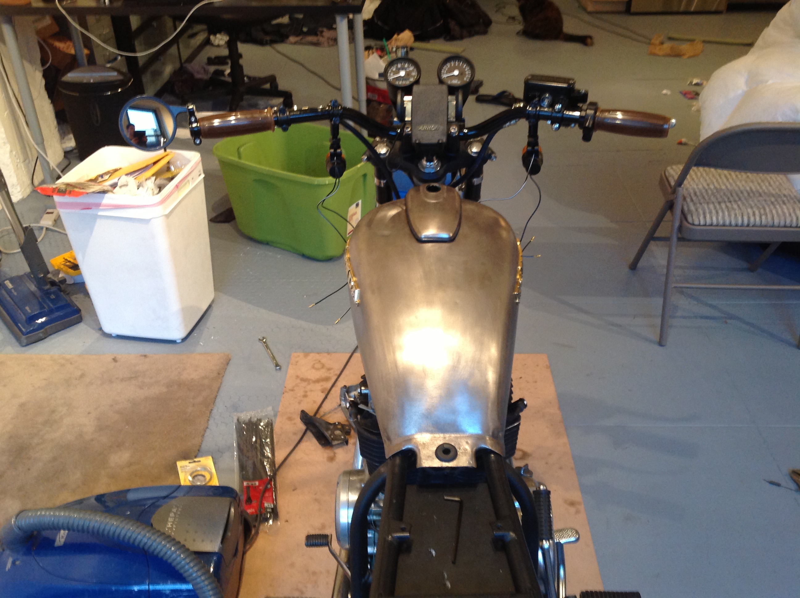

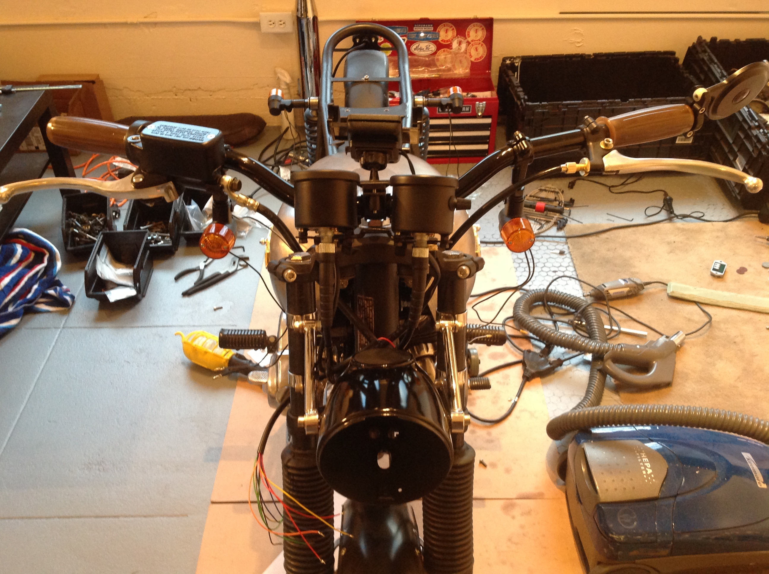

Figured a way to hang front blinkers from the handlebars
Instruments are black now :)

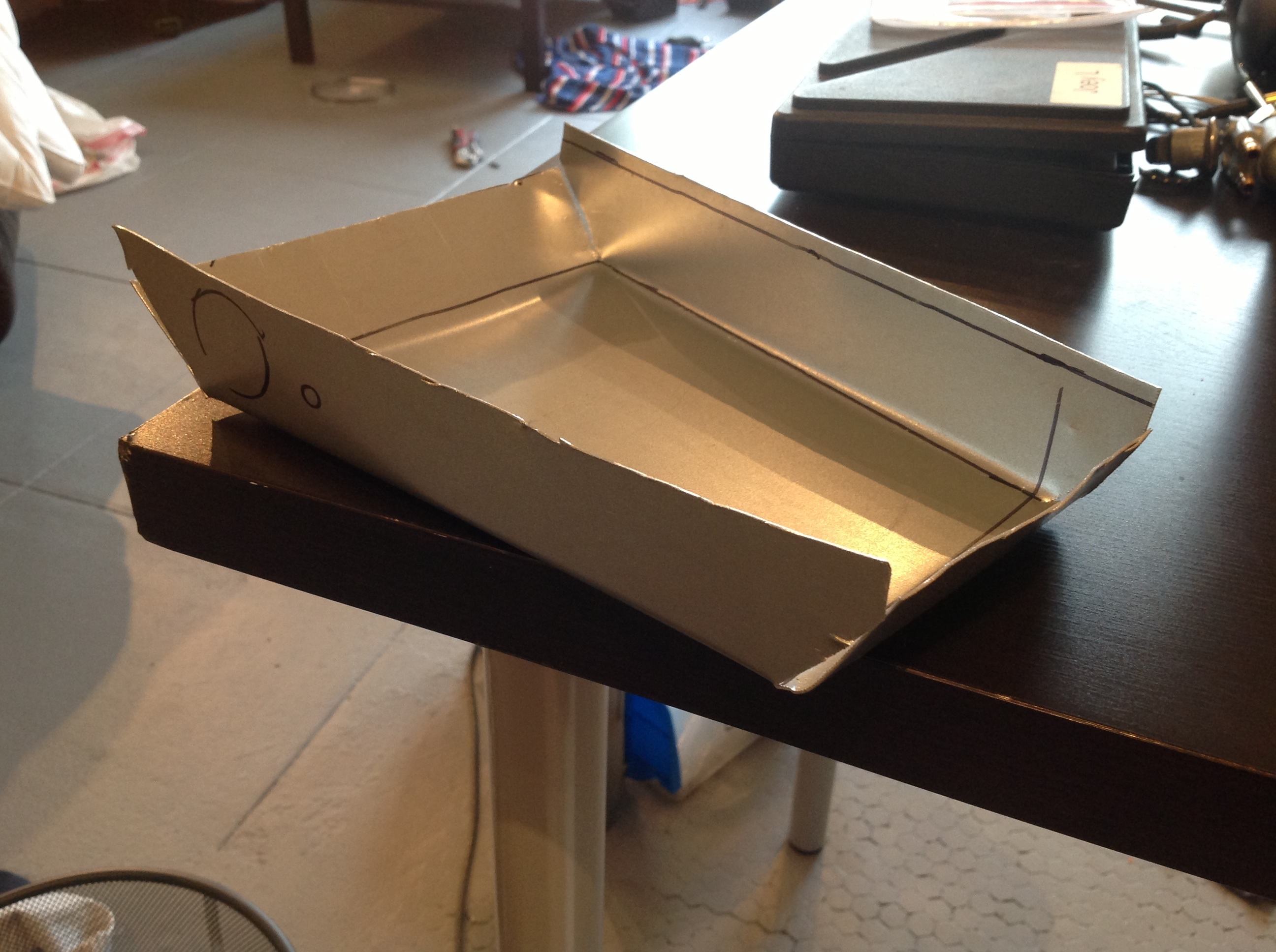

Simple and ugly electronics box 8)

Are you planning to put the battery in there? Its pretty light material. but it outta hold.
