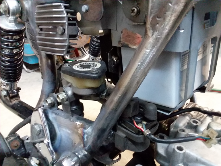

I found a nice, quiet place for the starter solenoid tuckned away behind what will be the fiberglass body panels that will wrap around the battery/electric bay. I might even be able to squeeze the regulator in there somewhere too.

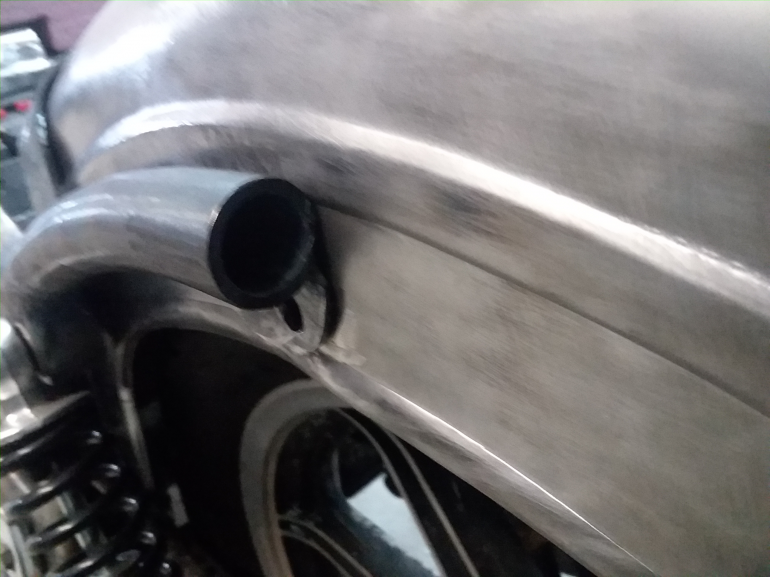

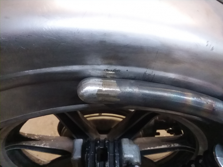

Bought two one inch ball bearings to serve as end caps for the rear fender support tubes. Just cut 40 percent off each bearing and welded them to the end of the one inch fender support tubes.
