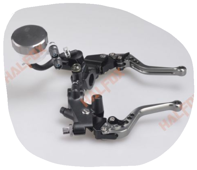

A quick update, my new lever assemblies are in the post, nothing special, off ebay. They will do fine until i can one day source bigger calipers to replace the single pot ones. When this master cylinder goes on, i will get braided hoses and new pads to help improve the braking. I will give the calipers a nice service too.
