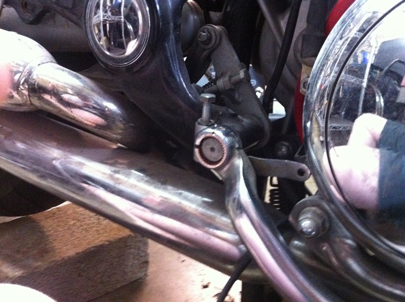

Here is some pics first I'll show you the shifting side so you can get an idea where the rearset will sit on the brake side. There are some exhaust in the way right now. I will also be welding a mounting plate on both sides under the frame.

Brakes, hope these are good enough pics.
