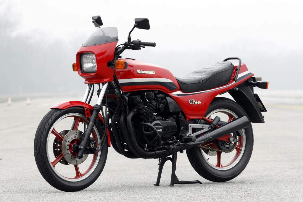

the reason the japs went to leading axle forks was a few
lots of times the style was longer forks and they went leading axle to increase the internal overlap of the forks to add rigidity less flexy,and the increased overlap reduces stiction making for a more compliant ride
an added benefit is rotational moment of the heavier longer forks is reduced by having the leading axle as well because the triple offset is always less with leading axle forks
there were a few very good handling bikes with leading axle forks the gpz550 is a great example :D
but of course the RD uses much shorter forks than any of those old 4 strokes
