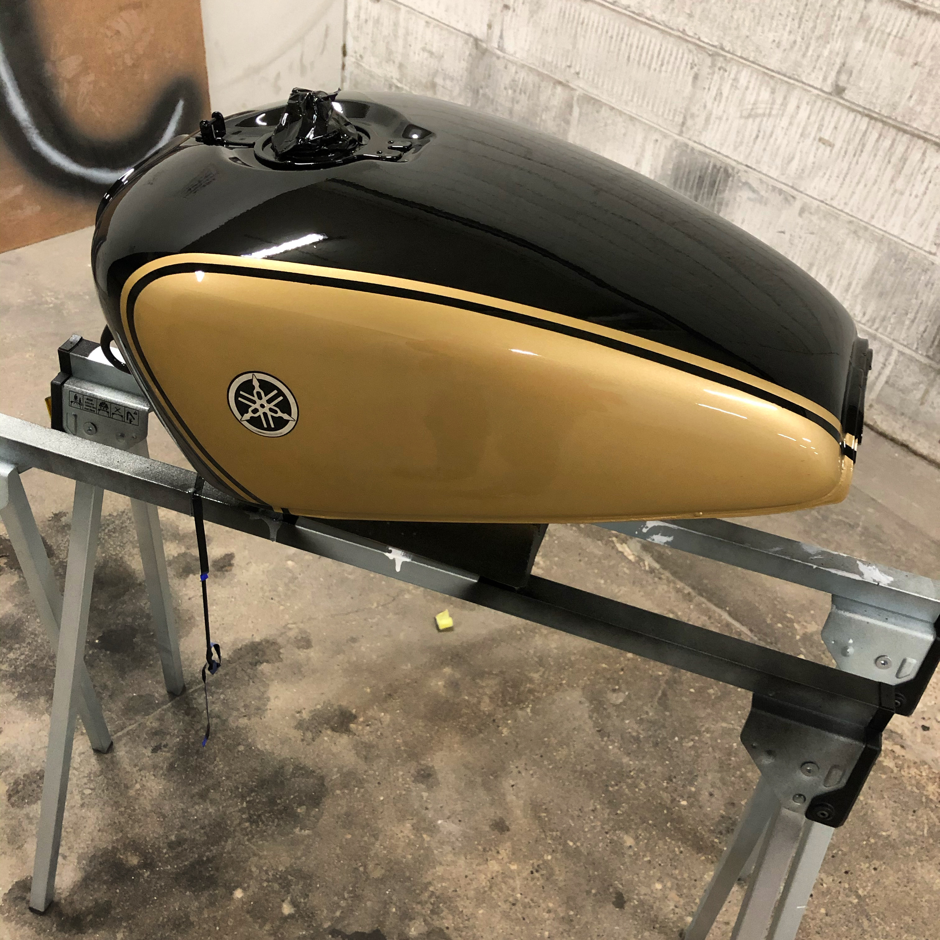

Here is my fuel tank right after clear coat.
Process was:
2K epoxy primer (colormatic)
Filler (u-pol fantastic)
2K epoxy primer
1k high build primer
Painted the gold base coat (color match for a '70 chevelle ss in champagne gold)
Masked (badly)
Painted the black base coat (BMW Schwartz II)
Put the badges on
2 cans of spray max 2K
I have some dust spots and other imperfections, that I hope to sand and polish out when it's cured. Also made a mark in the base coat on the opposite side when masking, but didn't have any more paint to fix it with.
Wow, tank looks great! I like the gold. I had a hard time finding a decent gold locally when I did my MB5. Yours looks like a nicer one than the one I used.
Thanks! I found a supplier that could fill cans with car paint and gave them the paint code for the car I liked. This is the label of the can for reference if anyone else could use it

Beautiful work! Orange peel free? What is your process of applying 2 cans of 2k clear and not getting orange peel?
I'm still a little bitter that 1/2 my tank has orange peel and I have no clue what i did wrong compared to the other half. Lol
It looked pretty fee from orange peel, but lets see how it looks after it’s cured. I’m not coming by the garage until Tuesday so won’t know for sure until then. I sprayed a light coat to begin, then just continued laying on coats. I also sprayed a control piece next to the tank and as soon as I could feel it wasn’t very sticky anymore I did the next coat. Ended up with about 10min between.
Interesting. I was thinking you had to apply new coats while the previous was still sticky. Maybe that was my wrongdoing.
I did speak to a painter I know. He said expecting a rattle an job to be fully free from orange peel was a miracle. Lol
If I did anything right, it was probably just pure luck/miracle :)

Yeah the more I read the more I realize orange peel is the norm for spray can clear not an exception.
How many coats did you say you put on? I think I did 4 and a bit paranoid of sanding through.
I kind of lost count, but with two cans I figure 4-5.
I actually sanded quite a bit in a few places, as I had a dimple in the coat one place and a bit of dust in another, but didn’t go through the clear.
