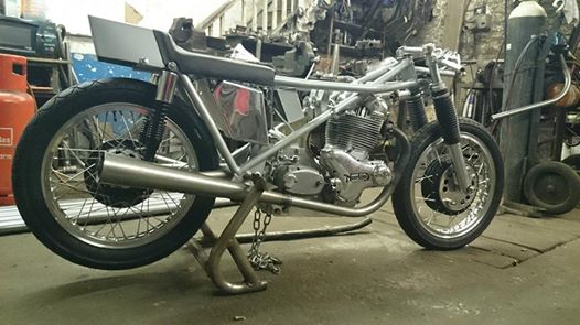

She's gunna be a mean machine once you've finished her, for hand made exhausts speak to Ben at Rayson's crackin lad and top notch job he's just done a twin set of open mega's for a Sealy Norton we are building (see pic), if your anywhere near manchester and need chrome, powder coat, zinc, bead blast, vapour or anything give us a call speak to me (dave) and ill sort you a good discount.
