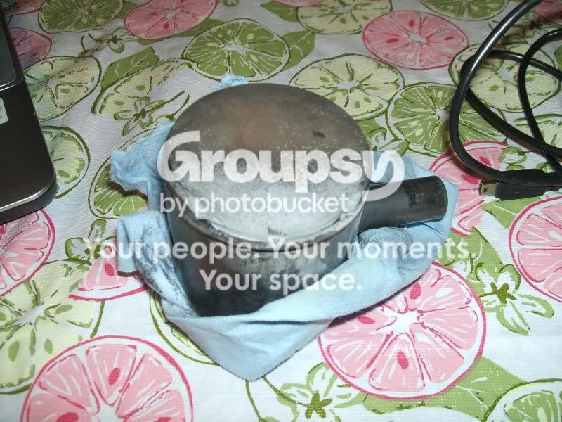

Weisco rings in a RD350, one hot run after seating the rings. Made it 3 miles till it started screeching and squeaking, then lost the right piston on the way back home. Total ride time 10 mins before the top of the piston came apart.

The ring spun and caught the exhaust port. The ring was made too thin and this happened. So yes I can blame the ring for this. I put factory parts back in mine, and I haven't had a problem in 5k+ miles.
no you did it wrong
what did you do put wiseco thin rings on yamaha pistons ?
Those appear to be very old type pistons that used an L shape (Dykes) top ring. What rings were fitted? Normal late model Wiseco or rings for that old Piston?
Did you build the motor with rings that were clearly too thin for the piston and hope it would be OK or was it built by an OP?

These pistons and rings were to be a matched set from wiseco, older but still new and in plastic. When I put them in, the top of that piston looked nothing like when it came back out. The other piston still looked new. Needless to say it's better to take a more in depth look to see what's causing the noise. Anytime something doesn't sound correct, take it apart and see what is going on. Gaskets are cheaper than engines.
The older Wiseco pistons were 'fully variable' quality and size.
It was 'quite normal' to open 20~30 boxes to find two 'close enough' but very very rare to find two the exact same size (or within 0.0005")
You need at least 0.005" clearance with them in an air-cooled two stroke plus the bores may not be the same size
Since they went CNC they have been pretty damn good though

Looks like timing was over advanced plus a bit lean top end?

Um, that's not possible. There MUST be a pin in the ring grooves that prevents the rings from rotating around the piston. If there isn't a ring locator pin, then you can't use that piston in a two stroke.
That piston looks melted to me. Detonation is the most likely cause. Too lean, and/or timing too advanced is what I would look at.
