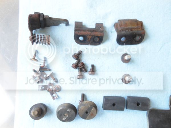

the foot pegs, springs and fastners were pretty nasty
restored:

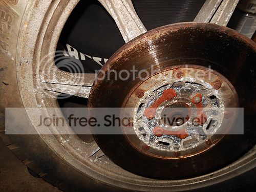

the alloys were very oxidized.. pits were pretty nasty. Here is a close up "before" pic:
Gave them a blast with bead:
I wet sanded and polished the rims ( wheel on the left is before plolishing , the wheel on the right has the rim polished )
New wheel bearings and seals installed:
Finished up with the rotors and hardware .... new tubes and tires:

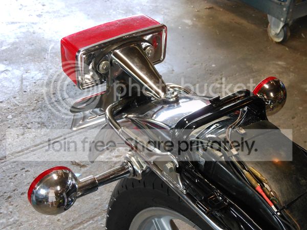

Installed the rear fender, grab rail and lights.... before:
after:

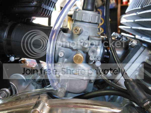

Heads on a torqued, reed cages and boots on just waiting for the carbs. Fresh ignition set installed, points gapped. set timing

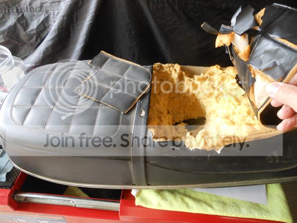

I restored the seat and associated bits:
Blasted and fresh chassis black epoxy:
After:
After:
New reproduction Foam from HVC:
New reproduction cover from dis-covers .
( I can't speak more highly of a supplier- made in England, awesome service and the shipping was free to 'merica )

So I have new hardware to go with the new fuel line and petcock:
Before:
After:
