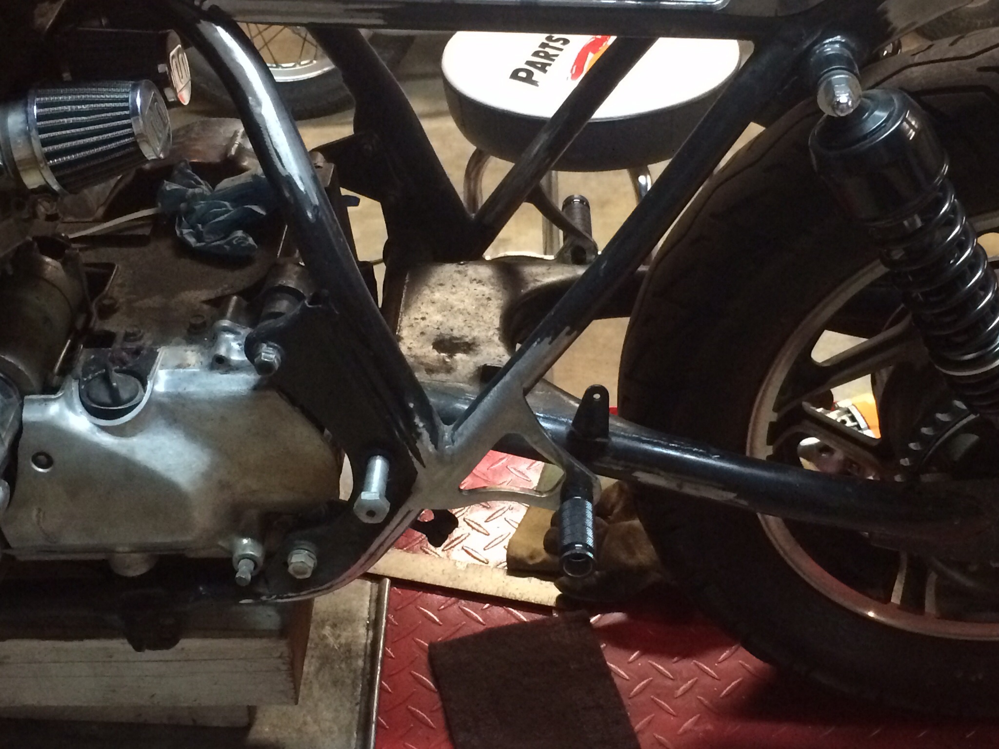

A friend is able to fab some brackets for me to mount some universal rear-sets but he's asked if I can find some photos from people who've made/fab'd similar brackets. Could you guys help me out with some photos if possible?

Must people with dohc C/K bikes mount the rear sets on the passenger foot peg mounts. You just get a universal set and you're all set.
Yes, they will, if you can sort your linkage out and such.

not sure if this helps....
