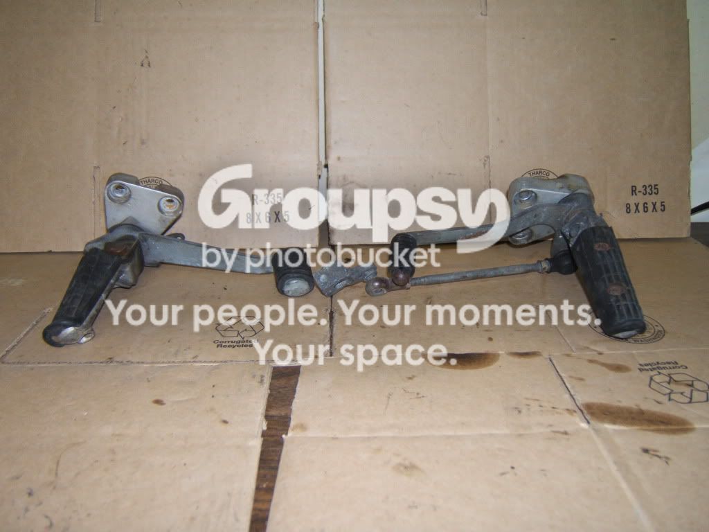

Look for FZR600 rearsets. They're a near direct bolt up. Just need to open up one hole in the RD frame. They look like this:
http://m.ebay.co.uk/sch/i.html?_nkw=fzr600+rearsets&isNewKw=1&_sop=12&_pgn=1&epp=24&itemId=&fads=1&mfs=GOCLK&acimp=0&sqp=fzr600+rearsets&trksid=p2053742.m2428.l1313.TR2.TRC0.Xfzr600+rearsets
These.
On your RD frame, there are two threaded holes where your stock passenger peg mounts bolt on (bottom rear of the engine cradle). The bolt holes on the FZR rearsets almost match. So... You run a mounting bolt throght the top hole, then drill out the threads on the bottom. Replace the bottom bolt with a longer one and fasten with a heavy washer and nut on the backside of the frame bracket. Make sense?

Just look for fzr600 rearsets and match them to the photo I posted. The ones you just posted should work as well.
I have a set that I got for my TR1 cafe project but not sure they'll work out... Come on the whole footrest mounts (LC NOT YPVS)
