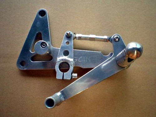

I would be warey of buying "universal" rearset kits......you may be left with more work to do than you imagine !
We make rearsets for Titans......take a look.....and by all means use the same principles to create your own !
Good luck.
Now those are nice rear sets! I have reservations about clamping something as critical as rearsets to the frame. I have a suspicion that they would work loose at the wrong time, like when you're riding! Ha!
