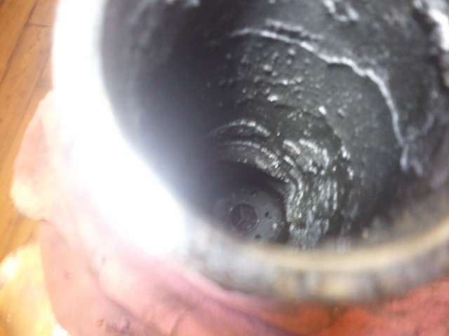

SUCCESS!!
today i removed the downtube...with my daddys spanner wrench.
after that i used a metalbroomstick :-) to punch that sucker out with a hammer...
there is packing...altough pretty much run down...im now cleaning everything inside..cleaning the baffle and thinking about the packing....what kind of packing material should i use?should i pack more or less than original?
i think after those 30.000 km without removing the baffle...i suppose it never came out...using a slide hammer (which i tried) is obsolete.
crazypj said:
We were told to remove it at first service because it blocked up so easy and destroyed performance (except it didn't, packing double the amount 'converted' it into a 'stinger' 8) )
ill definitely gonna pack it...its really loud already :-)

That looks like a lot of oil there. Clean out the muffler first with kerosene or similar or burn it out, but don't use kerosene and then set light to it !
Remove the packing from the baffle tube and clean it thoroughly with a wire brush and you will probably want to burn off the oil and carbon OUTSIDE the shop, not inside. Buy two stroke muffler packing. You want the stuff that is white and comes as a thick blanket, not the loose pink stuff. Lightly wrap a piece around the rear section and hold it in place with thin lock wire.
Do not over pack it. I tried a few times to squeeze in more packing and the noise went up, not down - sa PJ mentioned.
thanks pj!
i bought a mat of baffler material plus a stainless steel lock wire today.how thick do you pack your rd´s muffler?stock is maximum 2 layers of wrapping.
how do you wrap the wire?do you criss cross or is there a special style of wrapping it?
Can't remember how much wire you need but start with about 2~3 ft, use 'middle' of wire; wrap a loop one end then spiral to the other end and twist wire ends after you make another loop
You can also just spiral wind.
Overpacking can increase top end performance but it will have a real loud 'crack', not too bad if racing 'Production class' but probably not a good idea on the street ;)
