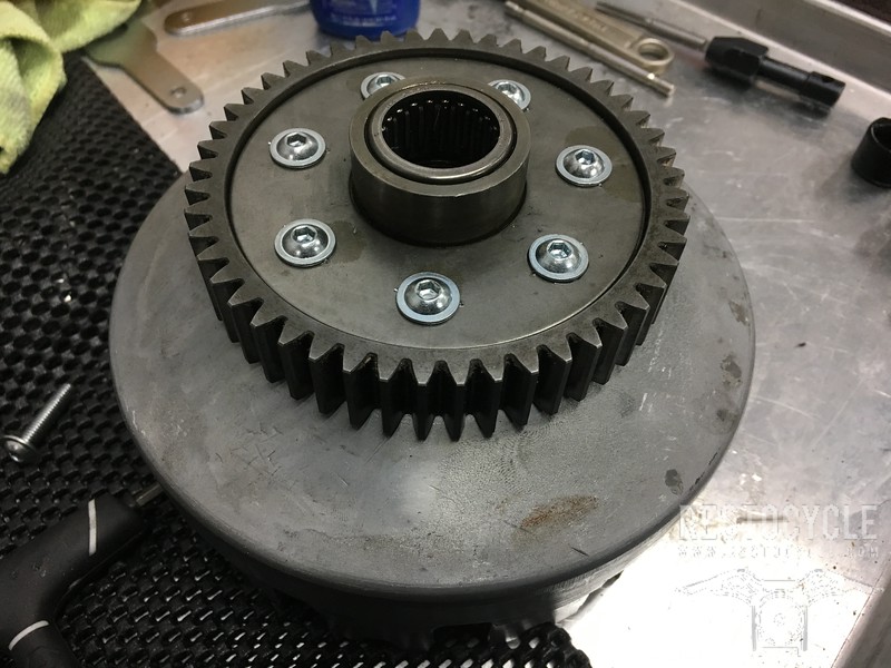

Installed a new set of dampers and screws in the clutch basket. Good kit, good instructions. Clutch basket fingers were in good condition, and frankly so were the fiber plates and springs. Did replace the fibers with new, you know, WHILE WE'RE THERE. Clutch is good to go.

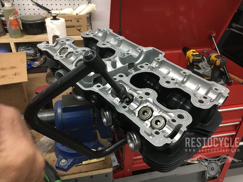

Drilled and tapped the cam chain tensioner adjustment passages for the 8mm screws, and once those were all tidied up we reassembled the head, using the excellent viton valve stem seals.

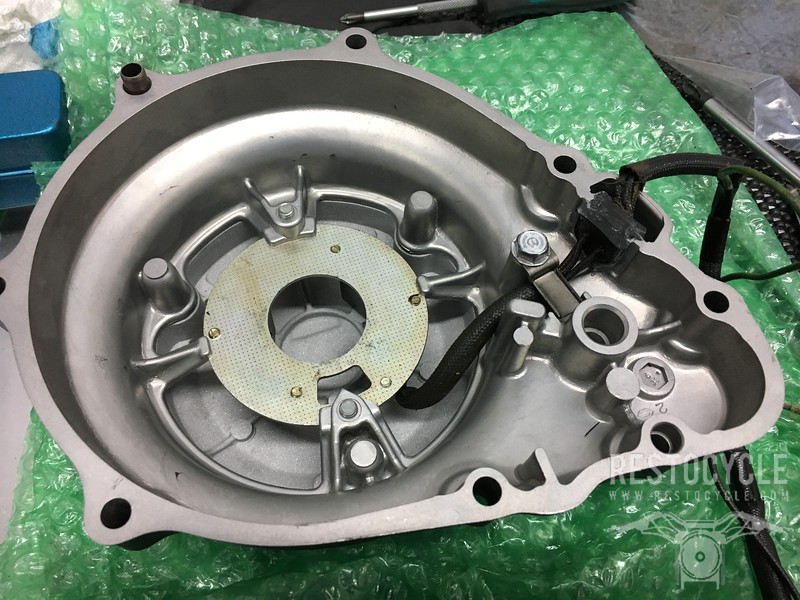

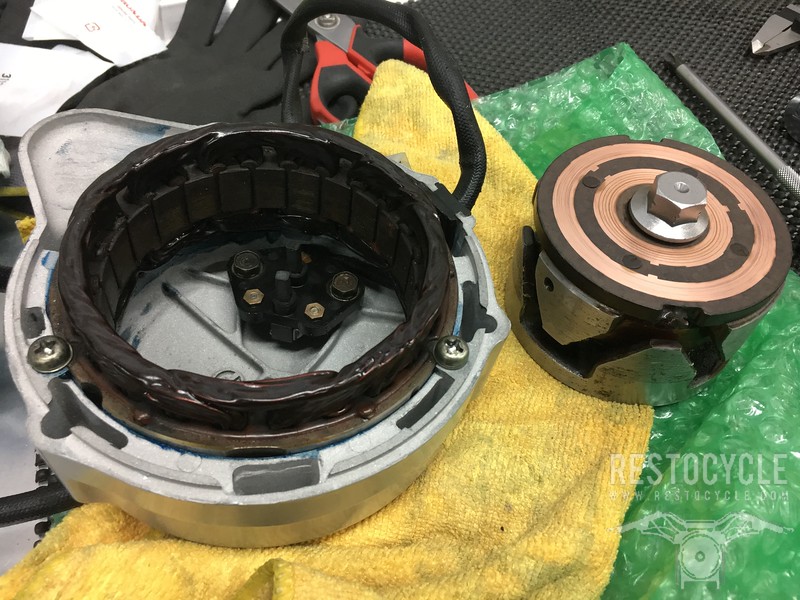

Installed new Honda brushes in the generator cover, tidied up the stator wires and grommet, cleaned up the slip rings and a little bit of rust on the rotor, and checked the rotor resistance at 4.5 ohms, good to go.
Installed a modified R6 starter clutch, perfect fit and operation. Installed the advancer and ignition rotor.

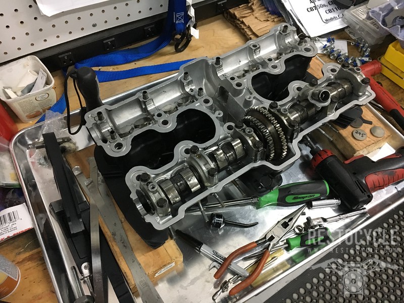

Installed the 900F cams (thanks again Z3R0!) and set the valve clearances on the bench, with a run to the Honda shop to swap some shims.
