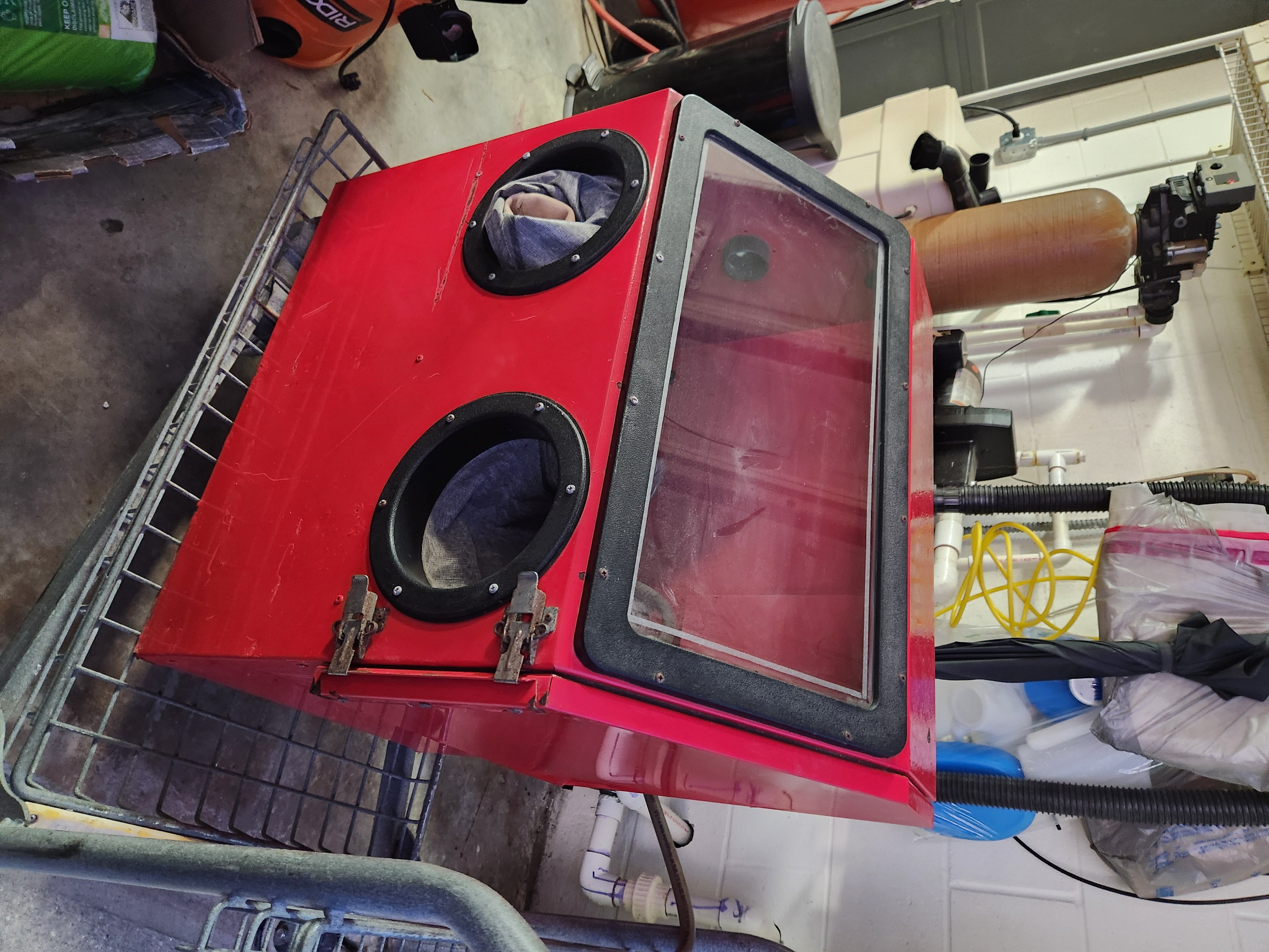

Hi all, thought I would check in. Used the baking soda blaster a few times. Decided to buy a sandblasting cabinet. Got a cabinet on FB marketplace. The guy didn't use it much. I picked it up with a 5 gal pale of glass beads almost full. Got it for 100 bucks. Also picked up some pneumatic tools for 50 bucks. Wife came home from a river cruise in Europe and brought home either the flu or covid. Well of course I caught it. I guess 3 of her friends that went are sick also. With damaged lungs from the accident. I am hoping it doesn't go to the lungs. Anyway here are some pics. Would have preferred battery powered but I grew up with pneumatic and it was much cheaper. Heard them all work.Have to buy a xtra large glove for the left hand. My big paw doesn't fit LOL.Will modify the right hand for my prosthetic.

Great score man, $150 not bad at all for all that, the cabinet looks to be in great shape. What are you going to blast first in there?
Some of the smaller brackets that are painted black. I just ordered a set of bigger gloves for the sandblaster. The old right hand glove. I will modify to use for my prosthetic arm. Also the right engine cover. I just bought it used and it needs a little help. I really only needed the front peice that covers the oil pump. But couldn't find one, so I bought the whole cover. 60 bucks so it wasn't too terrible.

I put a 'T' on my blast cabinet air supply to blow air into the bottom of the funnel where the media gets supplied to gun. This stirs up the media right before it enters the supply hose and massively reduces any clogging or starving of media. It goes through a cheap needle style valve to regulate the flow. Only takes a trickle of air to be effective, so it doesn't rob too much air. Most people wish they had a bigger compressor once they get a blast cabinet!

I am researching about sandblasters and coming up with some good ideas to make the cabinet better. I like the airflow idea. I can see now that if I did a bunch of sandblasting I could probably want a bigger compressor.
