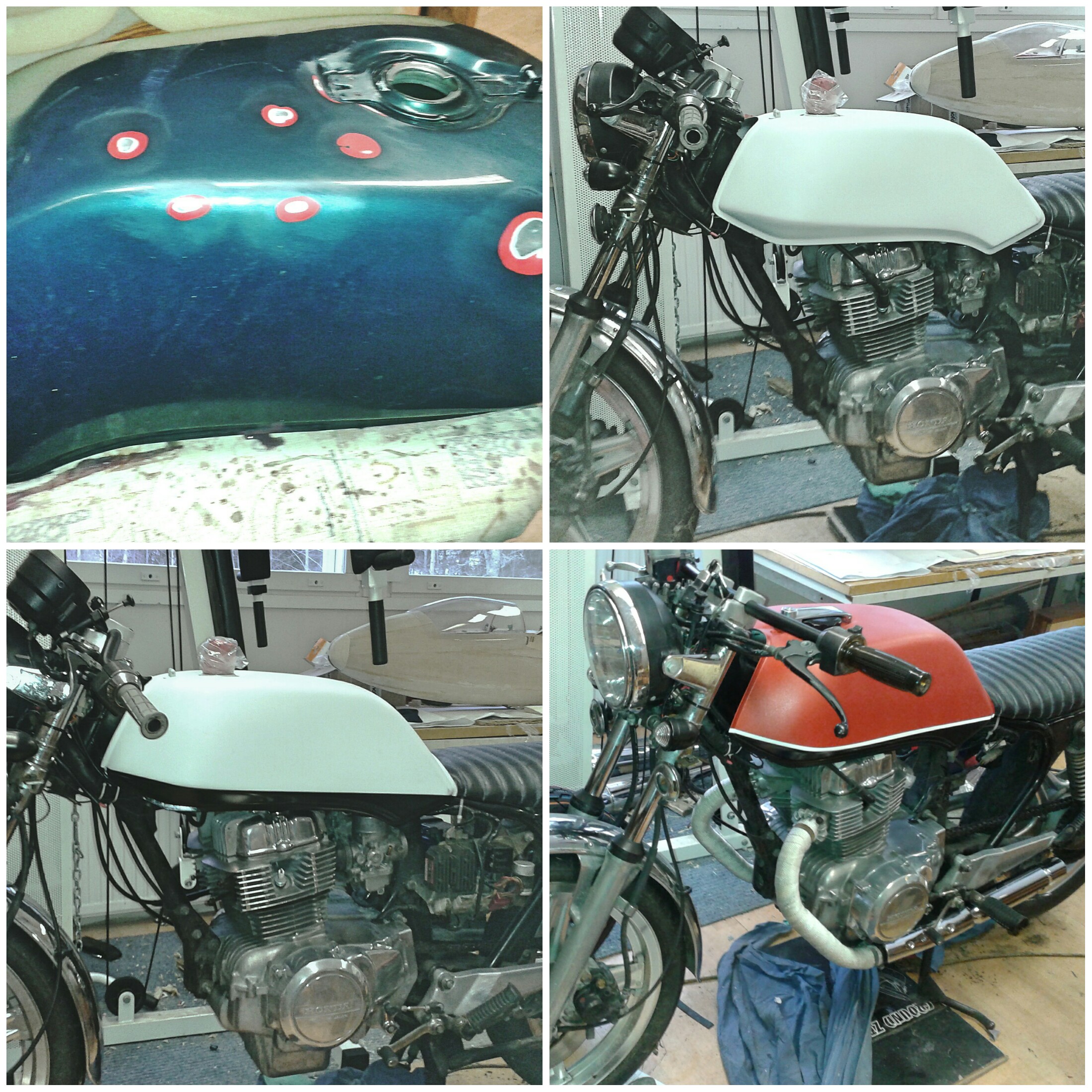

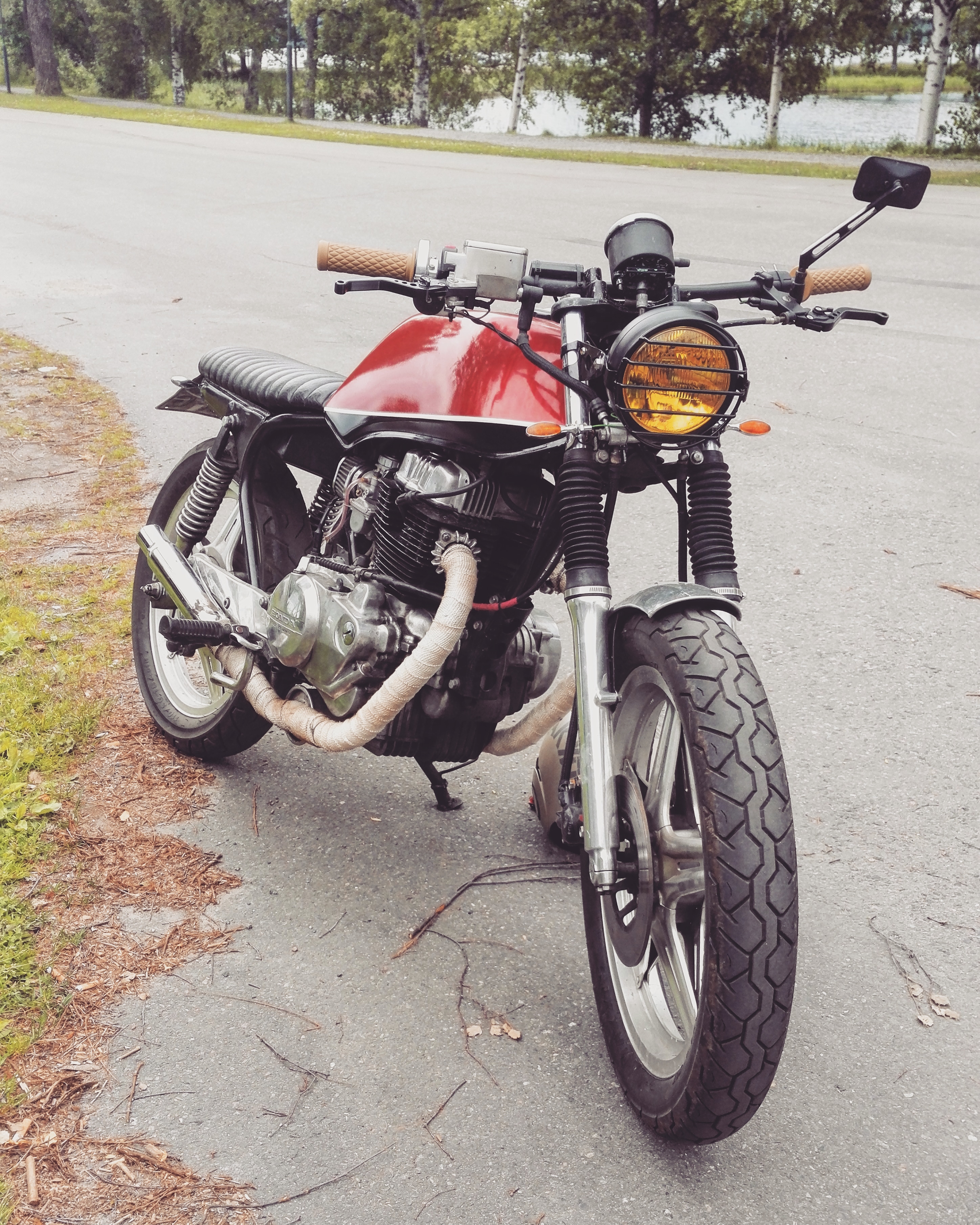

Finally, few years from the day I bought my first motorcycle honda cb 400t 1980. I rode and built it little by little. I finally felt it was ready and I like the way it looked. Carbs were finally fully synch and jets were right ones, fuel/air ratio was good. It gave good ride.

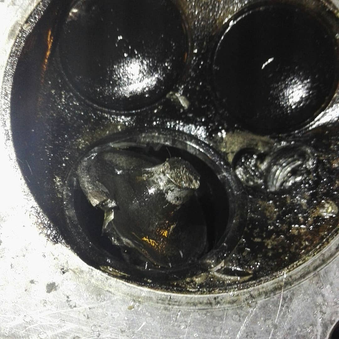

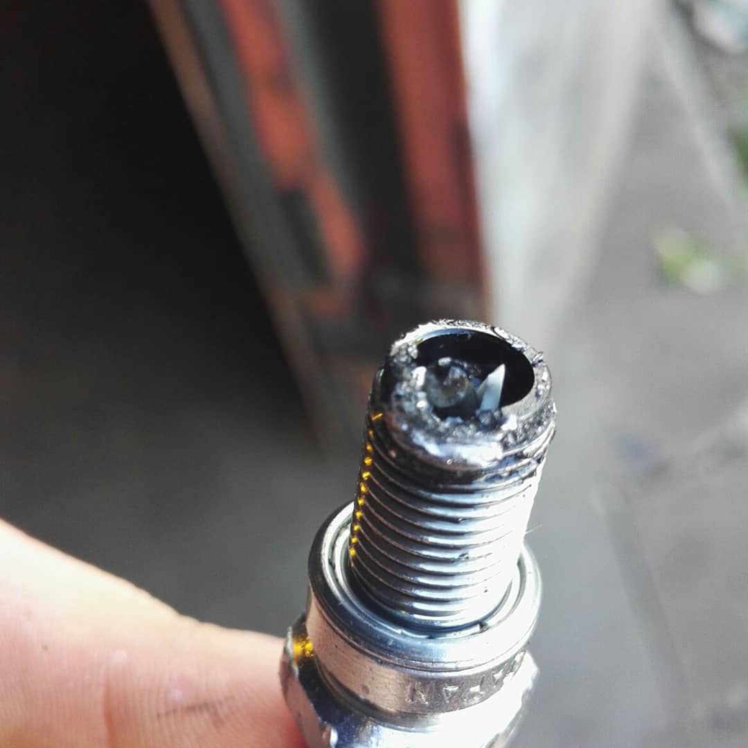

It was nice and very warm summer day. I took my cb and got cruising. I was riding on motorway and suddenly bike chocked, speed slowed down and I had to stop to side of lane. Engine idled very funny. Soon I noticed one cylinder didnt run. I thought maybe spark plug was gone. I rode to nearest gas station and tried to take the spark plug off but it was tight and I couldnt open it. I rode to my workshop and took the plug off. I was disappointed. The plug was in pieces. I took the engine apart from bike and opened it. One valve was snapped from up, and fell down to cylinder.

Thoughts after break down. The cynderhead fixable, but expensive to. New head would be hard to find. Also new pistons, and to hone cylinders wouldve been expensive.. New engine? Very hard to find because cb400t wasnt popular bike those days. Alternatives: expensive fix or new engine, and propably end of riding season, because its kind of short here in Finland.

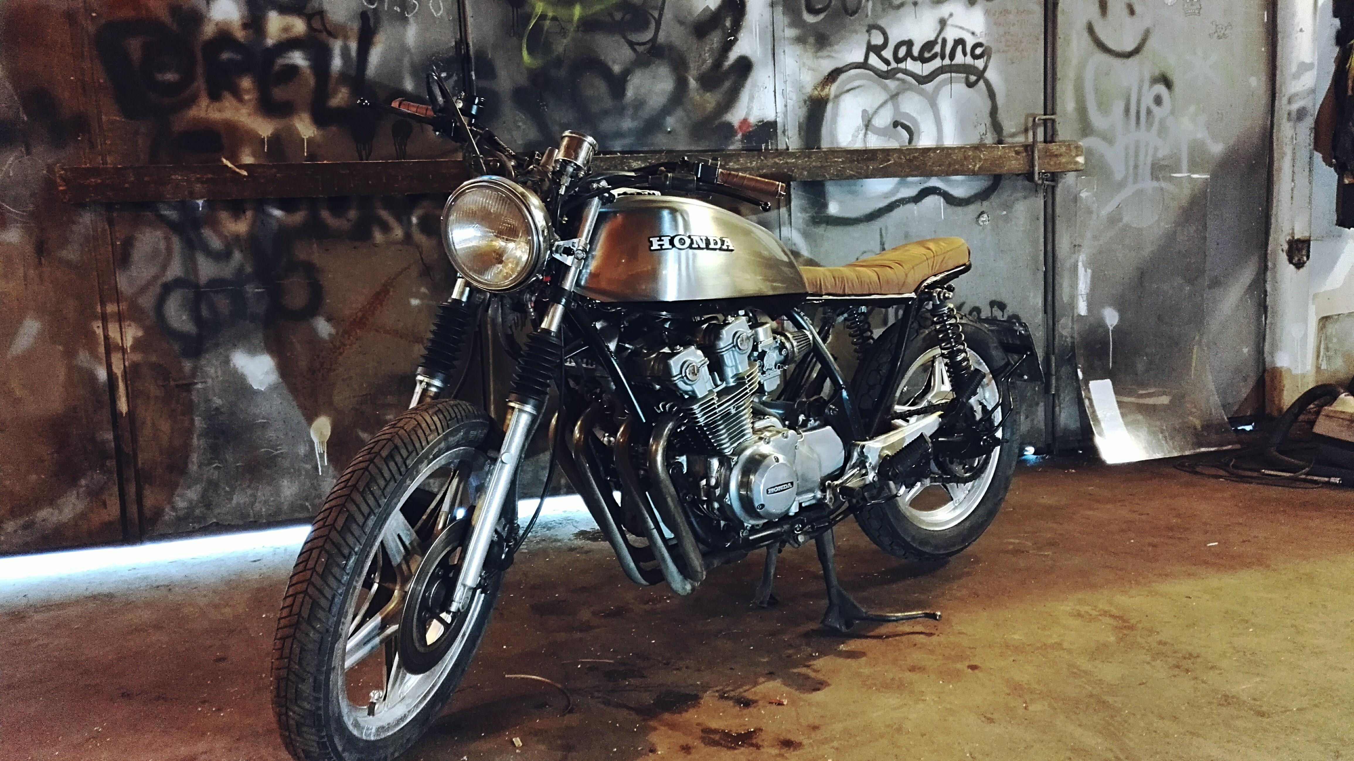

This is rise of a phoenix. Same model year, same model, but now almost double CC. Honda CB750 K 1980.

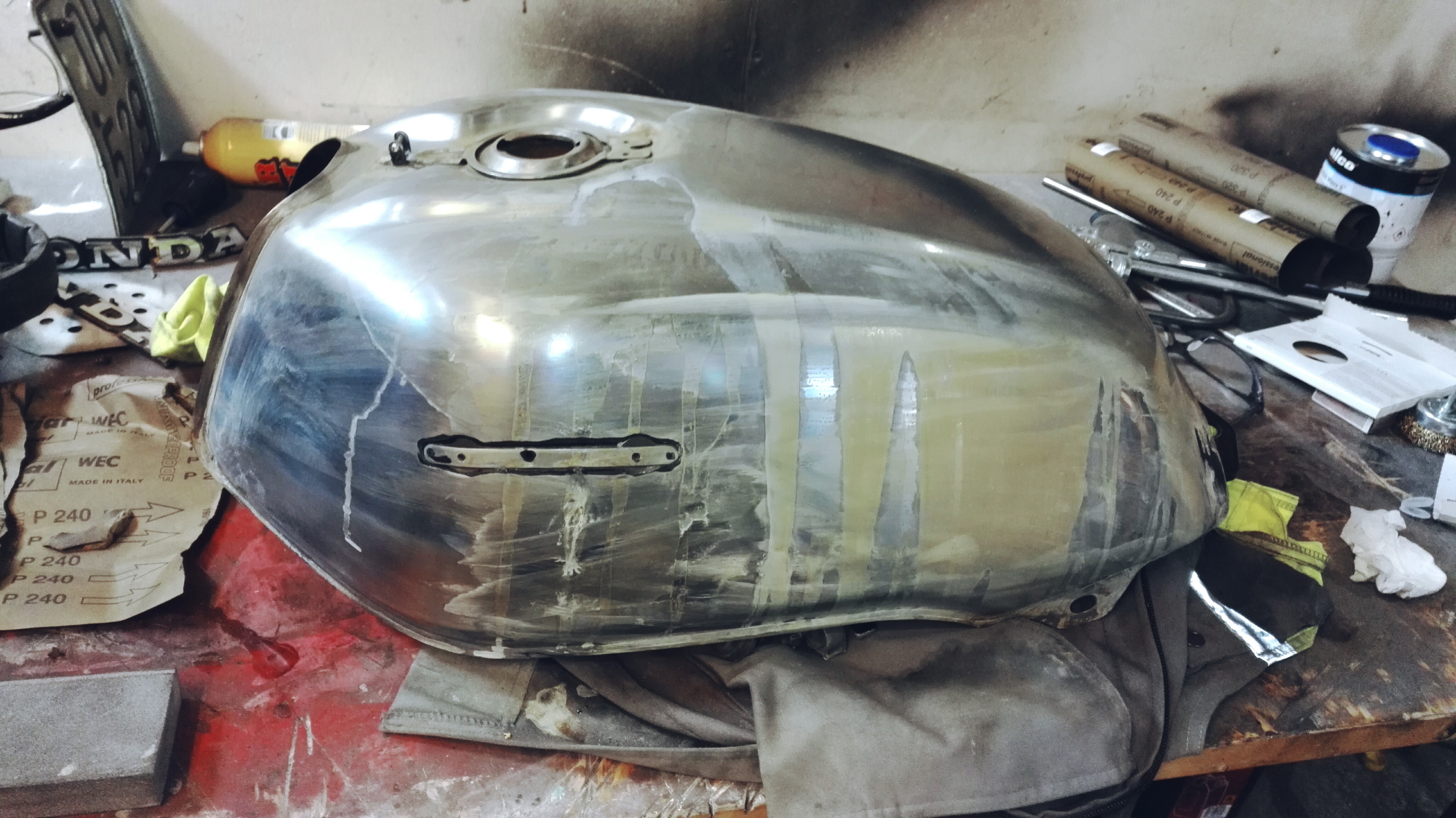

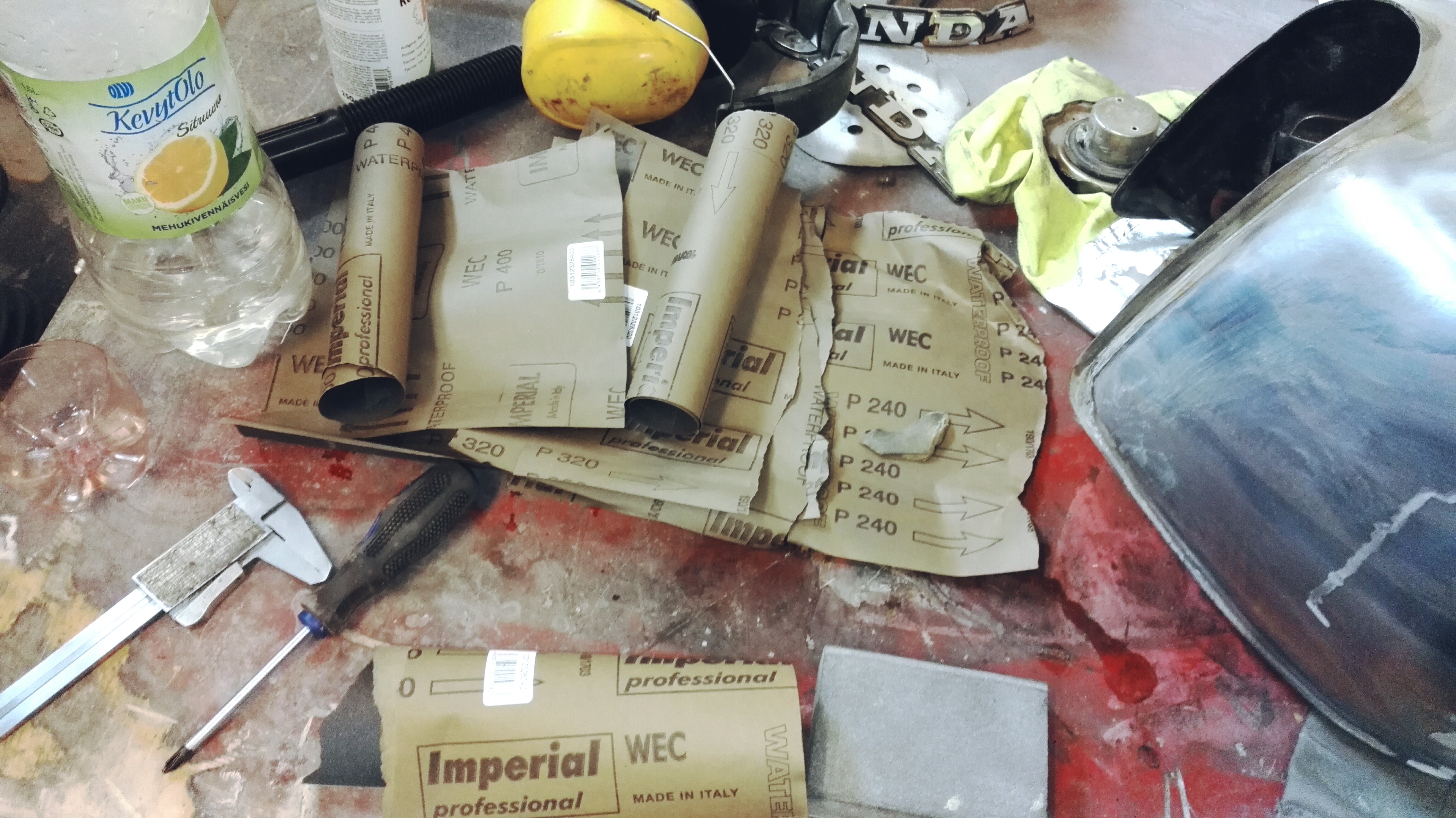

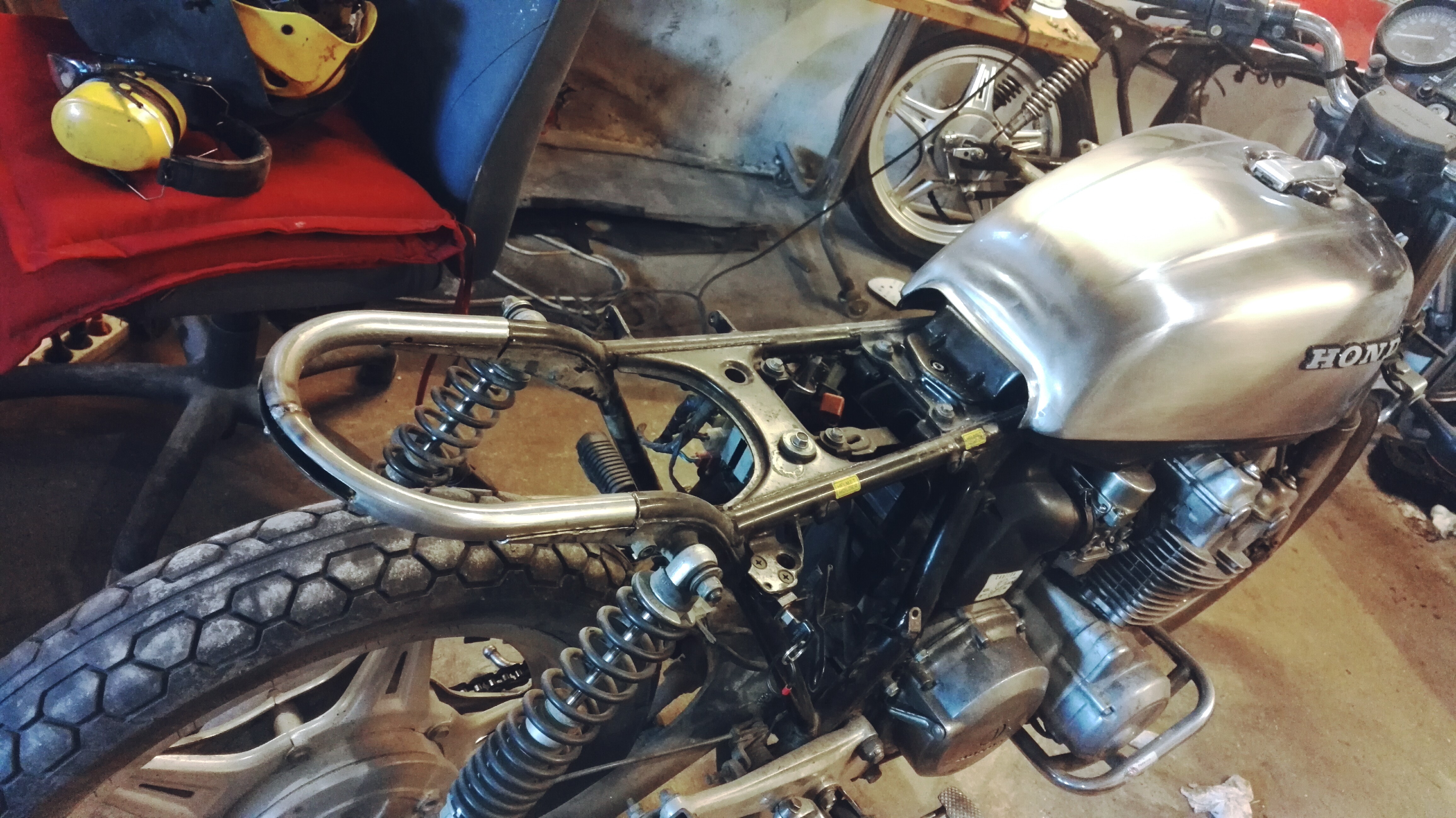

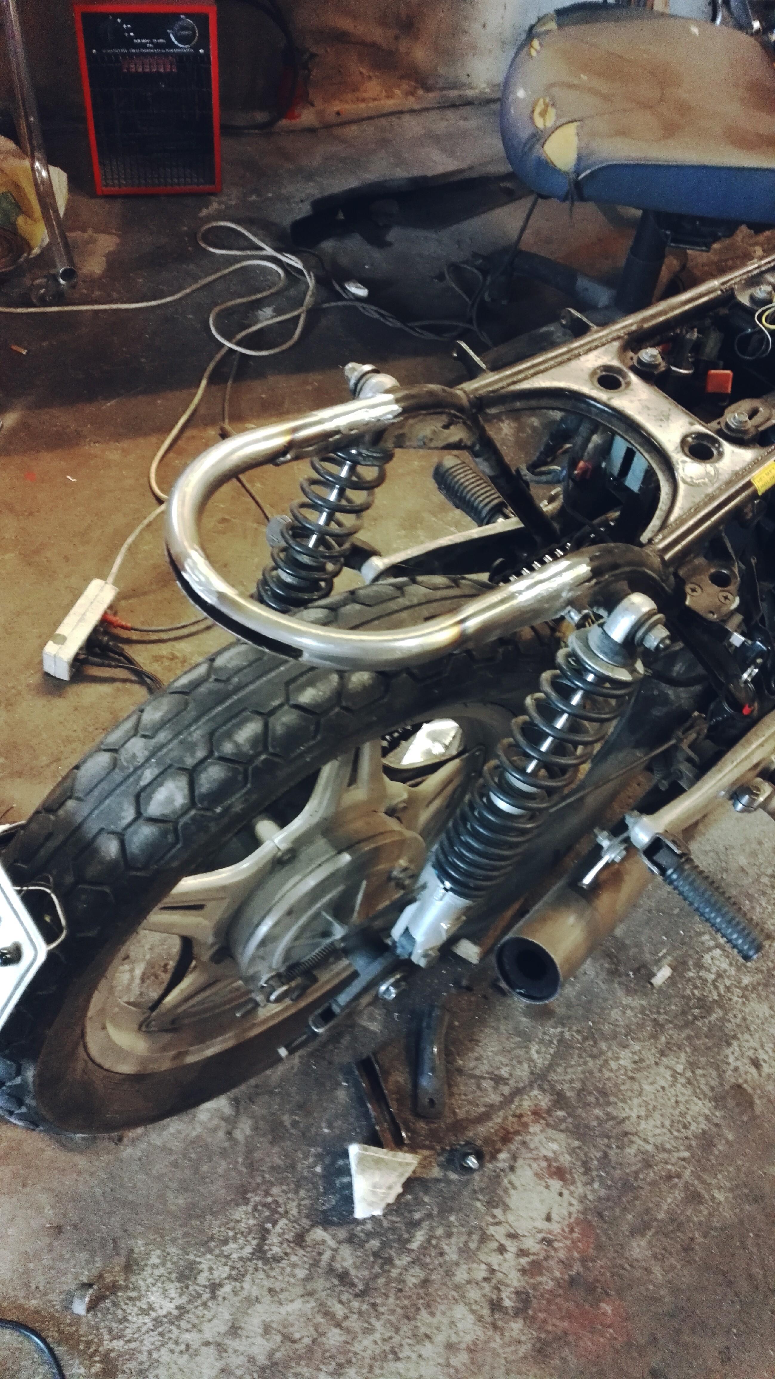

I knew pretty much what I would do to bike. I started stripping paint from gasoline the tank. I wanted bare metal tank. I sanded it with every grit from 80 to 400. I painted bottom of the tank black . I ve noticed it gives a little more round look to these later cb tanks. Then clear coat. Sanded it with 1k and 2k grit and buffed it with rotary buffing machine. Next off I worked on back frame. I ordered loop, cut frame and welded loop to bike. I wanted to integrate back light inside the loop.

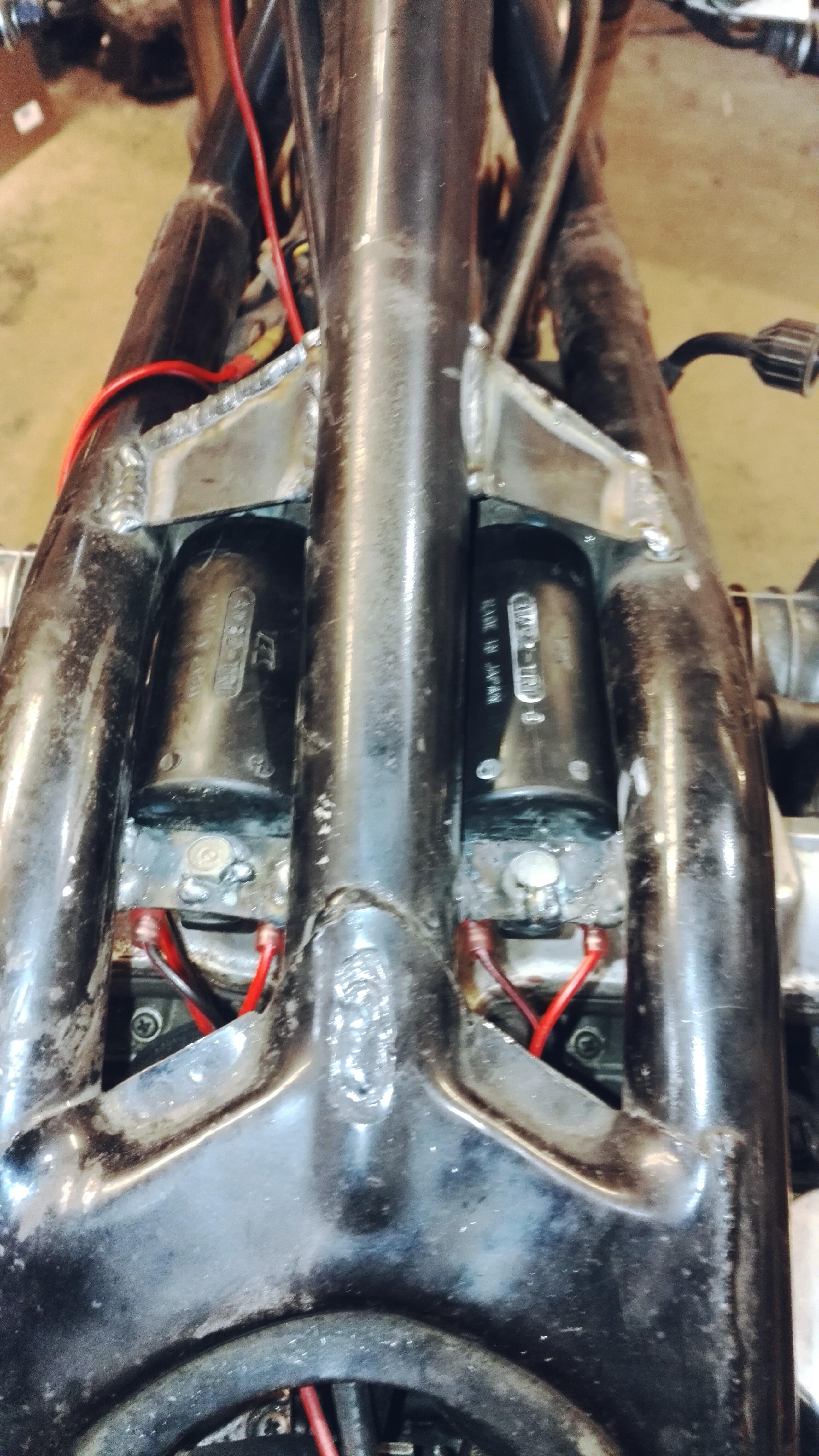

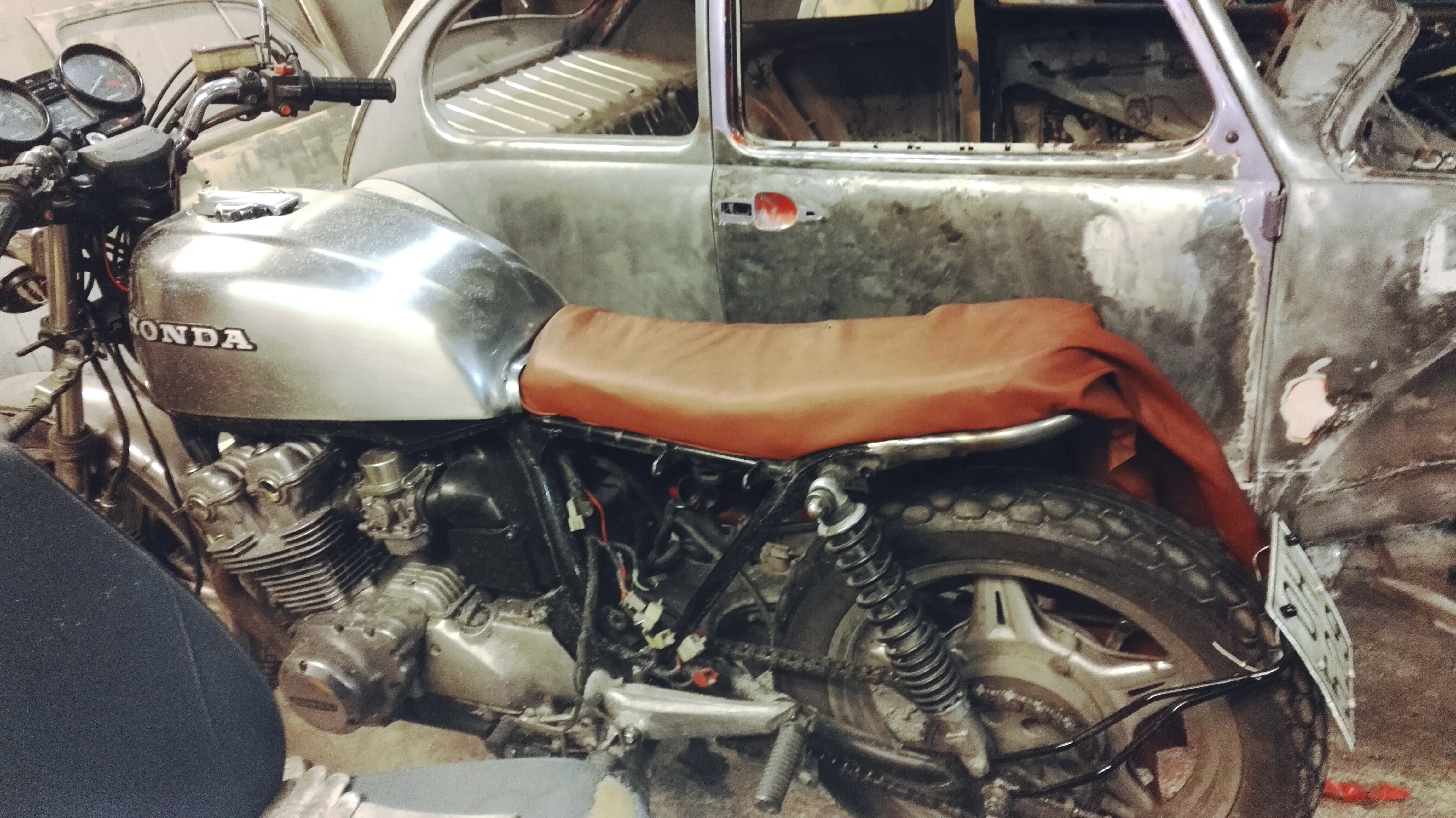

I wanted bike to be clean. The triangle had to be empty. I searched some other projects on internet and tried to figure battery placing. Most of builder has placed a battery under swing arm. I didnt like idea at all. I started sketcing and got it. The battery fits good under the gas tank if coils moved a bit. Also starter relay fits there. So triangle was empty now. Seat skething started. I wanted leather, brown. Kind of flat seat but long enough for two if needed.

Soething little changes happened. I got new handle bar, washed bike, put temporary cloth to seat. Also made licence plate mount.

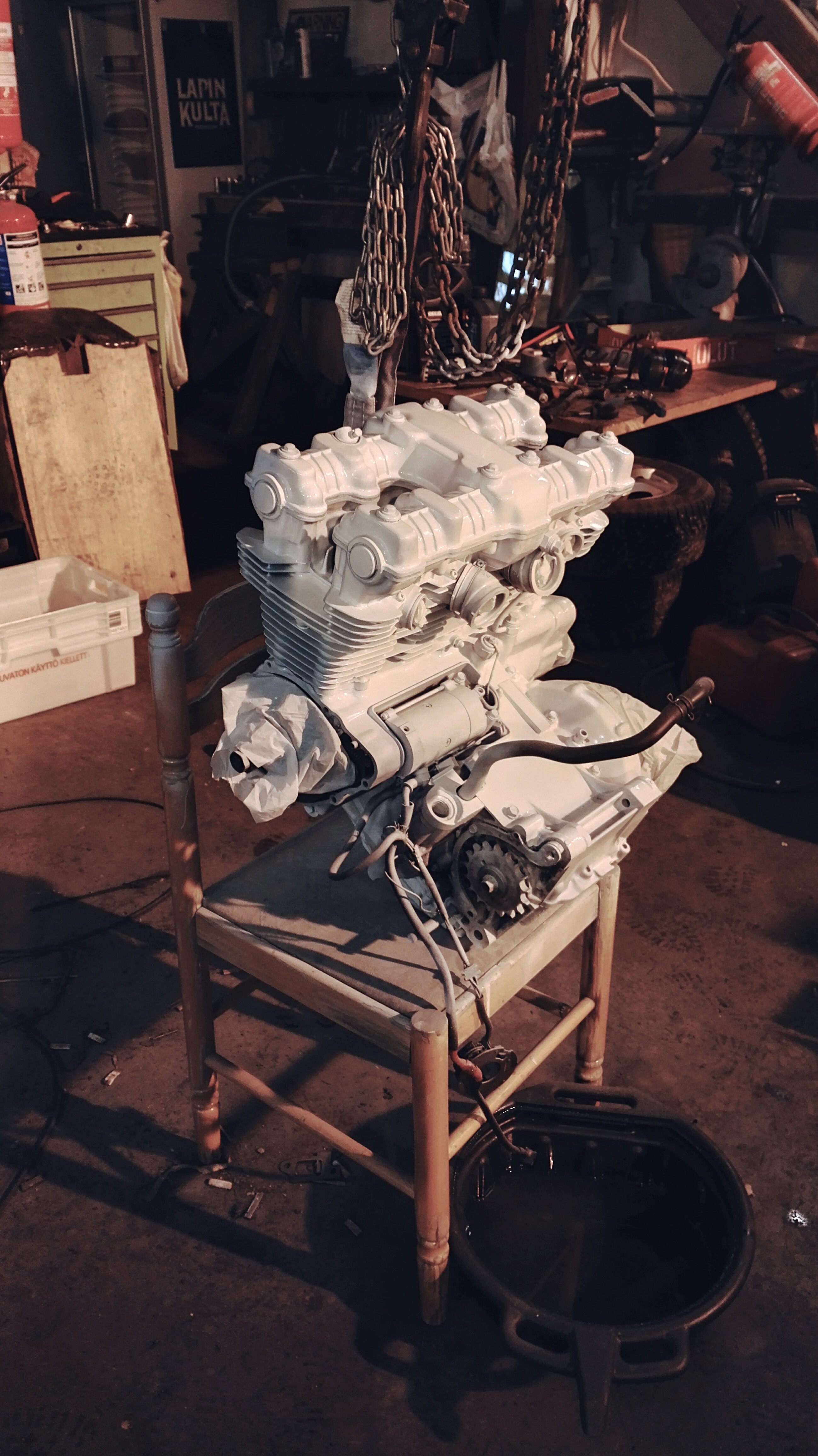

I started by cleaning, washing and soda blasting the engine. Sprayed with VHT and it turned nice. I buffed side covers too.

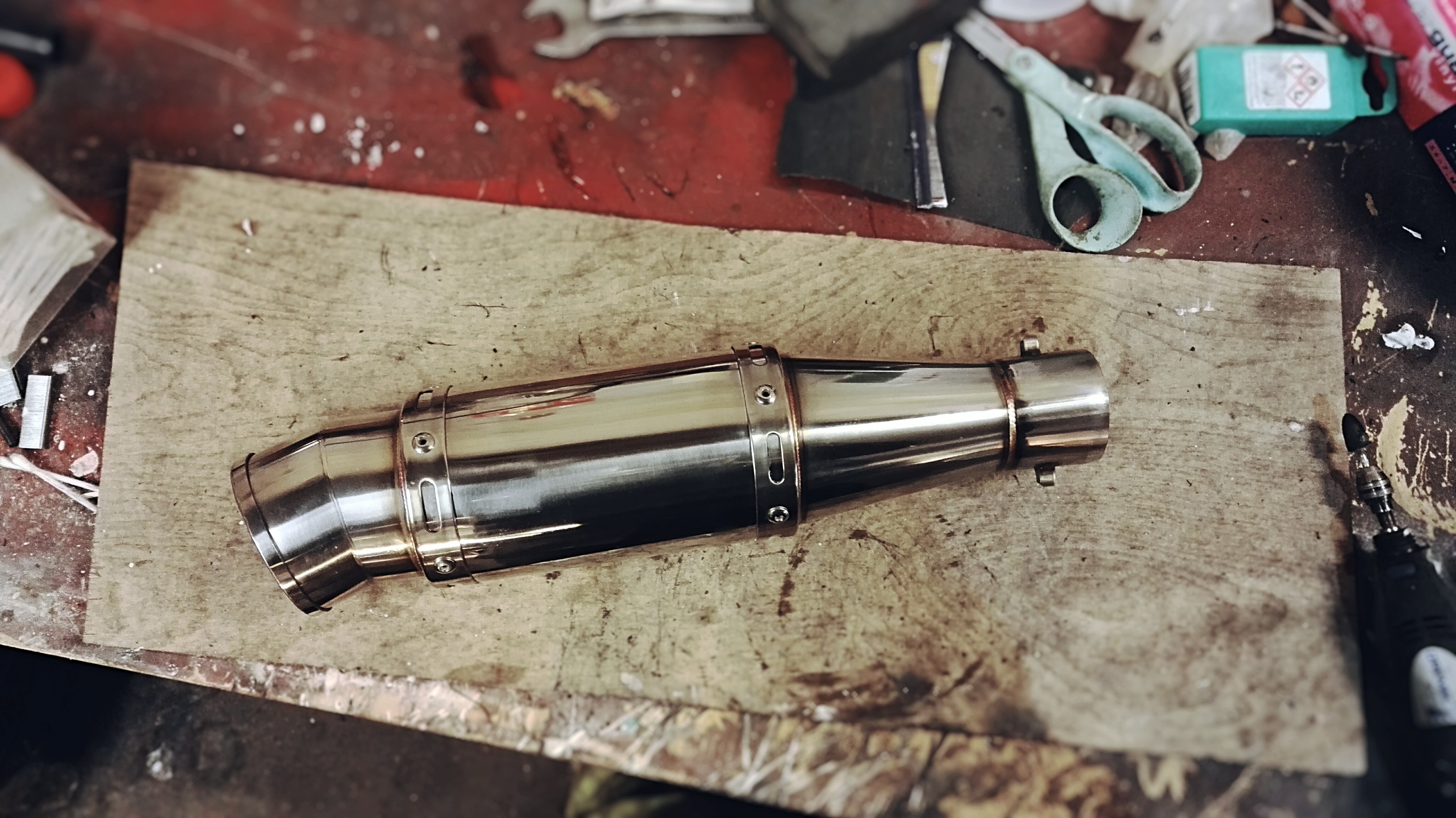

Wasnt satisfied with header so ordered new one. I like classic cone and hod dog headers but to this bike I wantded something else.

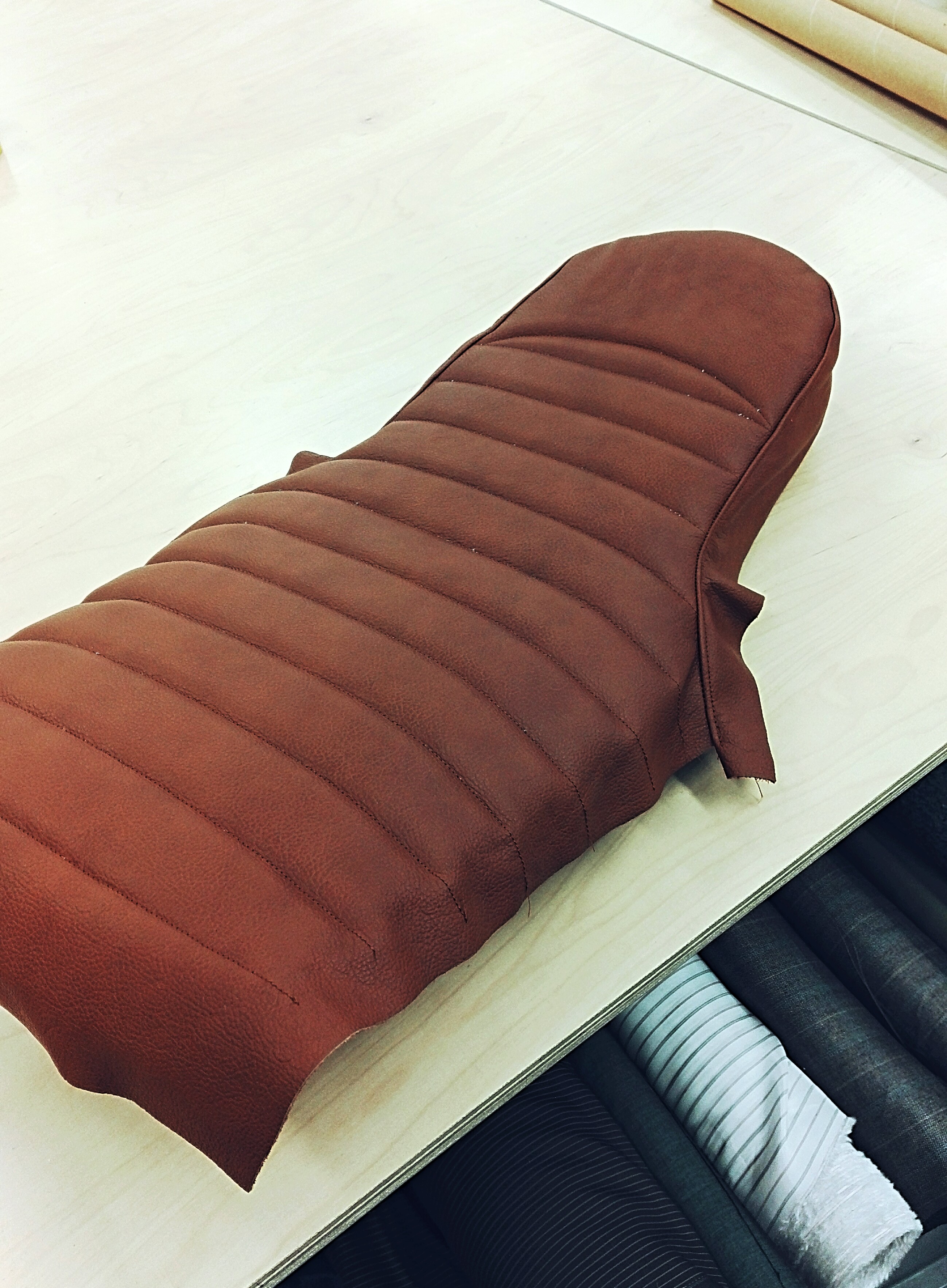

Meanwhile I upholstered my seat. I dont do much these things but id like to. I found it very enjoyable to do upholstery.
