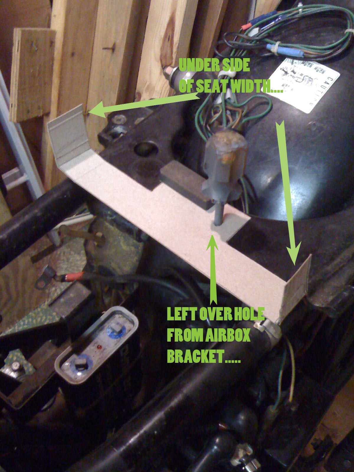

As for the bracket....... ALWAYS make a cardboard templet........ (ahh dah)........... Heres the one Im going with the 1st set up sucked......
Sorry this was kinda rushed, no rest for the wicked an all that shit..............
