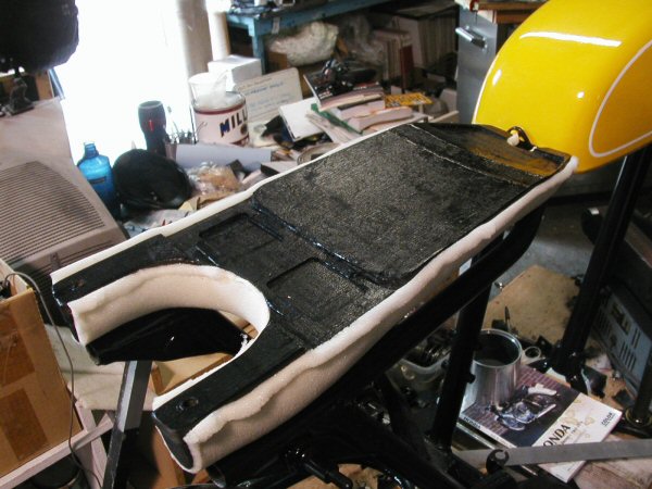

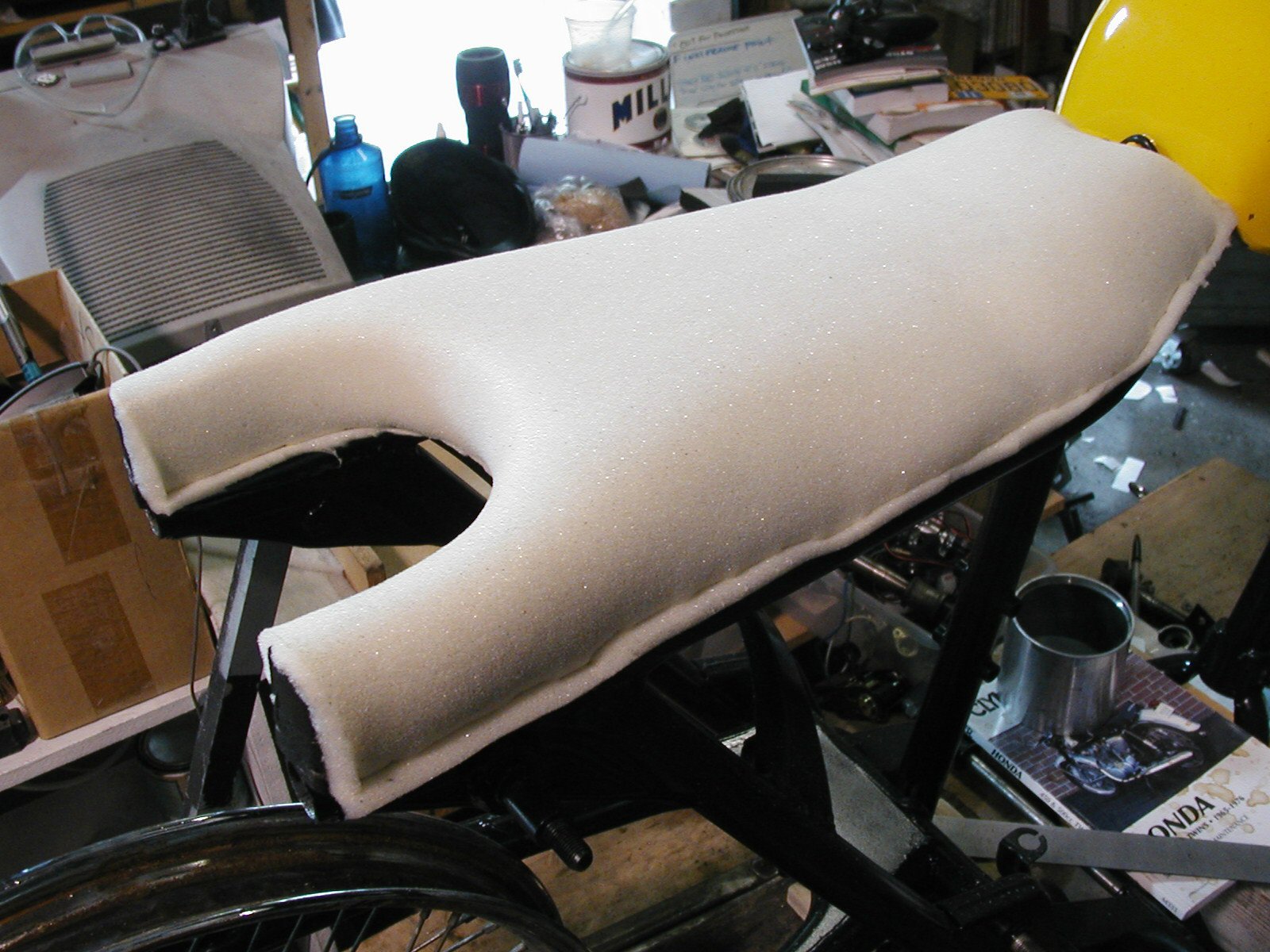

How to build a seat that hurts your ass.......
Well kids, it's time for another installment.....seat time!
First I made a pattern and traced that to some curved wood I had from a dead office chair. Then it was pocketed to fit a few features on the frame and the whole shebang was glued together with Gorilla wood glue....damn is that stuff strong. The buck was then shaped using sharp sticks and broken stones.
The pics aren't perfectly in sequence, after I cut the pad out and tested it's fit I coated the whole thing it KwikPoly mixed with black dye. It's really thin and soaks into the wood for the first few coats. Once it sets up it's really strong, more or less impervious to chemicals and is kinda smooth and shiny.
Once that was done and stuck the pad on and started shaping with a flap wheel and draped a piece of 1/4" open cell over the black race foam.
The unfortunate truth is, while I've used the black stuff for ages on race bikes and cafe seats.....for whatever reason this seat is really uncomfortable so we'll call this practice for the next one....
