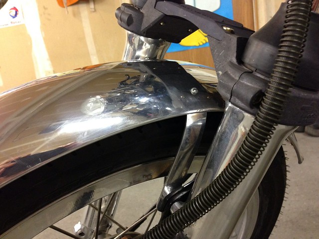

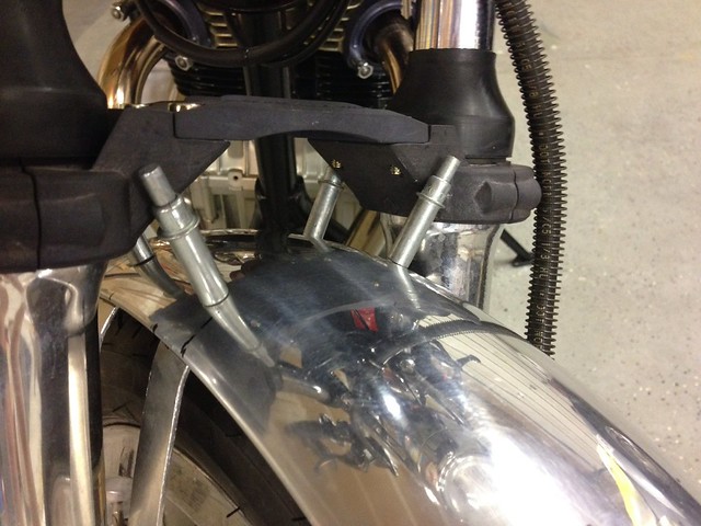

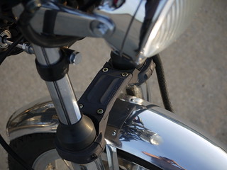

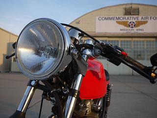

Well it's only taken a month for me to get my ass in gear to finish the fender mount. I've been riding the bike a bit and it seems just fine.
I ditched the stock steel fender bracket and made my own out of some 6061-T6 aluminum sheet. I used the old bracket as a pattern and mocked everything up with clecos. It's polished just like the fender and seems to fit real nicely.
Fender is finally mounted by Matthias Salzburg, on Flickr
