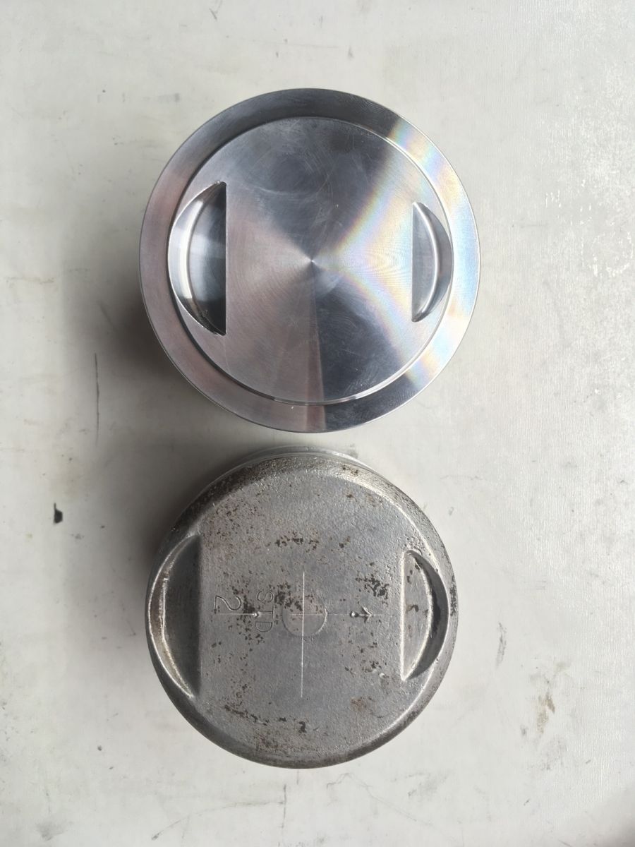

getting a move on this. I decided to bite the bullet and get some custom JE pistons in 86mm bore. this will put the bike at 906cc. If you would like to get in on a limited run of pistons and sleeves let me know soon as I will be pulling the trigger on this in the near future.

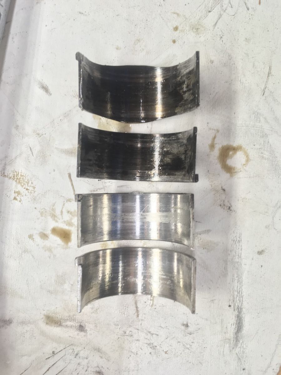

I have dismantled the engine, I cleaned everything and carefully inspected the combustion chambers, pistons, and spark plug sand have found zero evidence of detonation. However I did find the cause of the ringing/ticking sound... no.2 rod bearing is completely shot. more scrutiny is required.
Also... New JE pistons! dropping them off at LA sleeve tomorrow to bore the cylinders. The increase in bore has done two positive things. One, it has created a squishband, and two it has allowed for a very flat piston design, while maintaining a 10/1 compression ratio. now that i have the pistons in hand the rest of the build can proceed.

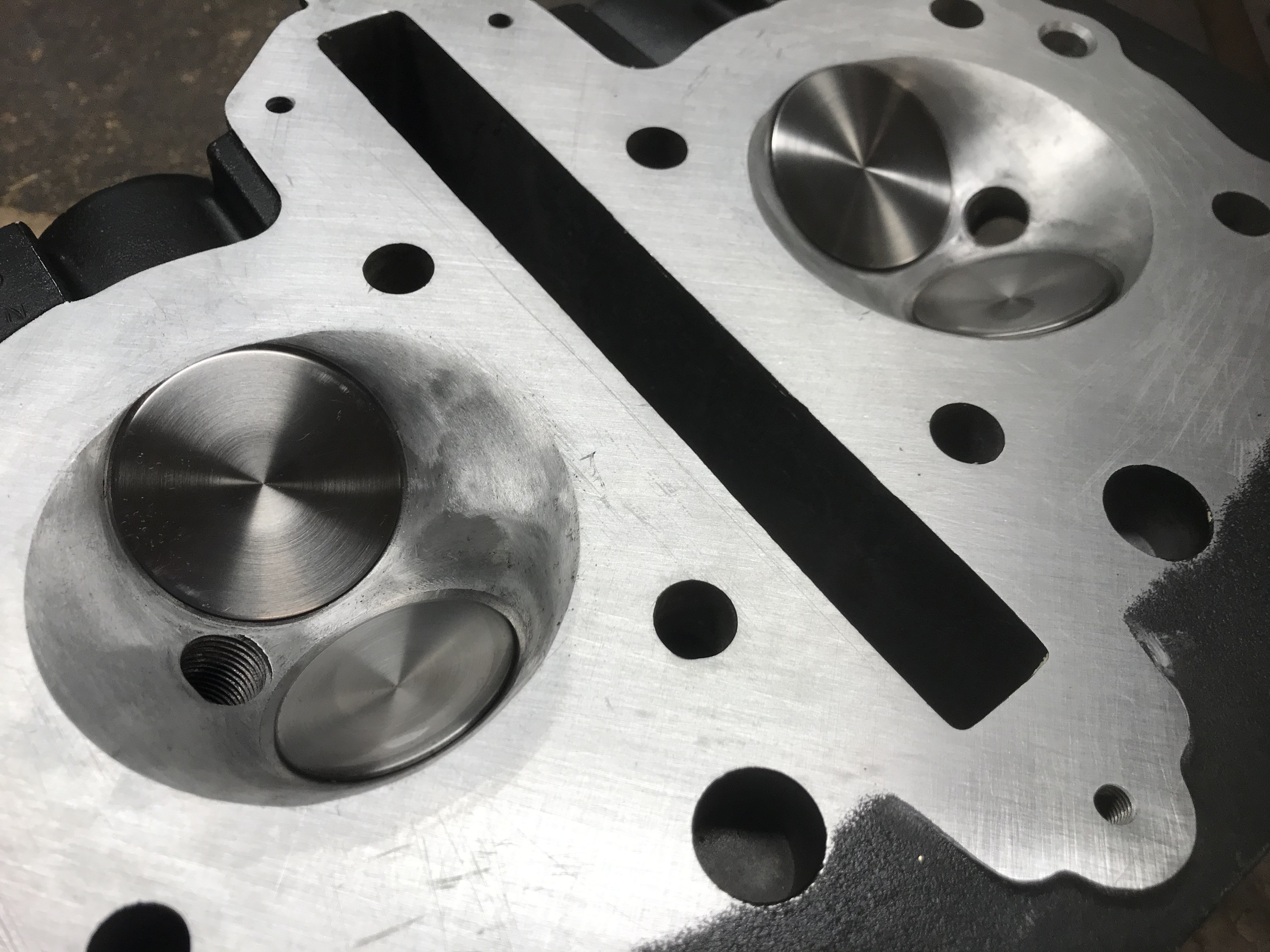

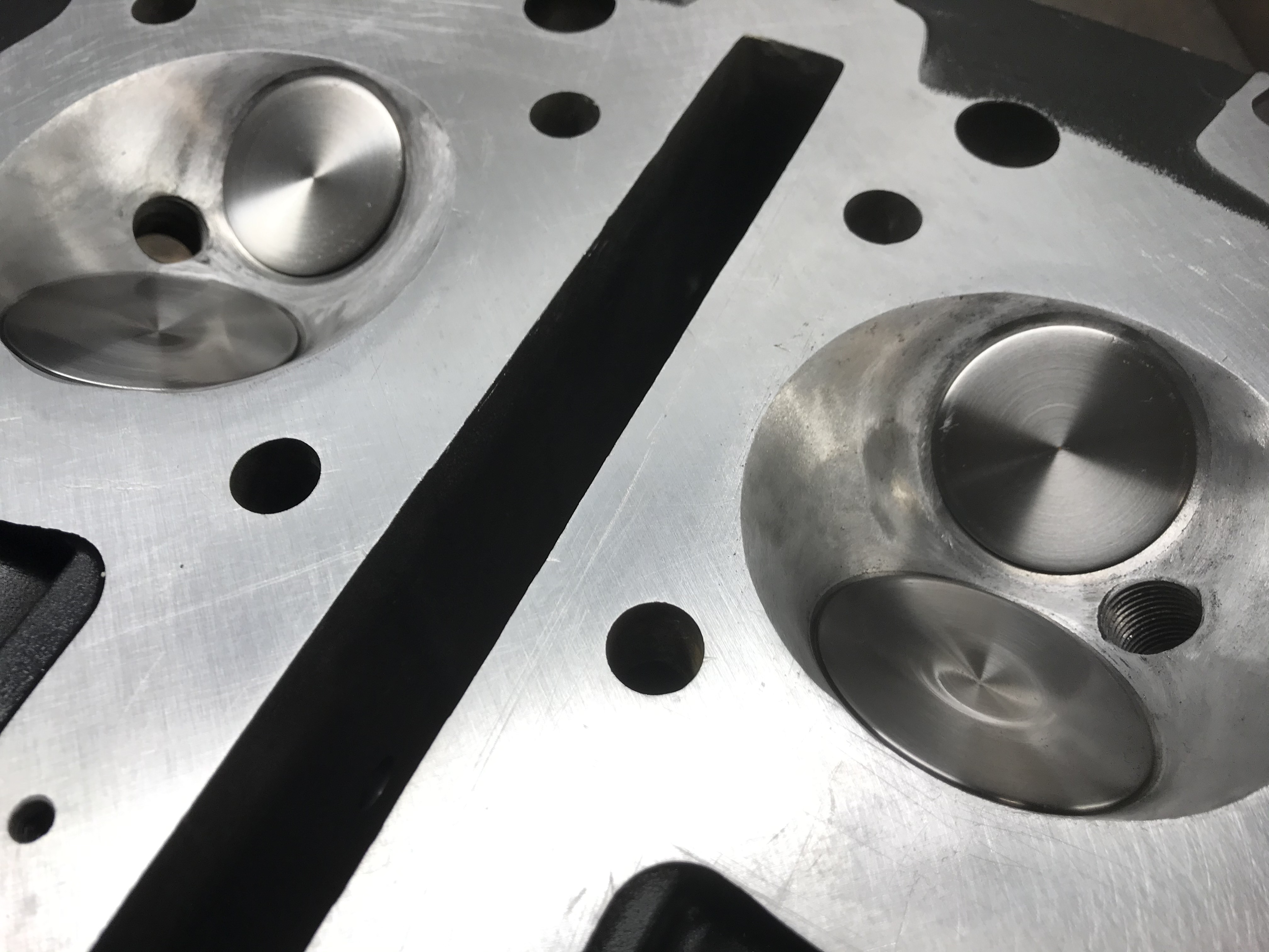

Just got a sneak peak from Chris at Schumann Motor Works. He is making his top of the line custom valve train, complete with titanium valves (1mm bigger on intake) custom bronze valve guides (reduces the valve stem diameter from 8mm to 7 mm), beehive springs, and titanium retainers. He is also doing some porting to blend out the bigger intake valve. This was way more than I initially reached out to him for, but he called me up saying hes stuck in his house with the "Shelter in place" measures, so for a small increase in cost he is giving the cylinder head the full treatment! This program just got kicked up a notch. This may be the only KZ750 twin in the world with titanium valves.
The latest cylinder head porno from the machinist 380EFA6B-E4A5-4D1A-8940-3F7A4289F798.jpeg15B2630F-EF71-4560-A4AE-0240482E4ADB.jpeg6520CB94-EED7-4A27-887F-B0CBCDED3D50.jpeg2ADA010A-1B83-460B-81F1-CB2881477C9E.jpeg
