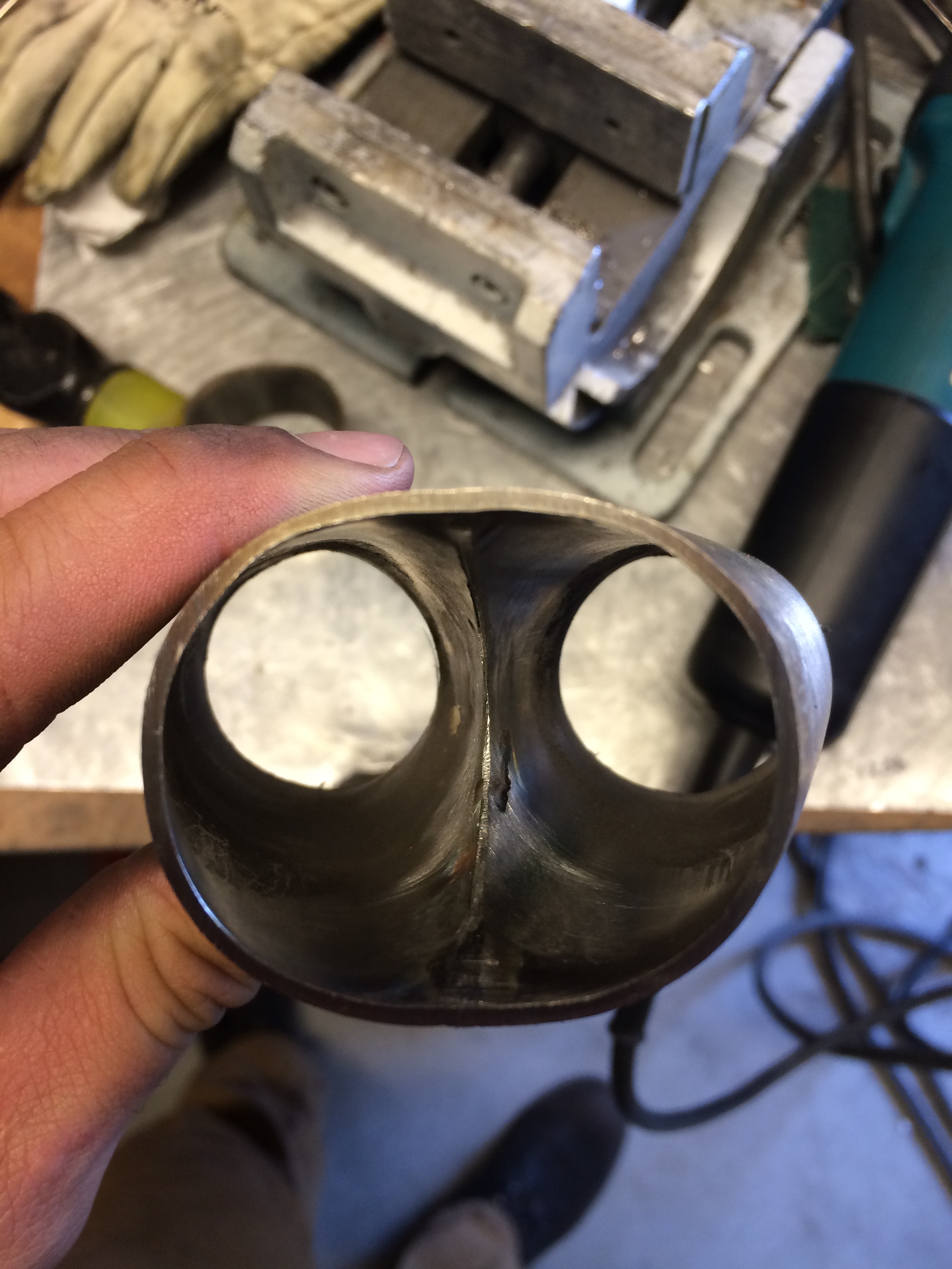

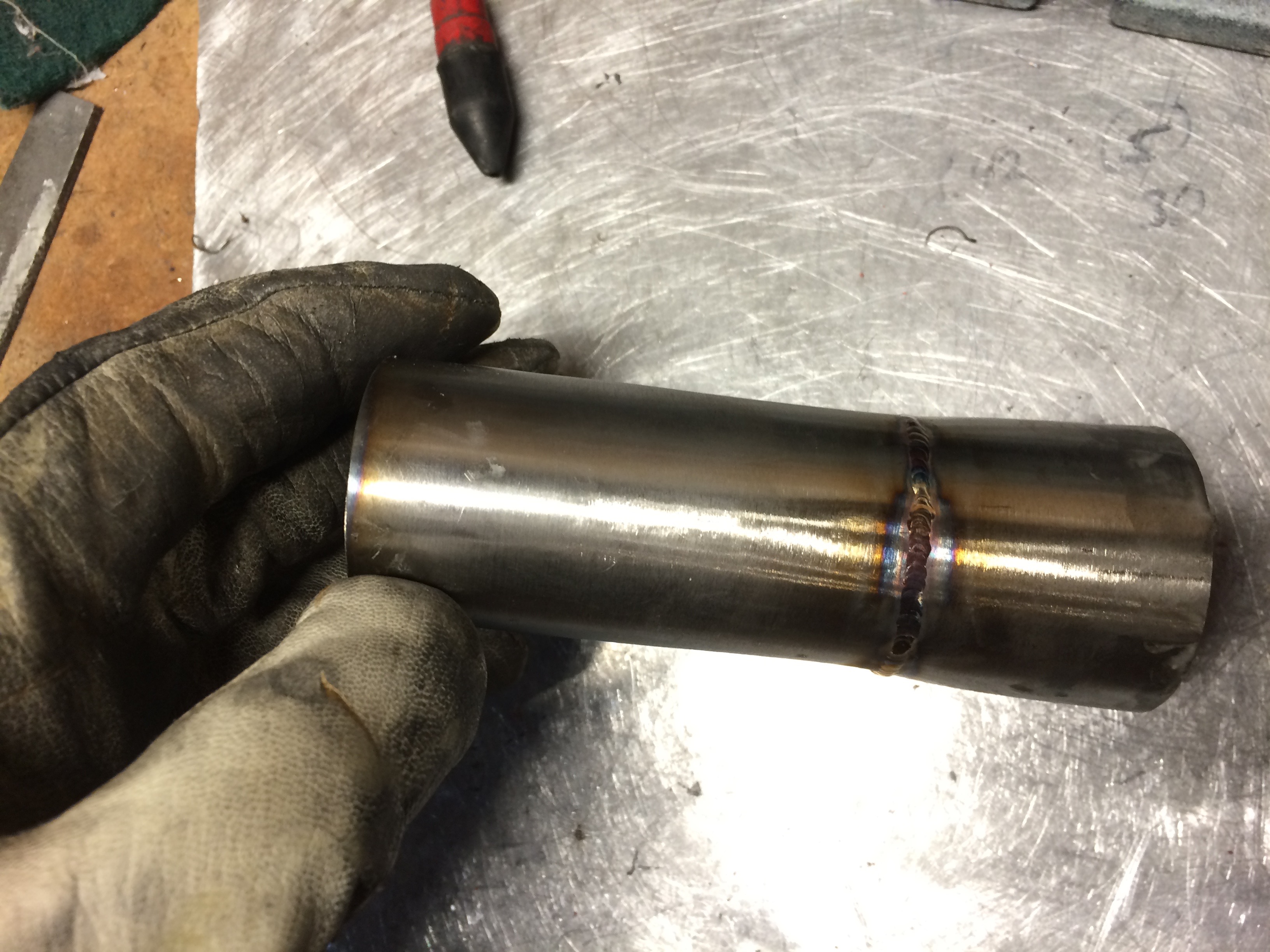

My buddy Eric thought 2" would be too big for the collector so I dropped that down to 1.875". This meant there were no cheap collectors to be bought so i had a go at making my own.

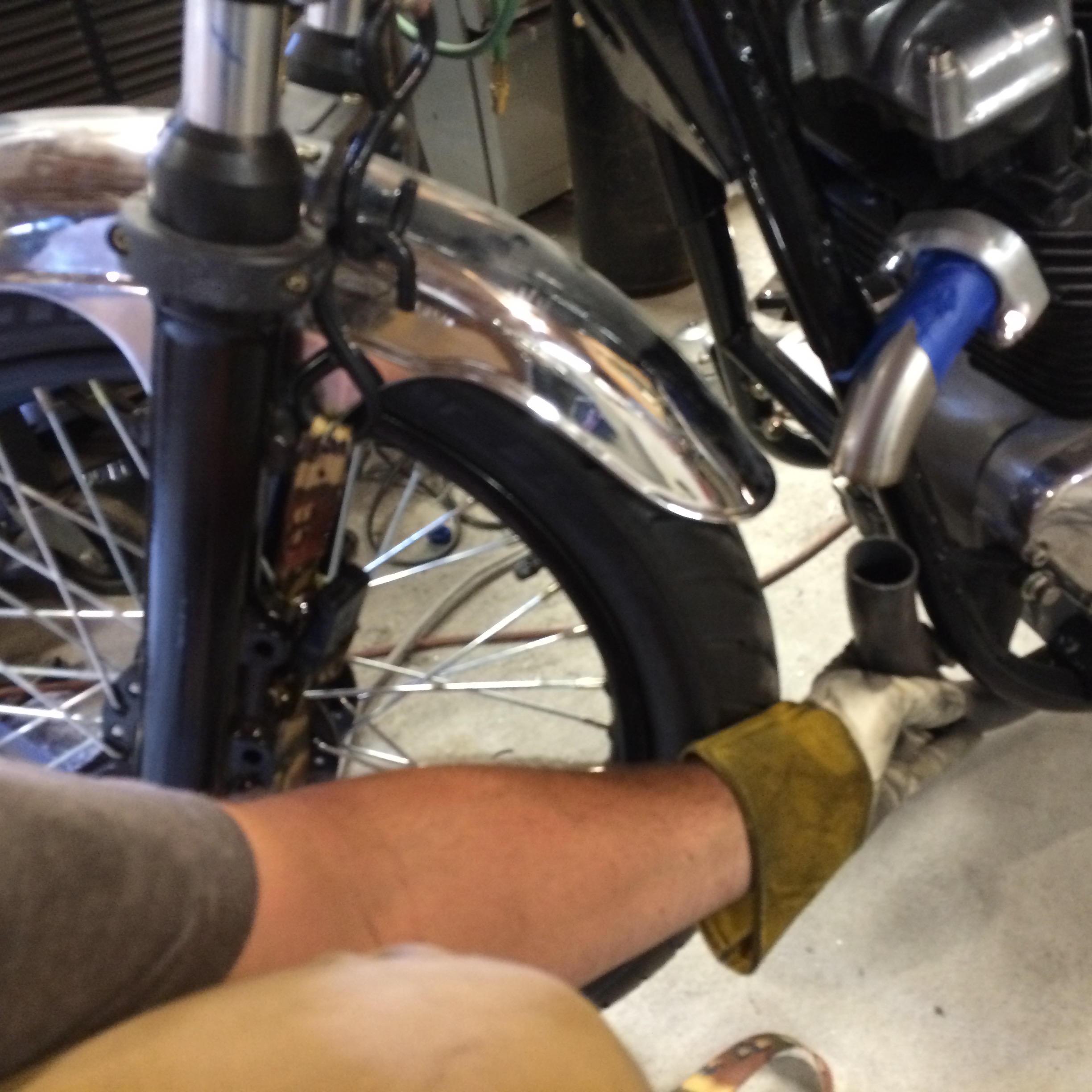

I hammered open the ends of the primaries and then faced them on the disk sander before welding them together to try and keep stress out of the welds. It still took a good amount of bashing after to get it to fit up.I also ovaled the big tube slightly to help out the transition. I was super shaky welding this up for some reason so the welds arent my best, I probably should have done some practice beads first to get in the groove but you will never see these welds when the pipe is on the bike, so whatever. I also compressed the fork to make sure there would be plenty of clearance. next up is sand bending the second bends.

Nice work on the collector. I used a 2-1 collector from cone eng on the 360 headers and they neglected to tell me about the little triangle filler pieces. I ended up welding it to the headers once, removing it and rewarding between the two header pipes from the inside since it was impossible to fill the voids. I'll just make my own next time.
