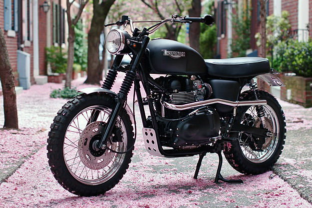

I have a change of heart with my CL350. I was thinking about doing the Cafe thing with it but after
riding it for awhile, I kinda like it as a scrambler.
The Chen Shin tires I have got to go .... so I am looking for new tires. I am embracing the Triumph Scrambler
style and want something that I could use for the occasional burn up some fire roads.
What would you recommend? I guess I am looking for 80% street/20% off-road
