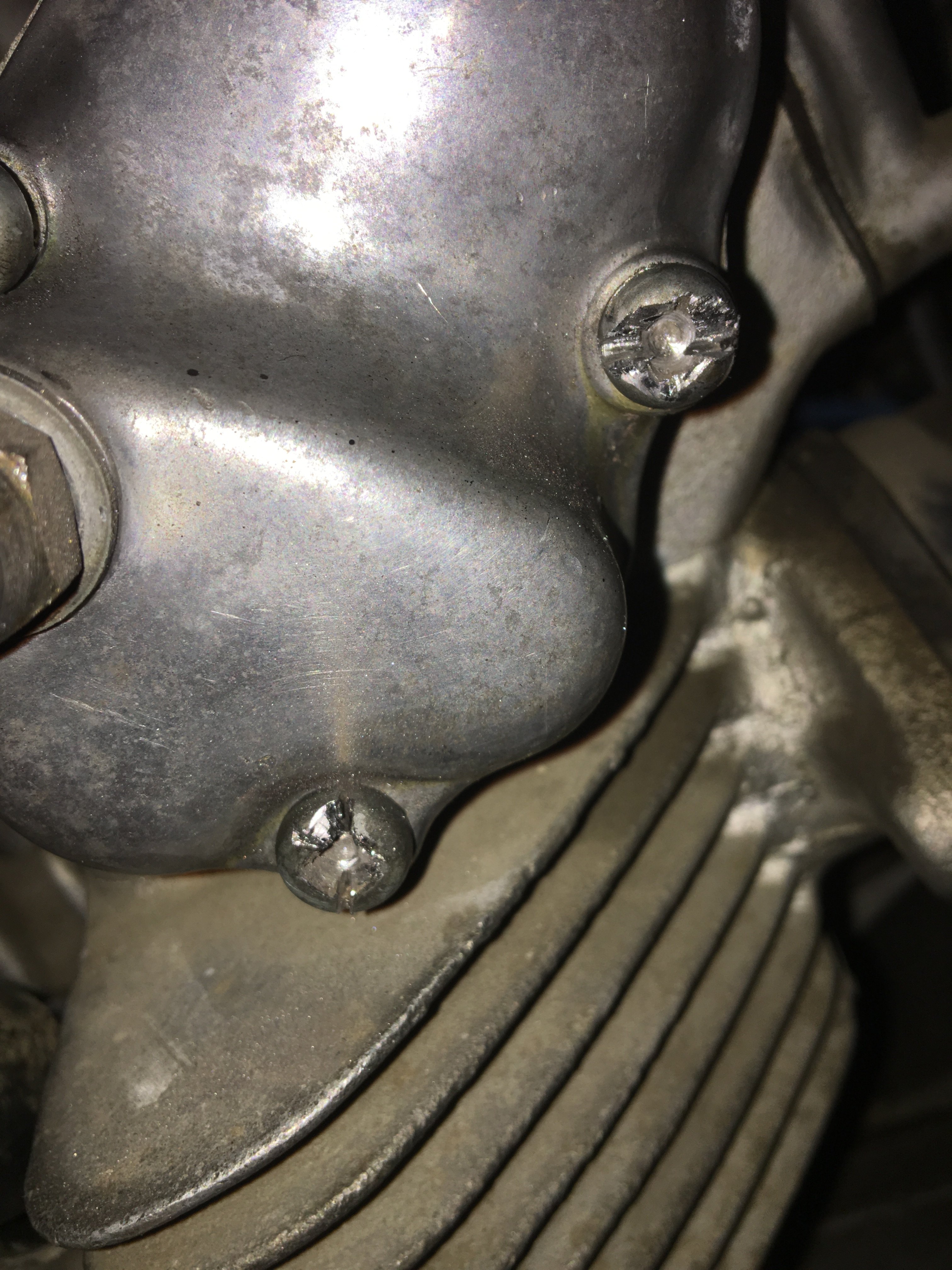

So I'm trying to remove the covers to adjust the valves on a 72 CB450 for the first time on this bike and the screws are fubar. I made sure to use the correct sized screw driver and a few of the screws are really brittle and cracked/stripped.
I've tried cutting a slice with a dremel tool so I can unscrew with a big flathead screwdriver, but the screws are like butter.
Does anyone know a way to remove these screws?
Impact driver
https://upload.wikimedia.org/wikipedia/commons/thumb/4/40/ImpactDriverWithBits.png/1200px-ImpactDriverWithBits.png
Its a necessity
Awesome! I borrowed my neighbors impact driver kit and it worked! Thanks!
