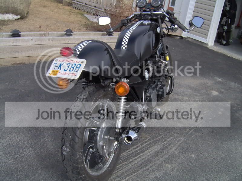

Latest progress on the bike - FINALLY got the turn signals installed. Unfortunately the relay I ordered was a dud - so I'm considering other options now.
But they suuure look a hell of alot better!
Before:
After:
And the rear....
Before:
After:
And from the side:
New shocks from a sporty - havent riden it yet... I assume it's gonna be a rough ride - bike is now lowered an inch all around.

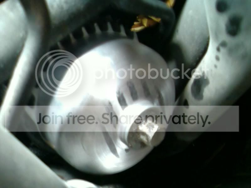

Anyway, I have always hated that my aftermarket 4-1 was so close to the oil filter cover... and a recent fight between the header and a curb (with a passenger on the back) forced me to take "drastic" measures... Plus I had an extra oil filter cover around.
Took the oil filter cover in to school and threw it on to the lathe (I'm allowed in there now), and this is what I came up with:
Damn... that's dirty...
Other than that, Whattya think?
Before you ask... Yes, I removed the cooling fins, and No, I'm not worried about overheating. My bike has an additional oil cooler (and a temp warning light) AND I live in Newfoundland. ;)
