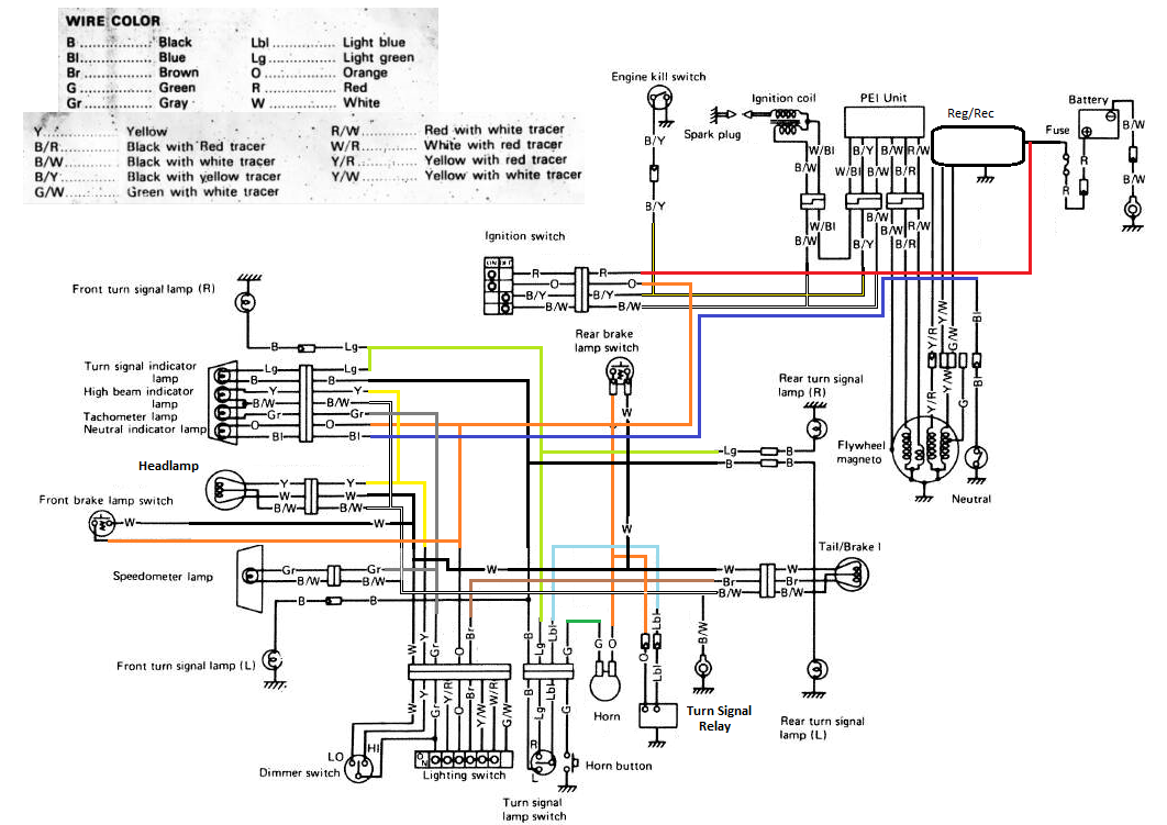

Ok so I am looking at swapping my TS185 electrical system over to 12v, from what I understand if I replace the Reg and Rec with a modern 12v combo I should be right.
I have drawn up this simple diagram in hopes it can be checked over and more electrical inclined minds can tell me if it will work or not.
I am going to leave the ignition system as 6v as the TS has no need for a battery to run, it is purely for lighting.
Anyway here is what I have come up with

Here is the original diagram.
