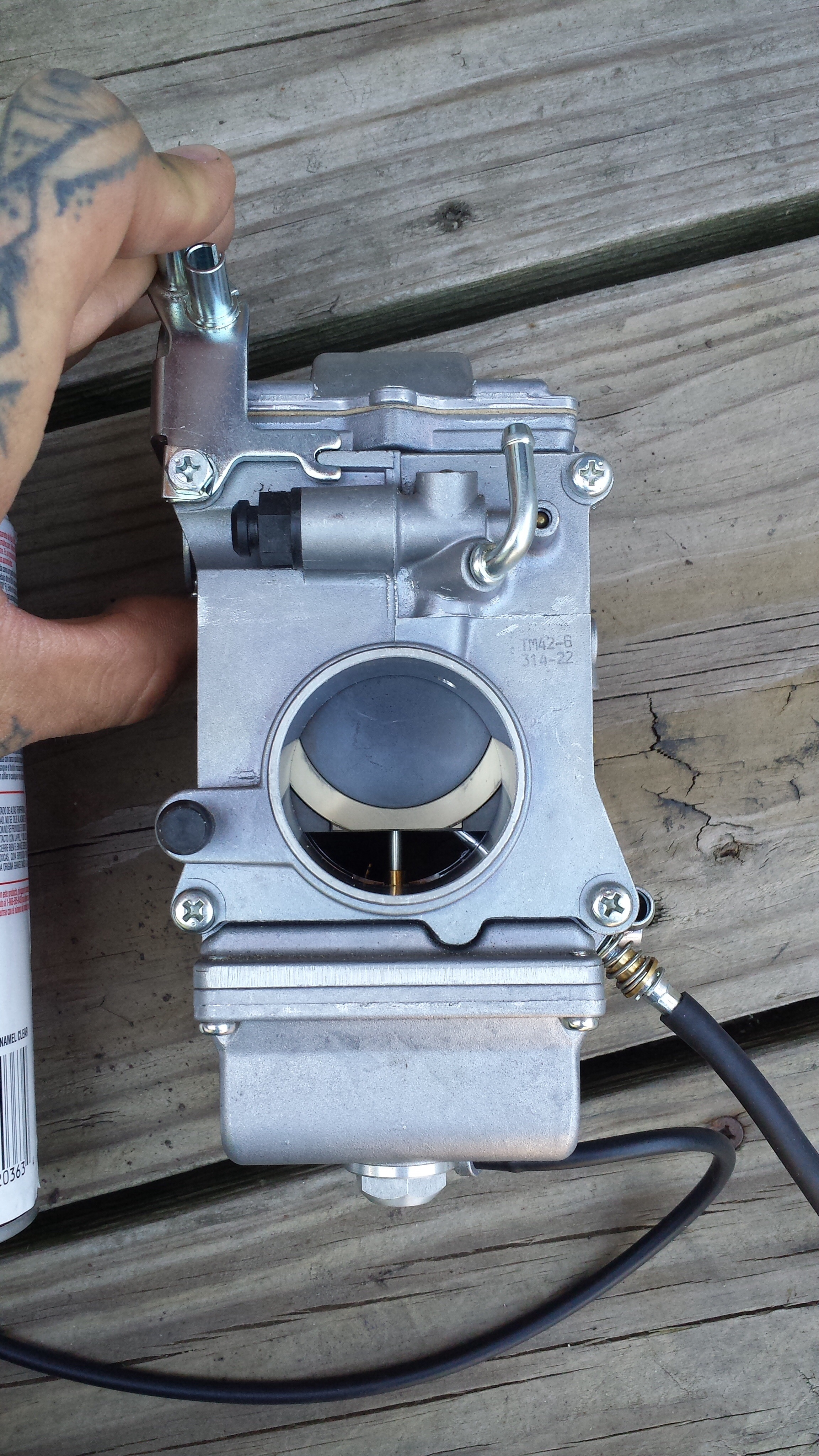

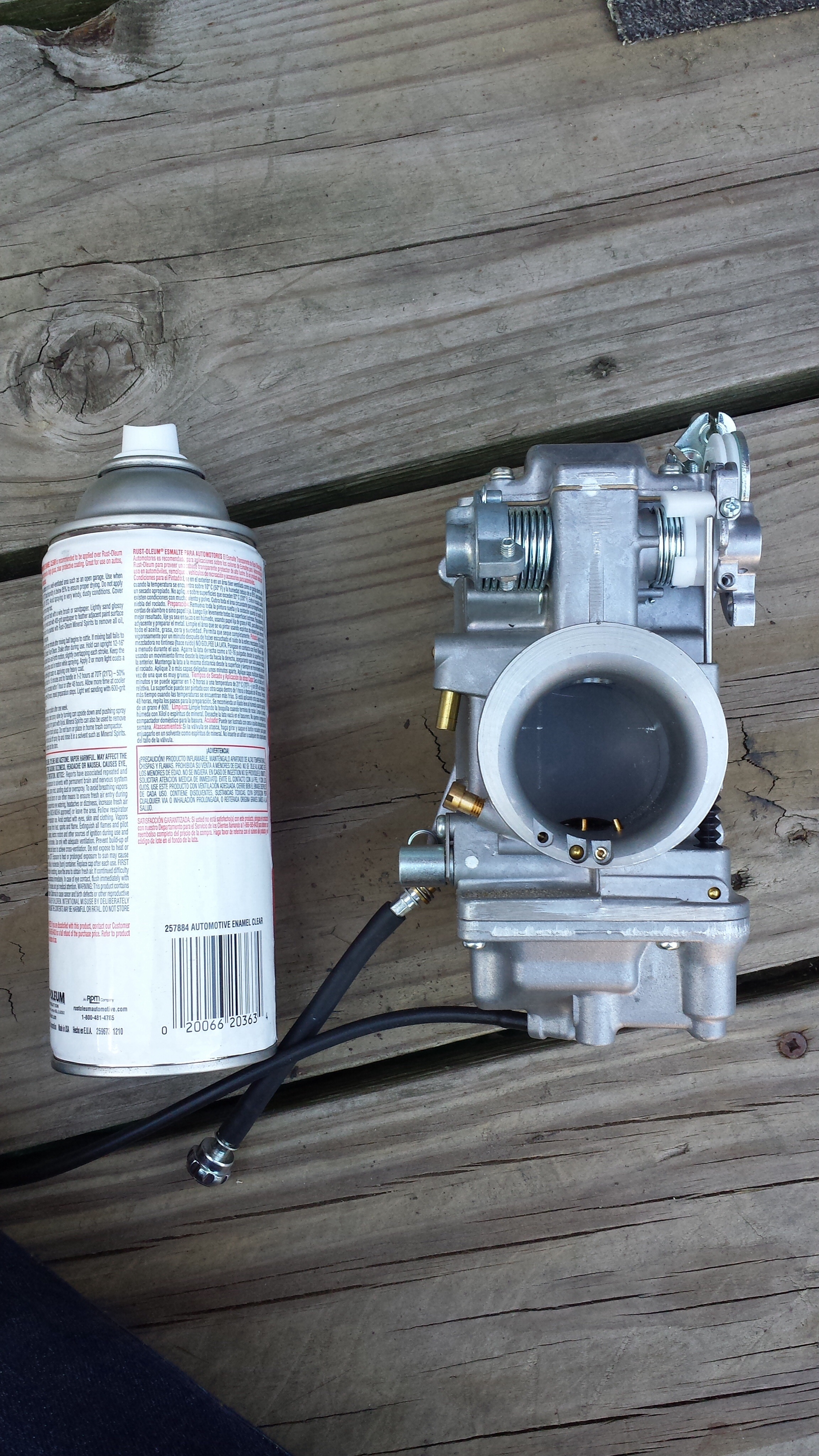

I think I'm going to run a suck through set up with a hsr42 flat slide Mikuni. That way I won't have to modify the floats for a high boost set up. It will also help atomization of the fuel.
Here is the Mikuni

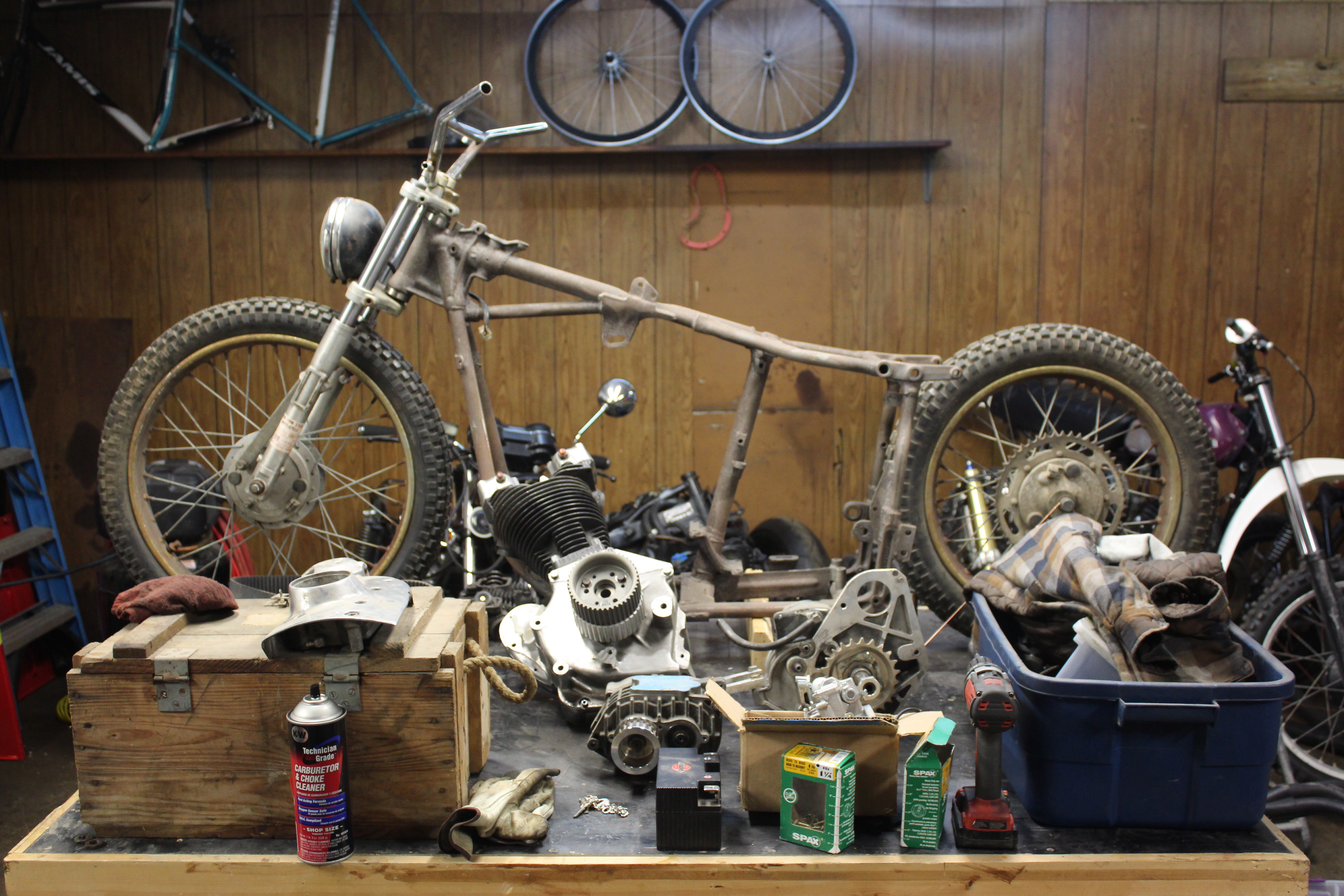

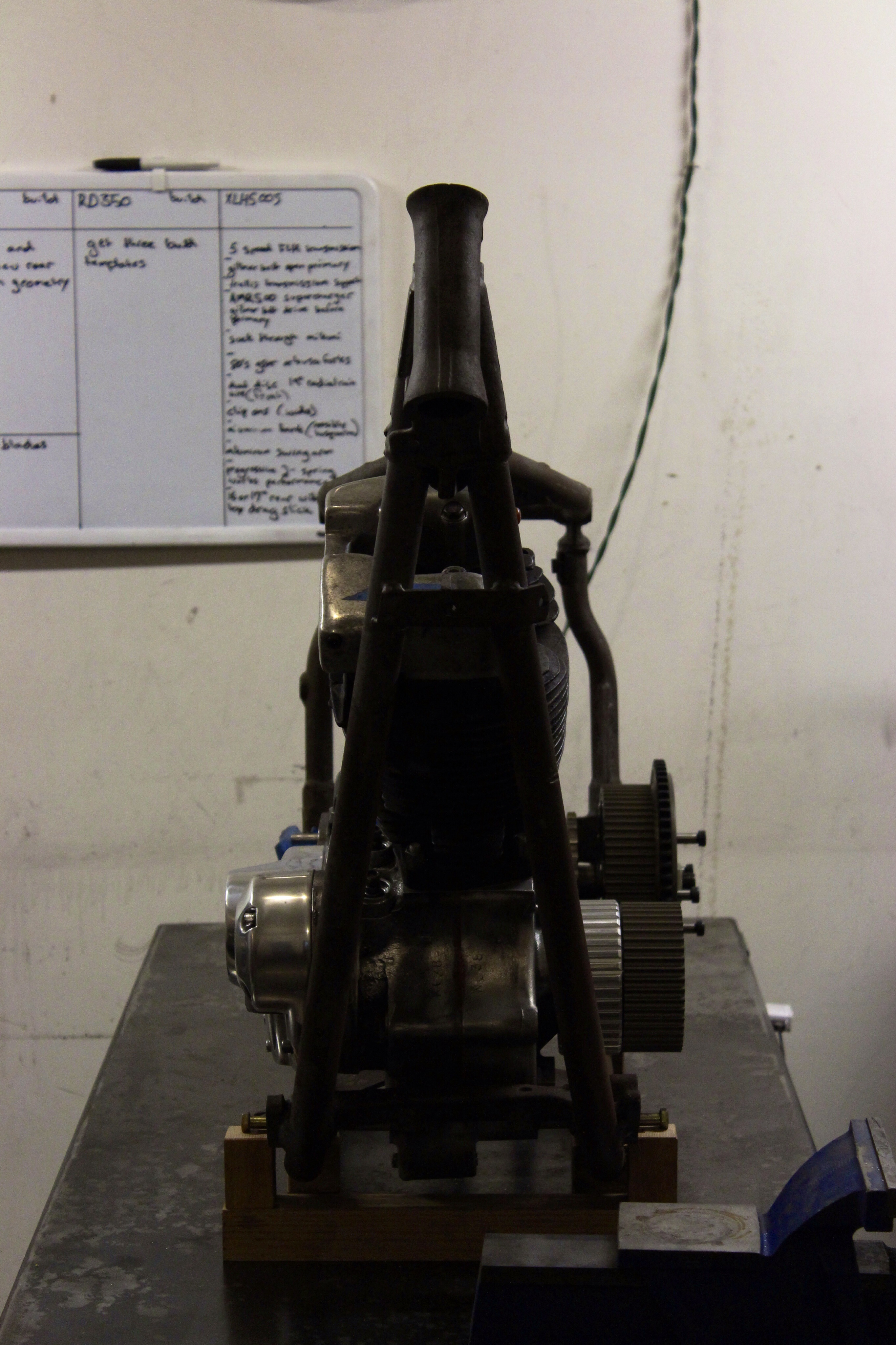

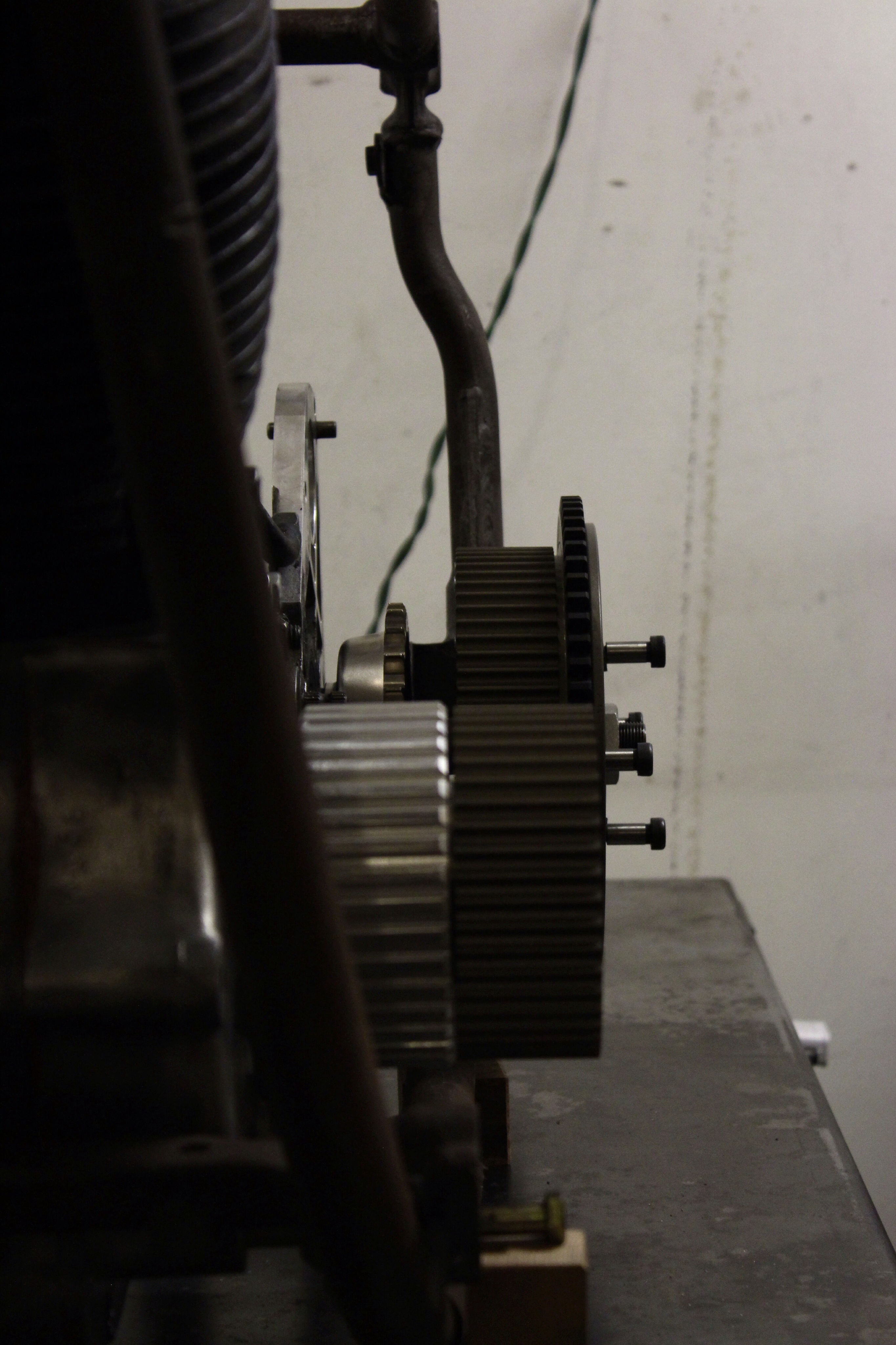

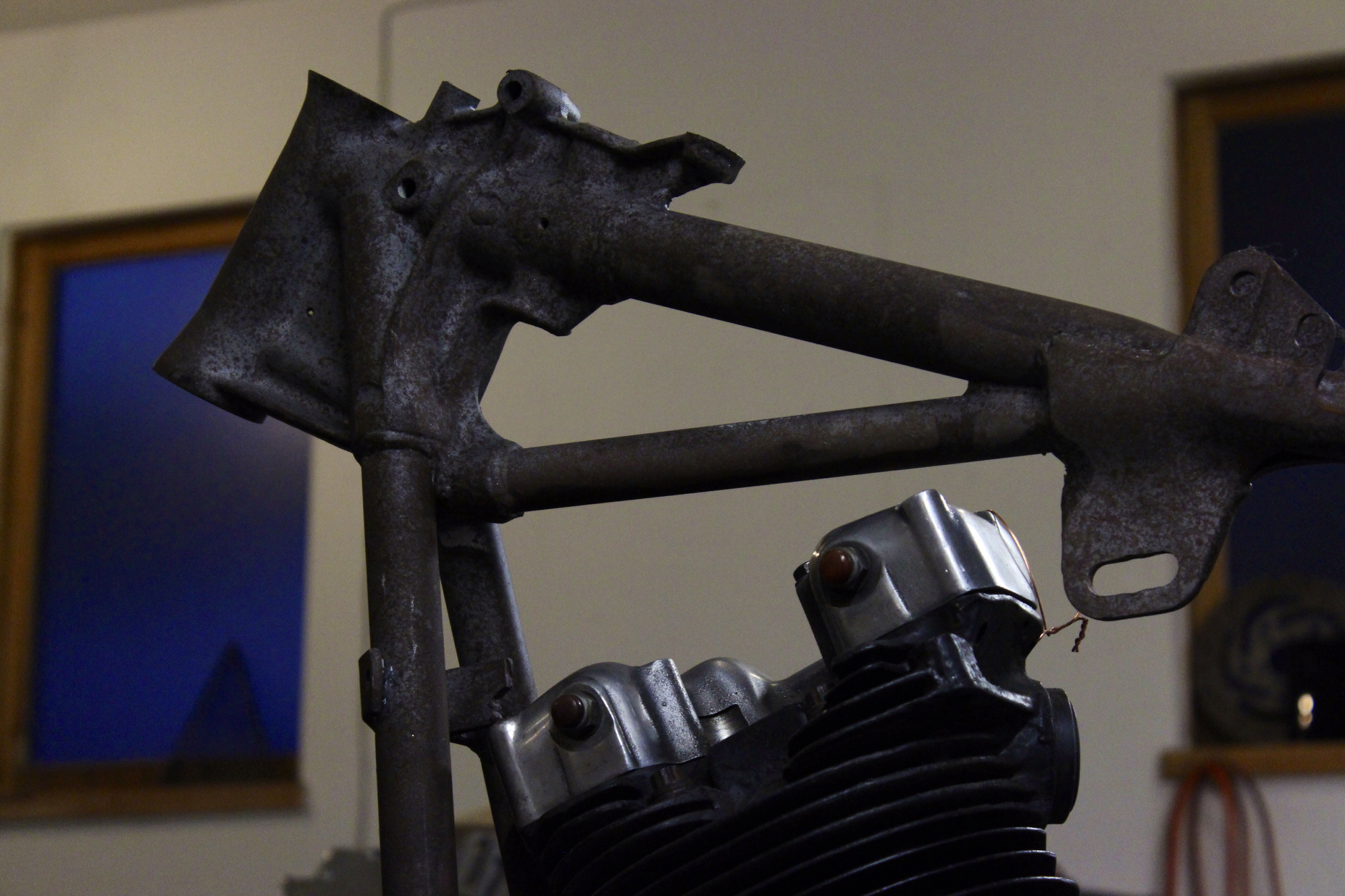

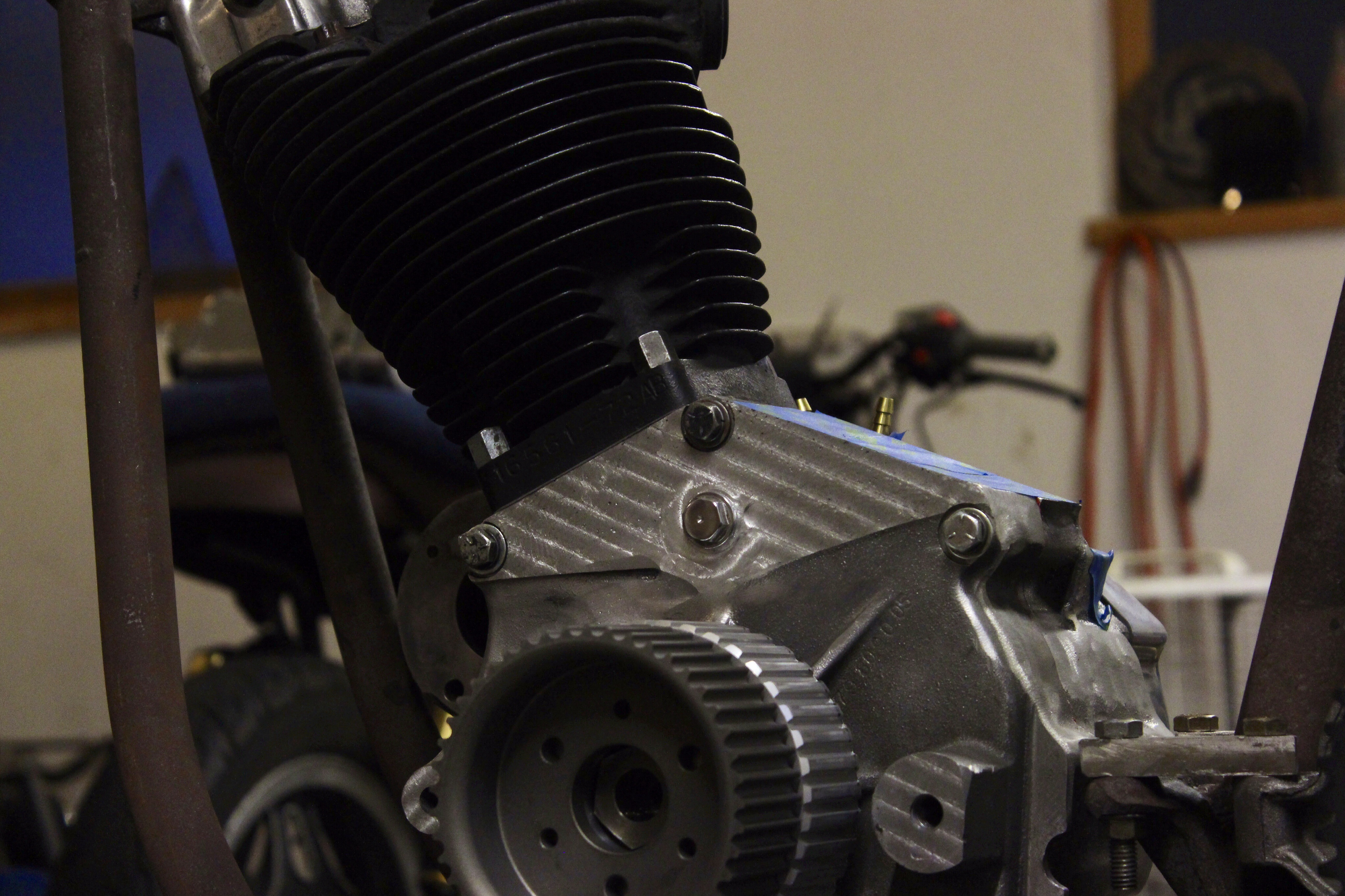

Here is everything mocked up into a shovel head frame

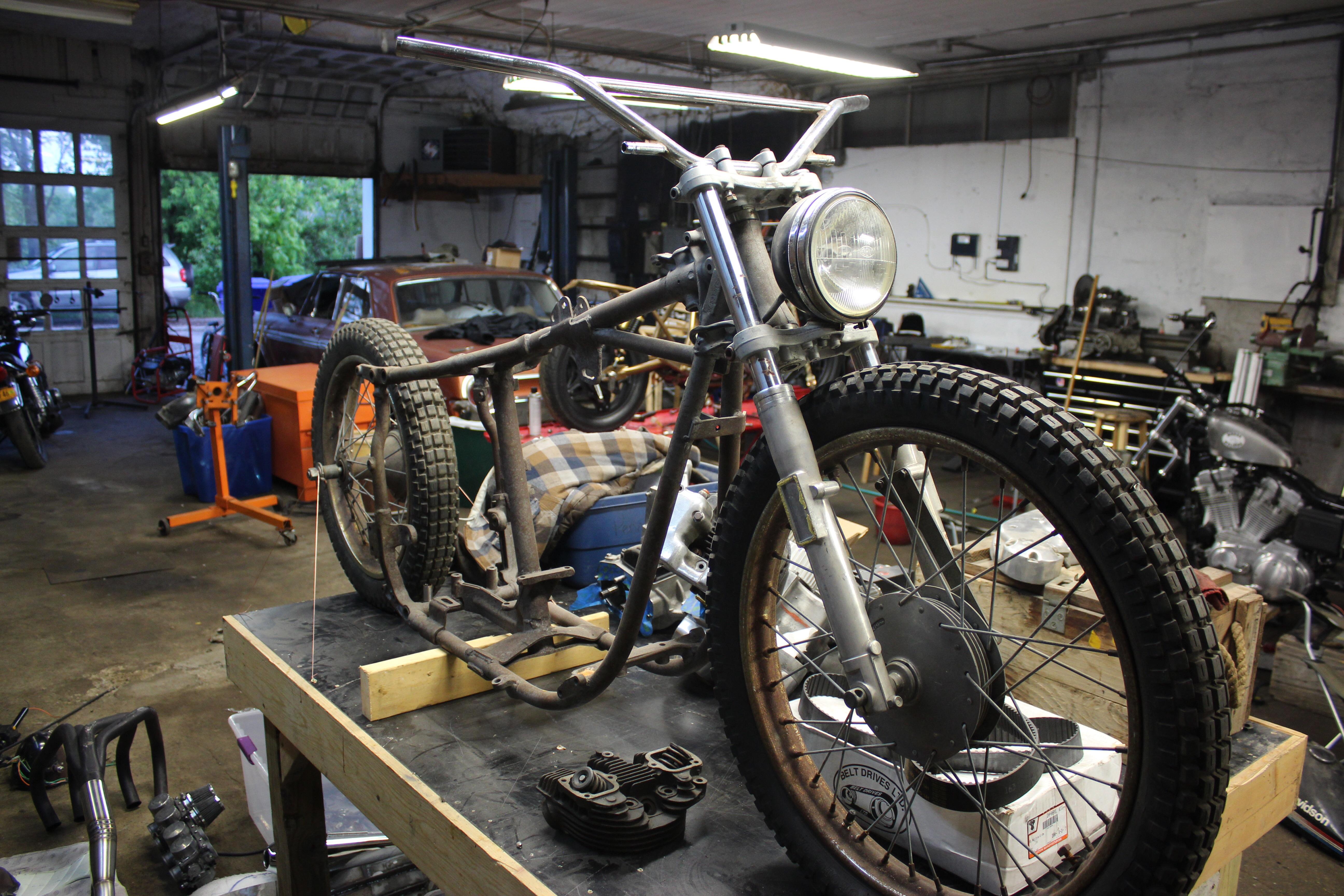

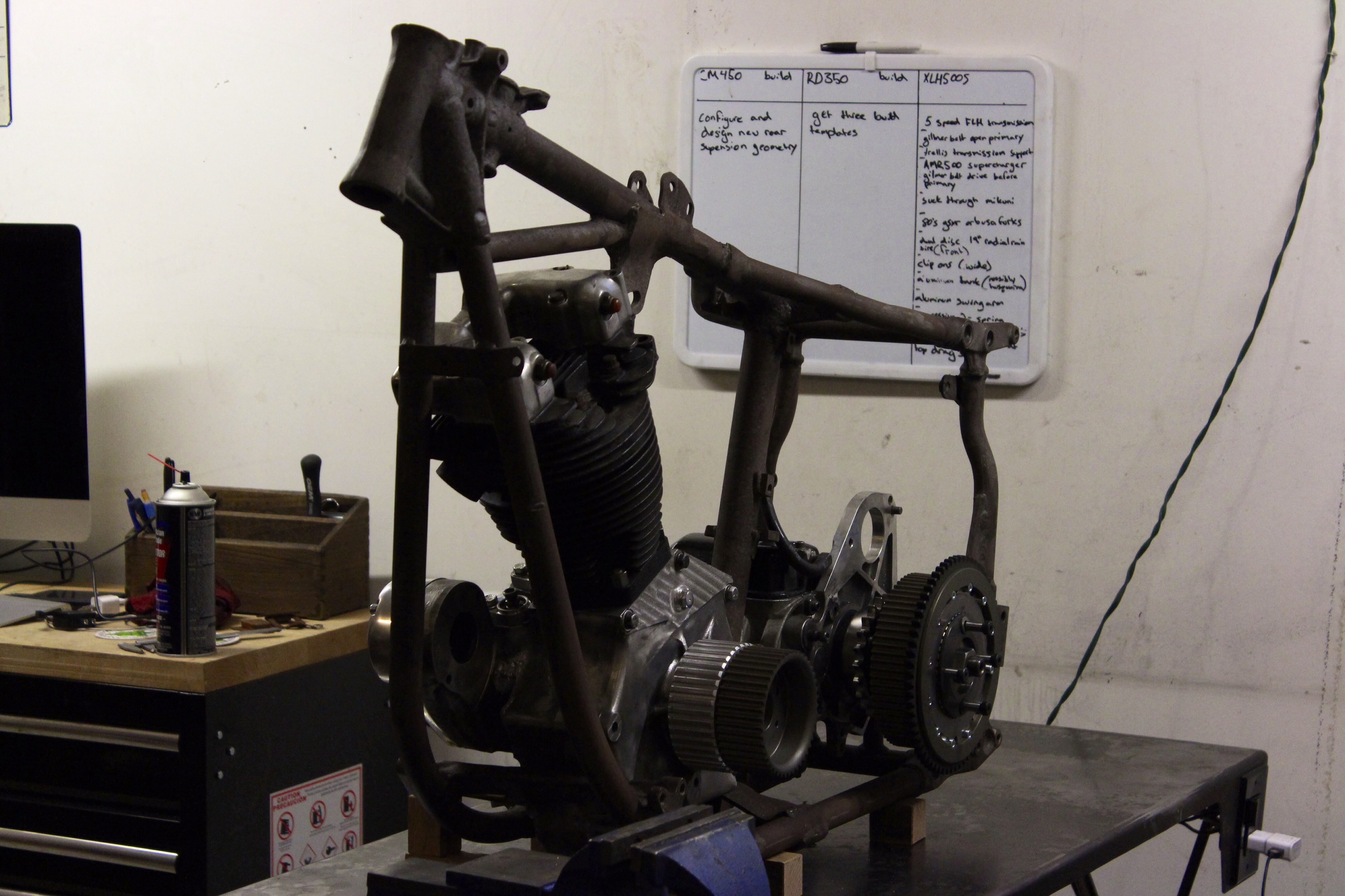

Sorry for the lack of posts. life took a turn for crazy and I had to put this project on the shelf. However I recently pulled everything from the depths of storage and tossed it all on a table to start tossing ideas around.

cool man ..that 30mm front fork lashup wont fly for a 500 though. they were inadequite on the 175 they came off of
