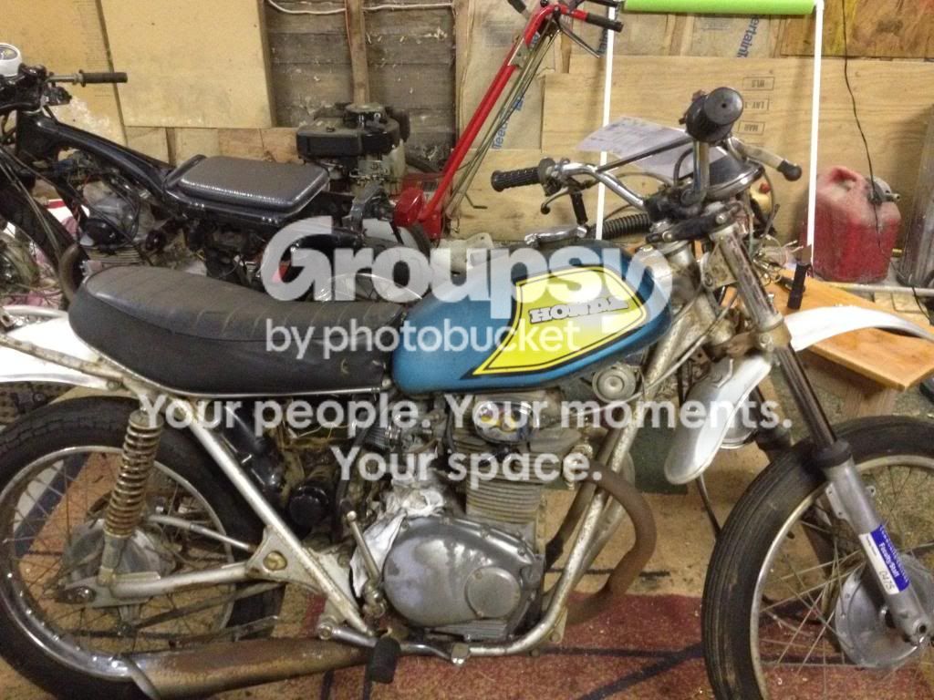

But here is a pic of my yamaha the SL and my brothers 78 CB550

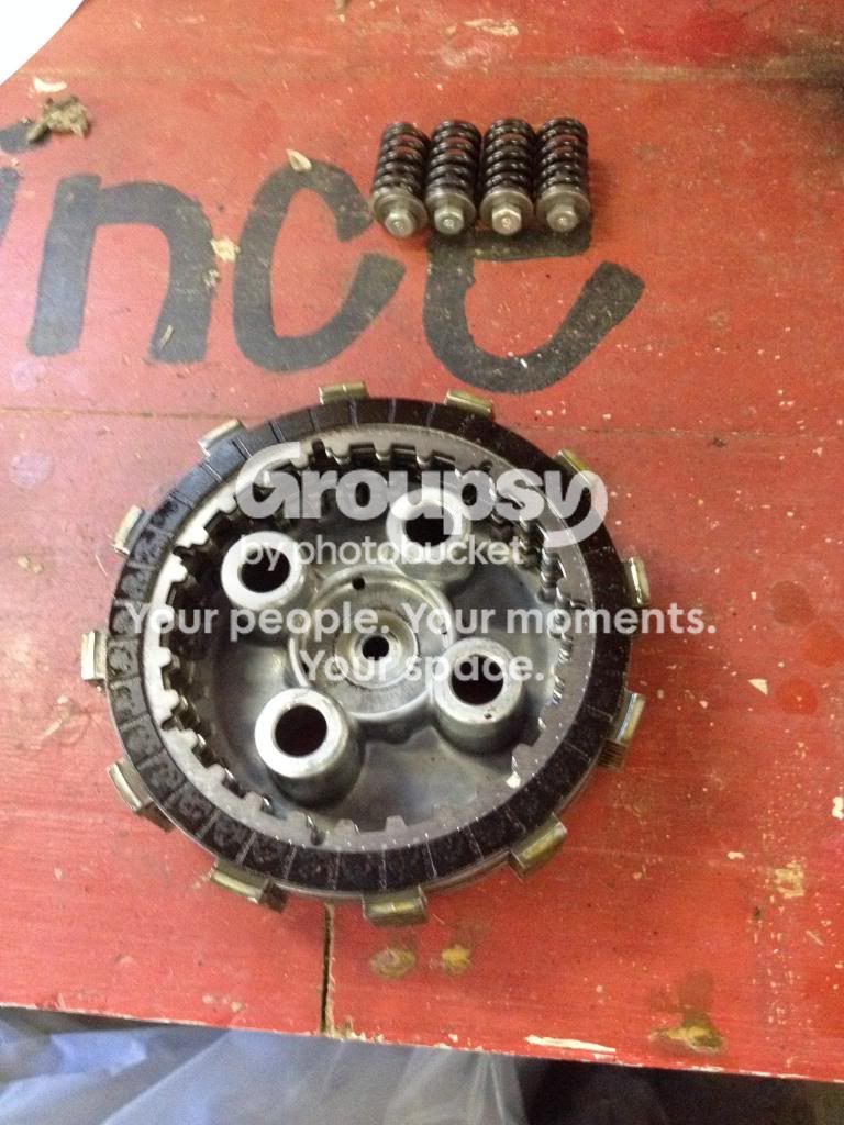

So today off came the side cover and I tore into the clutch! I was going to pull all of the plates out and sand them, then oil them before putting it all back together with some fresh oil in the motor.
Started by draining the old oil and pulling off the right side cover. I was afraid that I was going to have a hard time getting the screws broke, I thought I might strip them all but instead they were all very easy to get off. And to my surprise the motor was very clean on the inside. No sludge or gunk of any kind, but the bike only did 4000 miles so may have even be the stock oil from the factory.
I got all the plates out and then went through them by hand to inspect them. None of them were stuck very bad nothing I thought that should have kept the motor from braking loose. But I think that all of them being a little stuck kept the whole thing from working. There was a little rust but not much. I took all of the disc and sanded them then let all of the soak in oil for 5 hours or so while I ran and did some other things and got some 10w40 for the bike.
Tonight even though it was freezing cold I got the bike back together. The clutch cable was a little tricky to get right i still don't think I understand how to set it up right and the cable could use some oil. Before starting the bike I tried rolling it back and forth in gear with the clutch pulled. It didn't want to at first but after a little i got the back tire spinning. I wouldn't call it "free" but it does move. So I started the bike up and let it get some heat in it and let the oil start to move around. After a little I pulled the clutch and dropped it into first. I could feel it pull a little but it was free and the bike kept running and everything seemed to work. So from there I worked the clutch a little. Letting the clutch out till it caught and let it roll back. Then I held the bike back and just let the clutch slip for a while. Once I did this I cut the bike off and tried to move it back and forth in gear with the clutch pulled in. It was rolling easier but not perfect. So I think im getting there. Ill have to get the brakes working well and go for a ride and get the clutch free and working well. But that for another day!

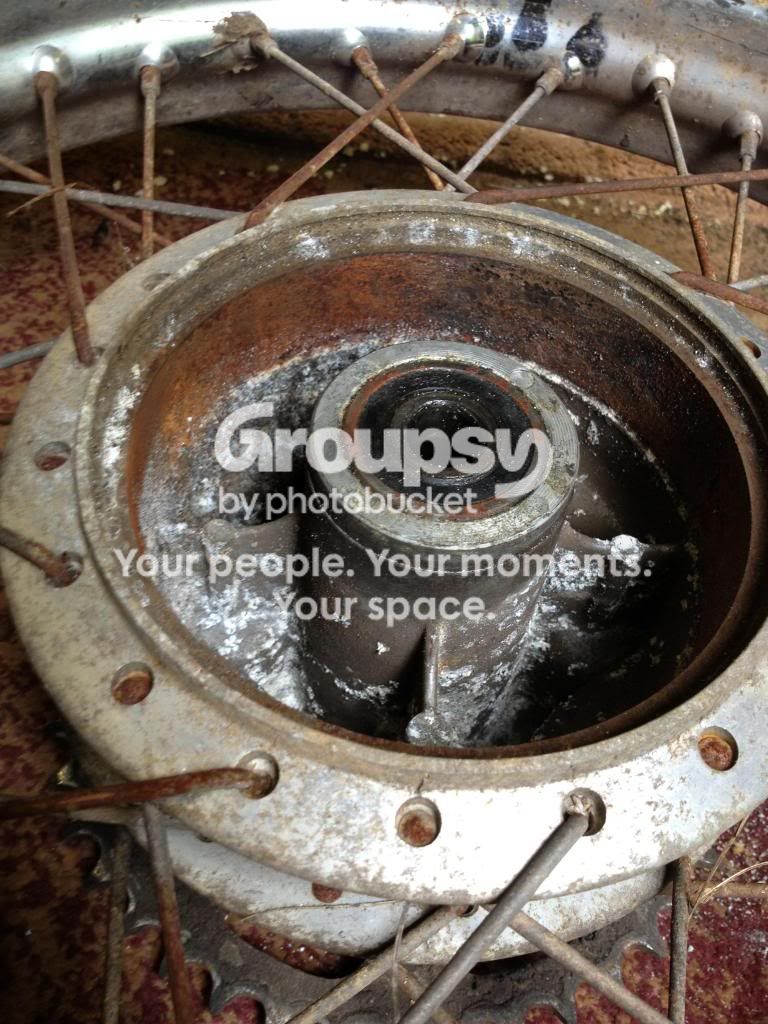

Got the bike even further today! Last night to rode it down the drive way. But I didn't have any brakes to speak of. Well the rear brake pads fell off then I took the rear wheel off the bike, but the fronts had not been touched. They worked but it was more of a touch them and the front end would lock up. But its nice that are driveway is just a hill so ridding up was easy and didn't even need the brakes. But when I did use the brakes they would lock up and not return. So I pulled of the cable and got to work. It was very stiff at first but after working it for 15 min with some chain lube i got it free and moving very easily! So got it back on the bike and the brake was returning fine.
Then today it was off wit the front wheel. The wheel came off easily and the brakes came apart with no fuss. The front hub looked 100% better than the rear. It must have stayed dryer than the rear hub when the bike was stored. So I cleaned everything that I could then took some 120 grit sand paper and scuffed everything up. After I was happy that I got the glaze off everything I got everything back together. Then I rolled the bike back down the driveway to test the brake. And it worked grate. A little softer than I was expecting but im used to disc brakes witch may be a little different. So from there i started the bike and did a short ride around. The bake ran grate and shifted grate as well. It seems like the bike is closer to being back on he road than i thought. Most of the issues with the bike are ascetic and the bike seems to be solid.

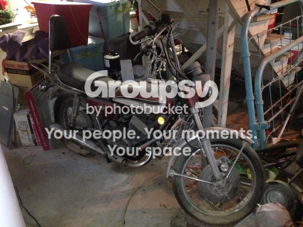

Also I might be going to look at a 1973 RD350 soon. The bike has 10,000K on it and looks to be in grate shape but sitting for a while. Don't know a lot about 2 strokes but I know ill have to rebuild that bike. But I have to finish this one up first.

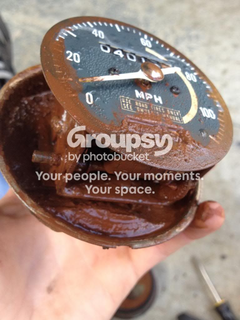

Well got a little done over the past few days, but not a whole lot. I decided to pull off the spedo today and see if I can salvage it...
The spedo spins when I move the bike around but it stays at the MPH that it was last on. So if i roll the bike forward it goes to 100 and stays. So Thought id pull it all apart and see what I can do. I don't think ill be able to fix it but it was worth trying to working on it and see about saving me another $50. So I tried prying off the ring that goes around the outside and after 20 min I decided to just gut it off! Really don't think ill be able to use it so whats the point in being careful. So after I did this a bunch of rusty water came out of the housing.
After taking a look inside I decided I was just going to wash out the sludge in the sink... So I did and got a lot of it clean. Then took it back outside and sprayed down all the gears with chain lube to keep it from flash rusting and to try and free it up. After fiddling with it for a bit I figured out how it worked (for the most part) There is a wheel on the inside that is turned with the cable and in turn the front wheel. There is another wheel that is inside of the out side wheel that slips by, and this slipping is the key to the whole thing. So I lubed it up and worked it with my hand until the needle would fall back down to 0 MPH when I was not spinning the wheels. So from there I hooked the cable back on and turned it with my drill. When I did the needle spun and fell when I let off. But with my drill it easily hit over 100 MPH so I knew that it was not slipping enough. So I put it back on the bike and shore enough when i rolled the bike forward it would read around 20 MPH. So Any help with this would be grate!!
I do have another spedo from my XS400 that is the same style and size ill have to see if it would work on the SL. The one for the XS has a broken face but I can glue it back together.
