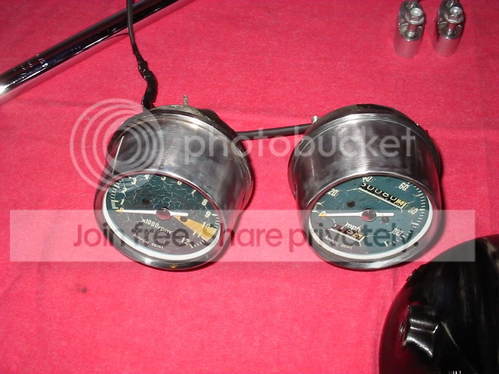

which tach/speedo is that?
i believe that they are just stock clocks that were just painted over. i'll take a closer pic, so you guys can tell me better.

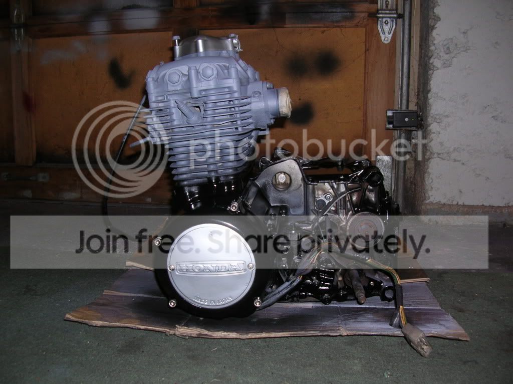

it's been awhile since i posted up here... got a good amount done on cafe steel resevre... seat is painted waiting for racing number and clearcoat. engine is getting the spary treatment as we speak.i started installing some of the stainless screws from the kit and they really pop out from the black case. i install steering taper bearing ( what a pita -lol) but seems like a once you do it thing next time is better.. save the old balls for mock up!!! very important guys.. not sure what to do for rear sets just yet but sure have alot of stuff ready to go back on the 211 scoot! here are some pics
should i paint the head fins silver then black on top or paint silver all the way up.. i can't make up my mind..
Re: slapi's 72 cb350/400
was able to get the engine in the frame with the help of the old lady. polished the upper forks and dropped them in also. i am happy cause it's starting to look like a bike again.
