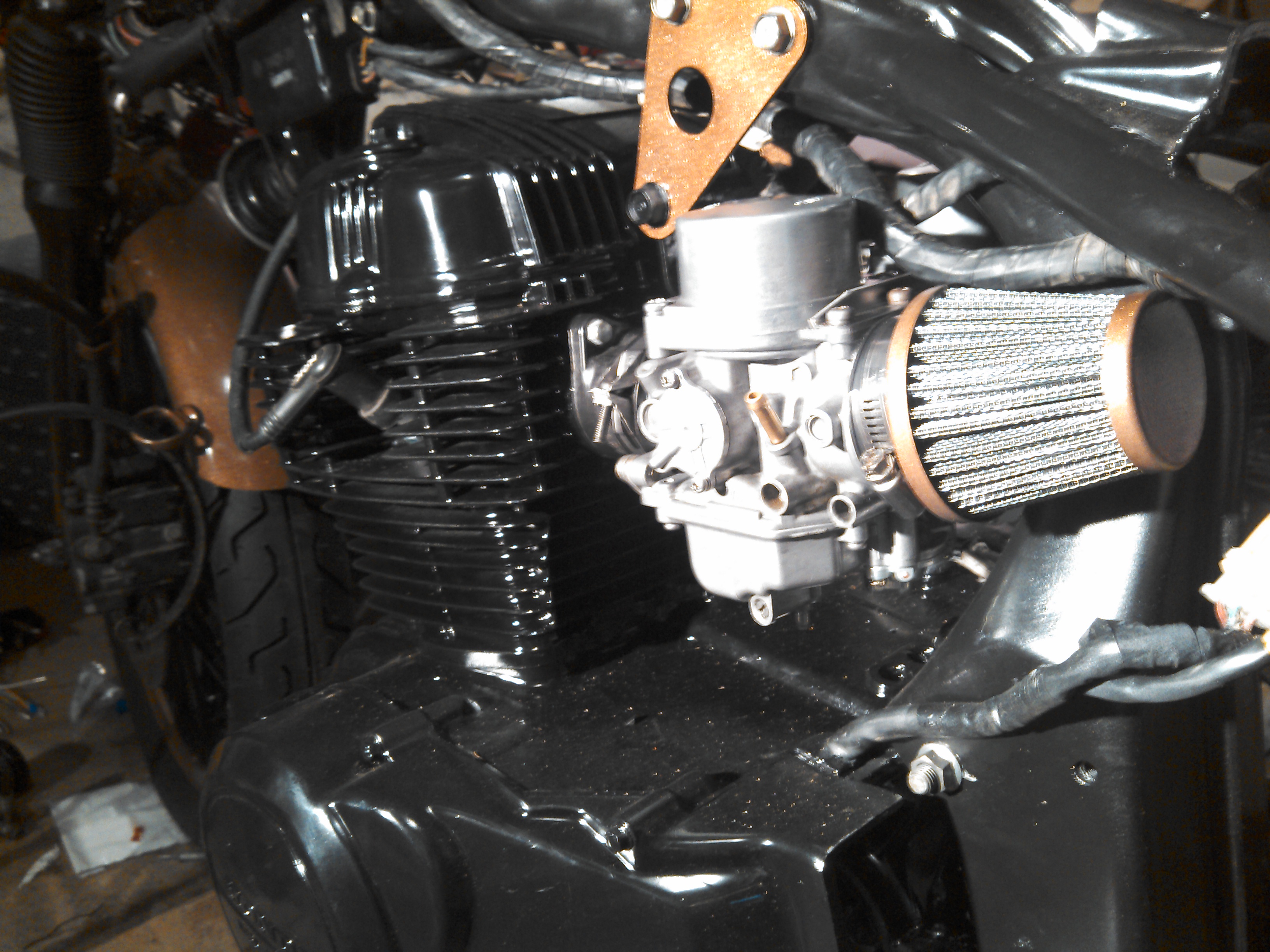

***NEED HELP***
I have an 81 CM400C and for the life of me I can't figure out the springs for the choke linkage and sync. If possible can anyone upload some pictures of theirs for me? I have searched for a week looking for a good picture and can't find any. It is much appreciated!
Johnny
Well, I finally figured it all out, don't need the pics anymore! Whoo hooo!
