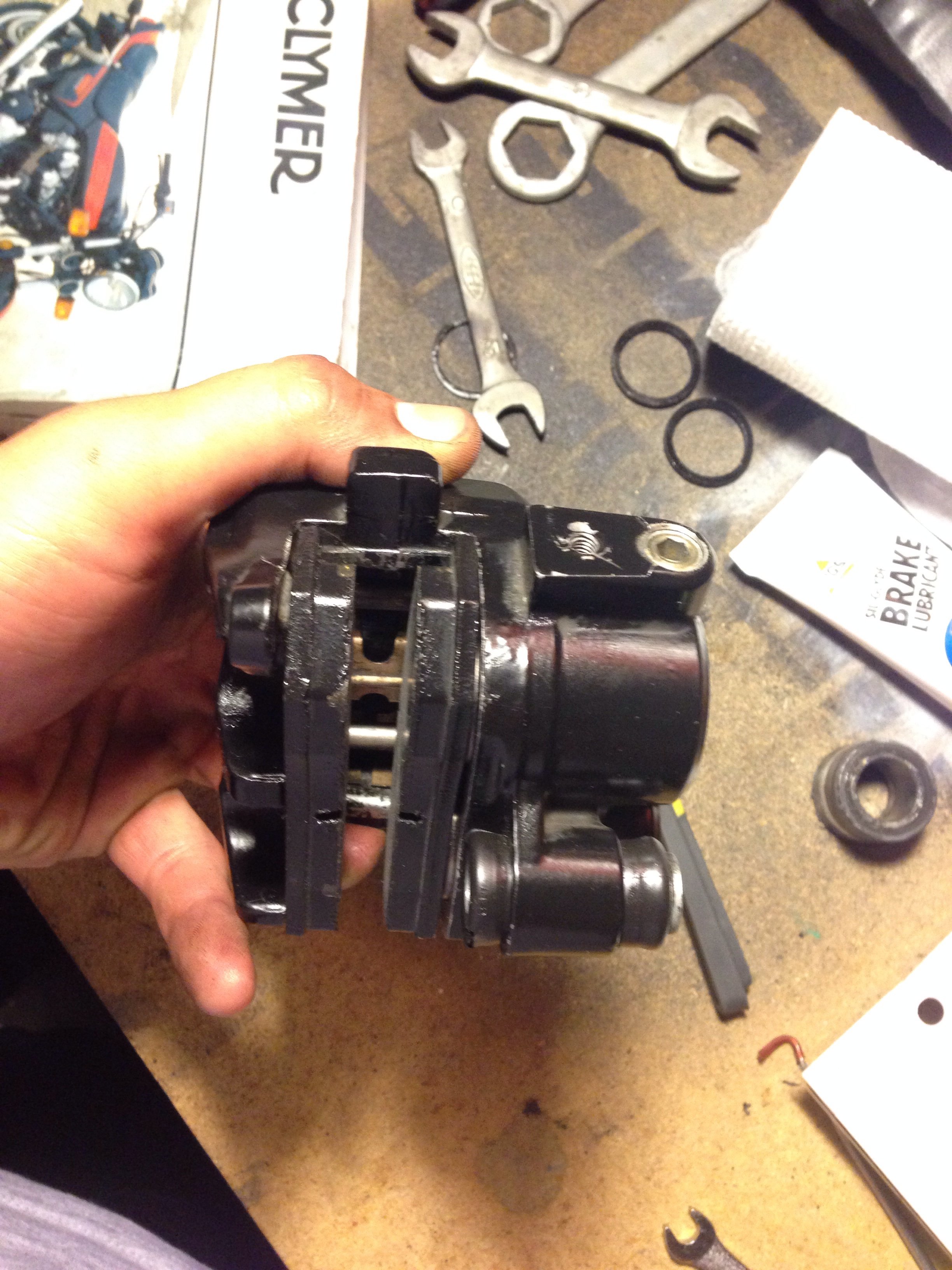

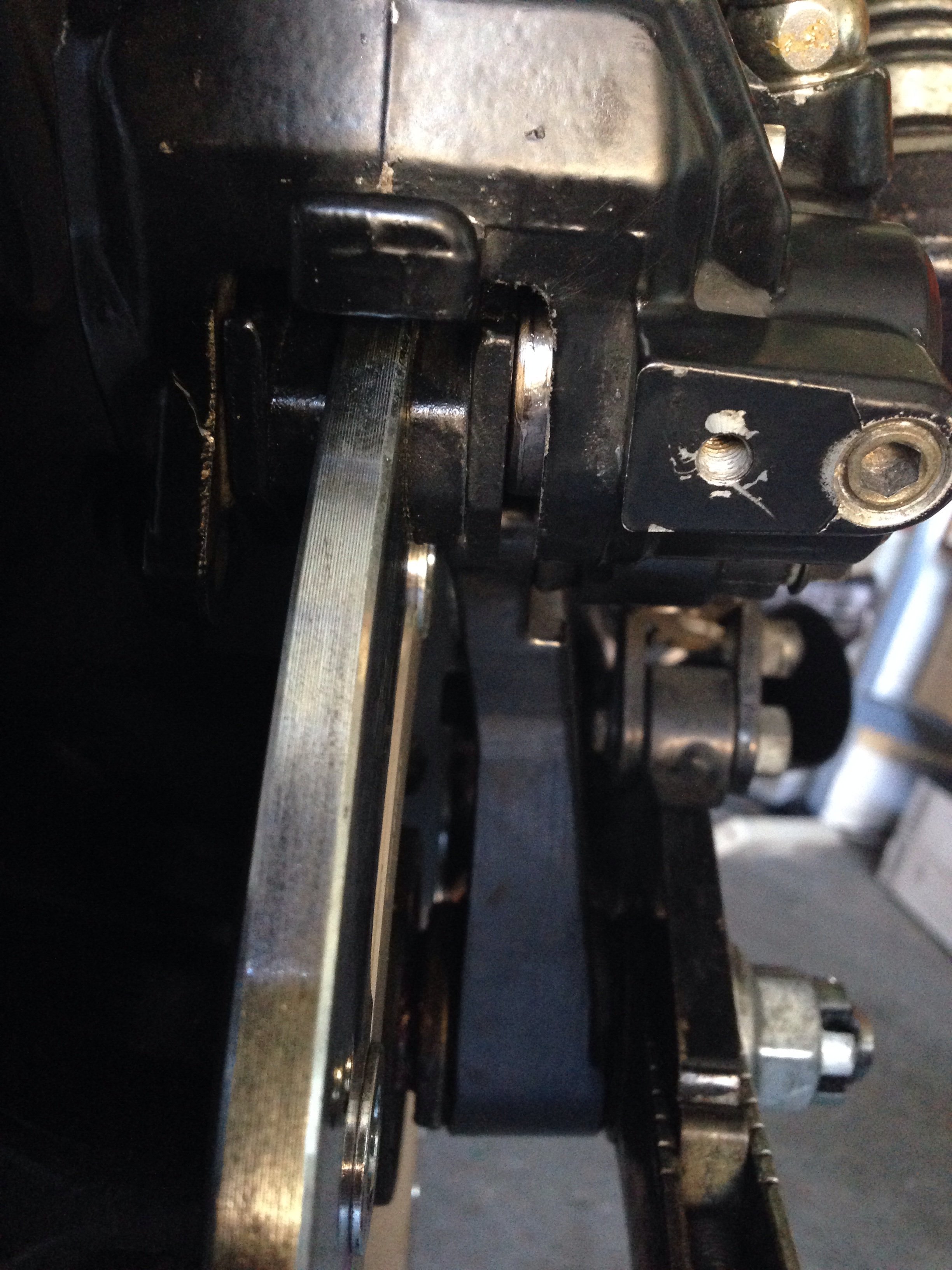

So my rear brake caliper was seized and wouldn't move at all, so I took it off, cleaned end it, rebuilt with new seals and cleaned the pistons, lubricated it, slid back in fine, put new pads with a new disc, bled the whole system. I noticed obviously there's a small space for the pads to get pushed into the new disc, but why wouldn't it retract? I haven't gotten a chance to move the bike does that have anything to do with it because it's not moving? I just need to finish this and this is the last thing I need to do to ATLEAST bop around town. Any help or suggestions would be greatly appreciated!

Are you saying the pads are locking on to the disc? They need to bed in to the disc as the disc will have some wear / grooves in it.
While it's largely a mystery to me, I don't think the pads/calipers are going to retract much without the caliper being on the bike pressing on the disc. Loose in your hand its not going to retract much if at all.
That's the thing it's on the bike and I put everything back on and bled it and it pressed against the disc but
It isn't
Retracting I'm at a loss
The caliper is supposed to move sideways (IE: in and out along the same plane as the wheel axle) so that the disc can move freely between the pads.

Another possibility is you have the axles spacers in wrong and the caliper is not centered over the disc.
the pistons in use retract so little you almost cant see it and it should happen on the bench it is only the flex in the square crossection oring that pulls the piston back and of coarse any disc wobble
is it bled properly ?
did you use the old squre oring seals ? what did you clean them with ? you cant use anything but brake cleaner and brake fluid on the seal

So it was centered and it sat fine before I bled, then I bled it and obviously the pistons moved but now they're against the disc, is this because it's not
Moving and has nothing to bounce off against? I cleaned with brake fluid and brand new rings and stuff I'm confused as to why it's doing this !

Does your wheel still spin when you aren't engaging the brakes? I think that you think you are going to see space between the pad and the disc at rest. This is not the case. Unless your wheel is locking up, it's fine.
Theres nothing to make the pad "retract" as you are describing. It simply stops putting pressure on the disc when you release the master. You couldnt slip a piece of paper through the two surfaces at rest. If there was a gap at rest, braking would be delayed and sudden. No bueno.
^^^ yep dicks breaks are in contact continuously, only reason drums pull away is because they have a return spring and require manual adjustment unless a car and those self adjust every time you brake in reverse... if you can spin it at all go ride it and don't smoke the brakes until you bed them.
