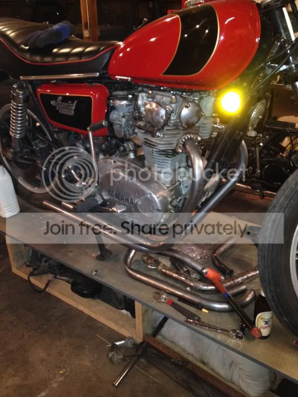

Decided to try my hand at an exhaust system from scratch.
Went 2 into 1
Fabbed up a 2-1 collector:
2" outlet
Next up I'm going to make a reverse megaphone for it.
Thanks man, ill either powder coat it or wrap it haven't decided which yet
Nice tig work on the exhaust. Looks good.
