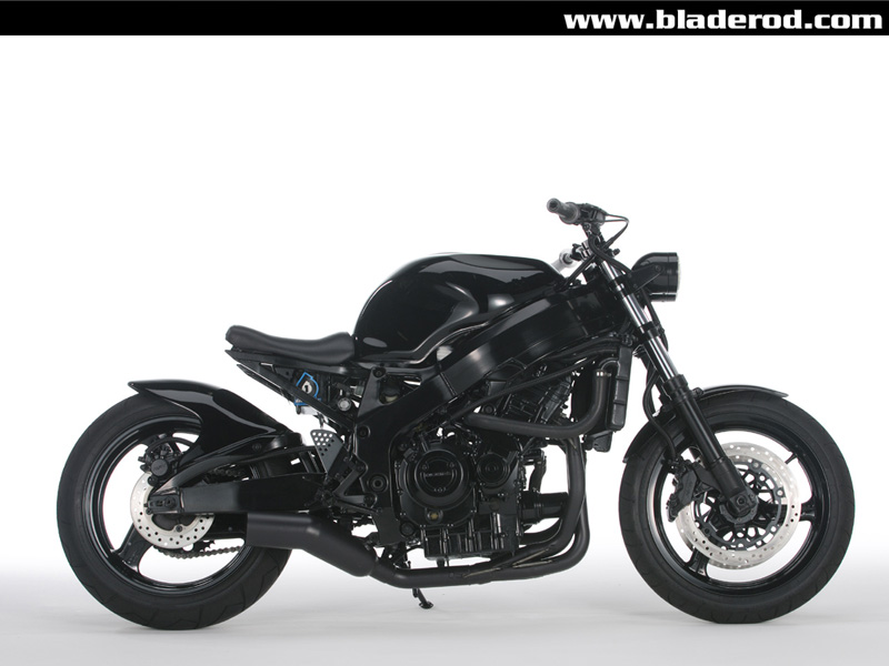

awesome stuff if it helps a mate of mines husband did a similar looking one to the inspiration shot you posted.
http://www.bladerod.com/

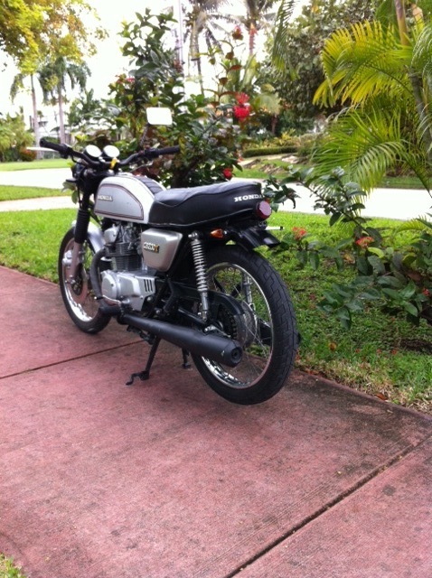

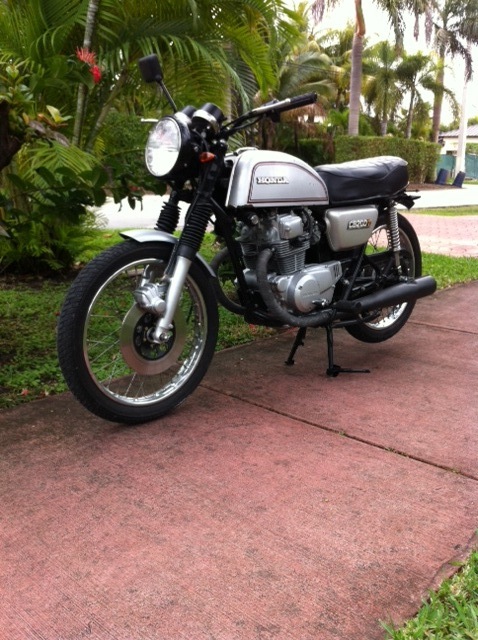

Back from the dead!!! So I took about a year off from this project to restore a CB200 for someone in the family. Now that the CB is done and winter is finally over I have been getting back into the katana project. I have finished all the misc fab work for the tail light, under tail panel, and electronics. The bike is again a pile of parts ready for paint. Haven't been taking many pictures, but will get some up once the bike starts to take shape in the next few months.
The CB200 I restored in its new home in Miami Beach!!
