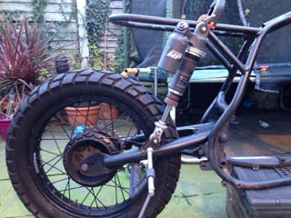

Lash up number 2 with pictures this time
With this set up I have 7' of travel as suspected and the rear wheel hits the seat rail before pulling into the bumper full on
Here it is with the spring on for reference
The ride height is 33' which feels right for my height and looks about the same as the original sp370 stance
Let rip on the feedback
