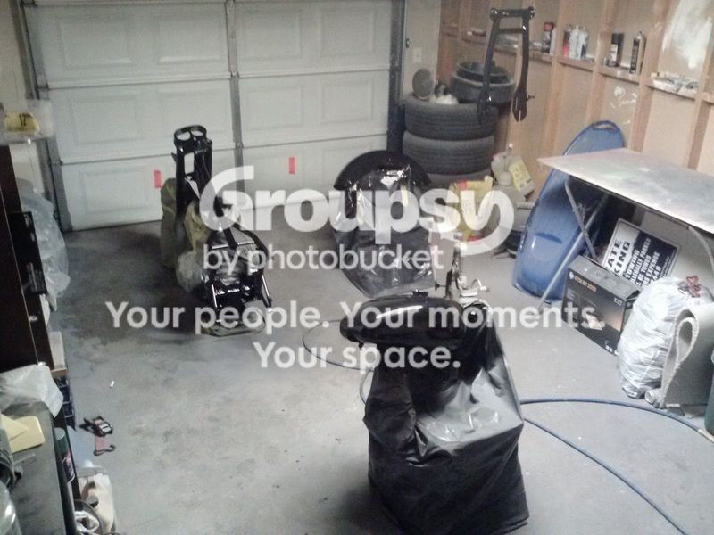

This is my 1958 Enfield Indian Trailblazer. The bike sat for 25+ years when I found it in a barn. When I got it, I wasn't even working at a body shop at the time. This was restored in my 20' garage, at my apartment complex, NO ventilation, in the middle of the winter. I'm not saying I'm a better person than anyone else, I'm just saying that when you have the will and desire to accomplish something, it can be done. Oh, did I forget to mention I did this paint job with cheap POS Harbor Freight paint guns? Still don't believe me? Look at this:
As you can see, no windows. I opened and closed the garage door to circulate the fresh air while it was snowing outside. Seems insane, but everyone I showed it to thought I spent thousands of dollars on it. So how much DID I spend on this paint job? About $350, and that includes the new paint guns from HF. Yes, I only used those paint guns a few times before replacing them with MAC, DeVillbis and Finex guns. But it doesn't change the fact that I did a "Thousand Dollar Paint Job" with bare minimum everything.

The problem with your photo is that EVERYTHING in your garage now has an unremovable layer of paint dust on it, for generations to come. ;)

All the important stuff was in the front of the garage under masking plastic. The only stuff that got over spray was junk. ;)
